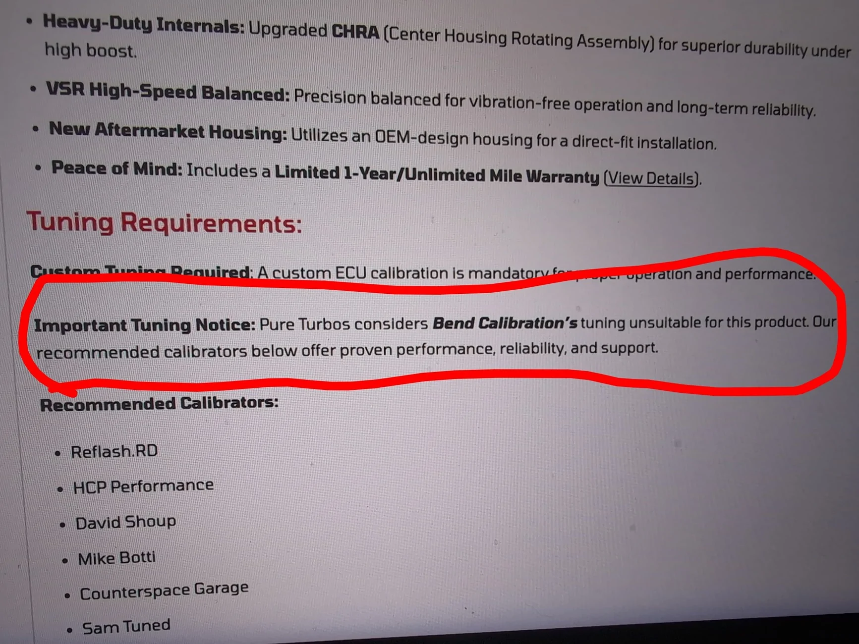

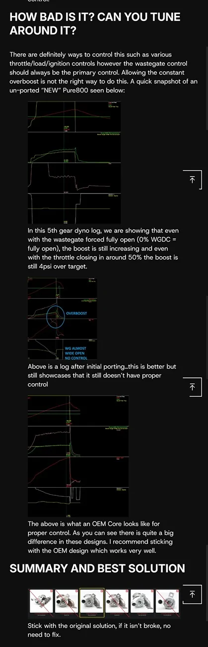

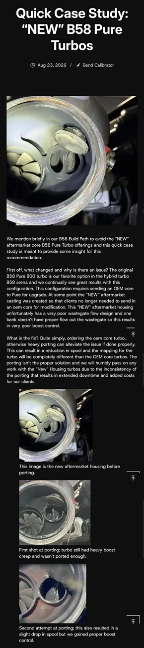

It was definitely up when he posted it because I read it. I'm also getting a 404 now and it seems like they took down their entire /blog part of the website. It had logs showing some issues and showed initial porting efforts which helped but didn't resolve it until they ported it a butt ton and fixed the issue. They basically said don't buy the cast turbos and they weren't going to work on customer cars with Pure's cast turbos because it was too much of a headache. Still live on Pure's site are a few products that say they don't recommend Bend Calibration so they seem to have some beef with each other.

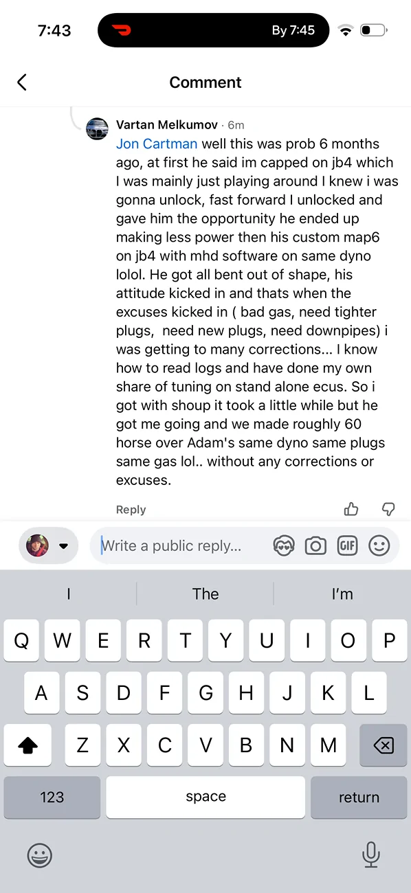

watch out having Adam touch your vehicle I’m not the only one he couldn’t figure out and got pissy with.
8,762
17,190
You have to give this a rest man, I know you keep posting this desperately in hopes you get the reaction you want but you need to just move on.
