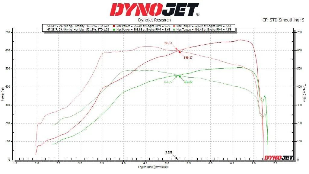

I have tracked with the pure 900 on pump and E mix with race fuel , the car does not feel laggy but you feel the boost more when it kicks in and when it does it keeps pulling so takes a bit getting used to and as for power with upgraded injectors as well as upgraded HPFP and LPFP this is what you should be roughly expecting
green = shit Canadian pump gas
Red = shit E50
so you might get a bit more but this is the result
