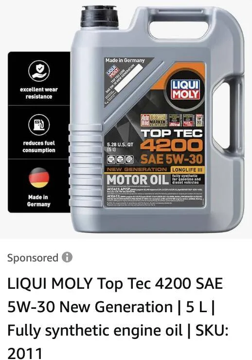

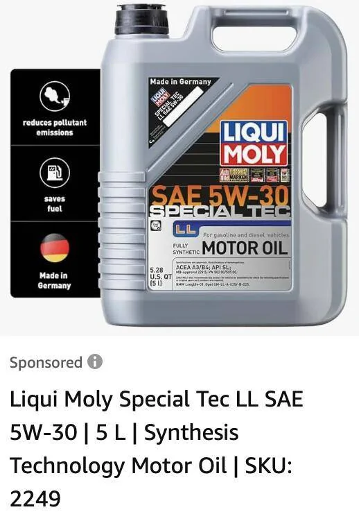

I'm currently using the Liqui Moly Special Tec LL SAE 5W-30 oil. I saw on Amazon that they have The Top Tec 4200 SAE 5W-30.
I'm about to do an oil change, and was wondering what would be best out of the two oils. Also open to other oil suggestions.

With Texas heat, buy a reasonably priced LL01 5w40 or an oil with a HTHS range of 3.5–4.0 cP. The higher the better. If you want the best of the best and price isn't an issue buy HPL euro 5w40.
I read that liqui moly is average at best and overpriced for what you're getting. Not necessarily a bad oil, but why overpay for the "MADE IN GERMANY" logo and all that bullshit marketing? Better off getting a Walmart brand that would perform just as good, but whatever its your money to piss away.

Just use the special tec 5w-30. I used it and so far it feels good.
