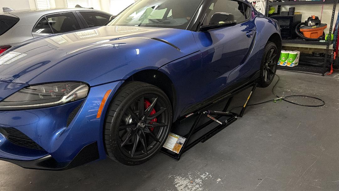

Those with quickjacks, when you lift your supra (or other cars) do you:
Auto Trans:
1) Leave in Park
2) Put in Neutral with wheel chocks
Manual Trans:
1) Leave in gear with Parking Brake on
2) Leave out of gear with Parking Brake on
3) Leave in gear with Parking Brake Off with wheel chocks
4) Leave out of gear with Parking Brake Off with wheel chocks
DC5UPRA
Austin
Dec 7, 2023
281
385
Charlotte
2024 GR Supra MT, 05 Acura RSX Type-S
M/T here:
If doing brake work(typically swapping pads for track/street) leave parking brake off and leave in gear
Everything else set park brake
MidLifeMK5
Douglas
Apr 9, 2026
Illinois
2026 3.0 Premium MT
M/T here:
Left mine in park (auto)
Thanks for the replies. I have manual trans and have been leaving in gear with parking brake on. In the first few inches of travel after contact (up and down), noticed it doing some tire or block drag (which is expected). Wasn't sure if others were letting the tires roll and controlling car movement with wheel chocks or not.

Unsure on fit as it's longer than 6000tl model I have. I would verifiy with a quick call to quickjack customer support. They have been good in my experience.

Neutral with park brake off to prevent transmission/brake loading.
Phil
lucky phil
Phil
Jan 23, 2023
1,545
1,801
Do you use wheel chocks during setup or is your space completely level?
I have a level spot to jack. Set the jacks up and raise until they start to take some load on the suspension then select neutral and park brake off. Manual trans. Reverse the order coming down. Park brake back on before jacks fully release the car.

Do you climb in the driver's seat to activate/deactivate the parking brake? I feel weird getting in the car while its in contact with the lift for fear of shifting the blocks.
Dantist
Jan 20, 2025
Seattle, WA
2024 Toyota Supra 3.0 MT
Yes, routinely while the car is up on the QJ without any issues. As far as your previous question goes, MT and parking brake on.
