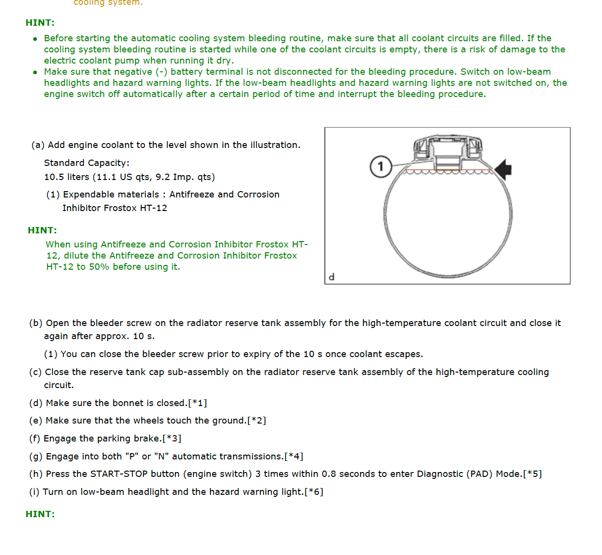

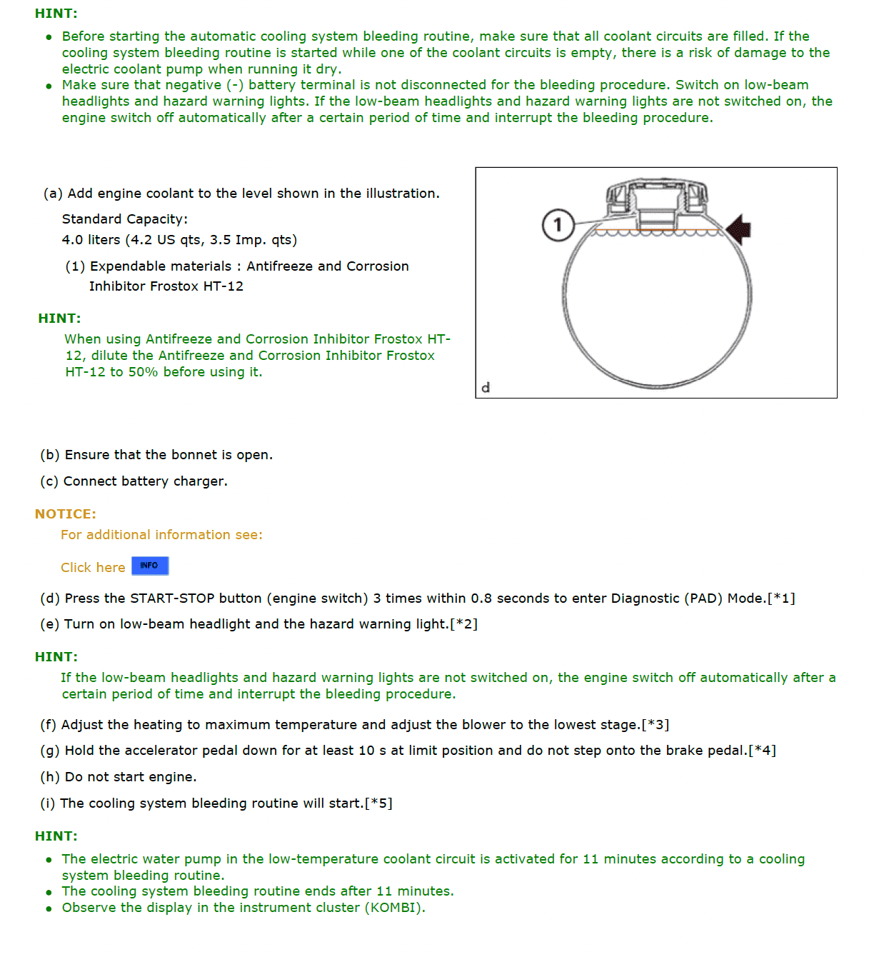

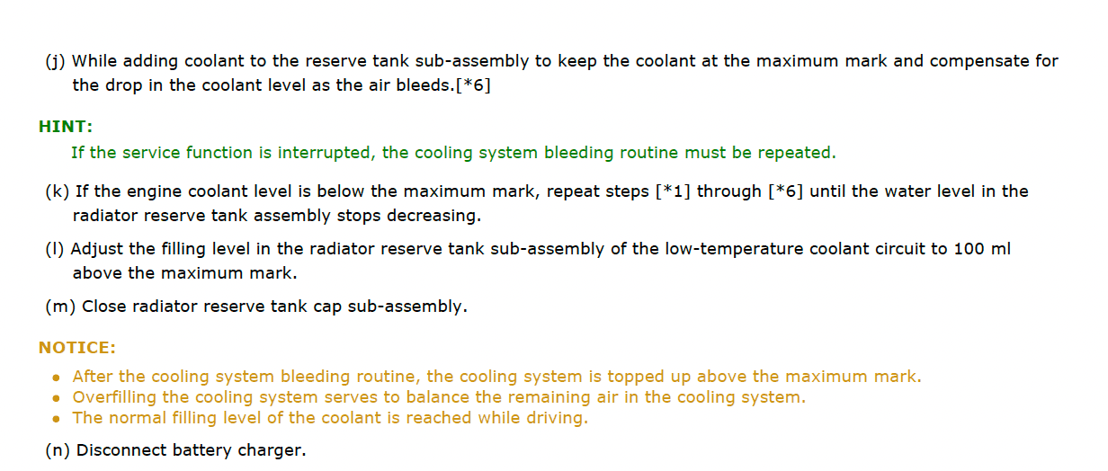

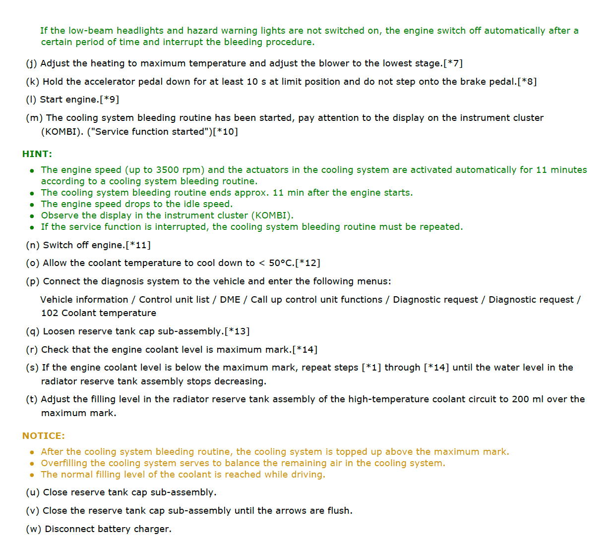

That seems odd that you are hitting 300F in every session in 75F ambient. Especially with stock tune. Do you have logs? Did you do the proper bleeding procedures for both high temp and low temp cooling circuits?

Yeah I should have logs. I was running the RaceCapture this weekend. I don't know about "proper," but I did use a vacuum bleeder for both circuits.

Just to add this is the the same experience for me. I do not have logs but have been watching the readings on the gauges on track and hit within the 280 to 300f mark within 2-3 laps. Starting ambient is around 90f for me. I do not think it is a bleeding thing but thanks for the official procedure. Mine recovers very quickly once you are off full boost. I have no tune/ stock turbo. So if someone does figure out that it is air in the system that would be helpful.
