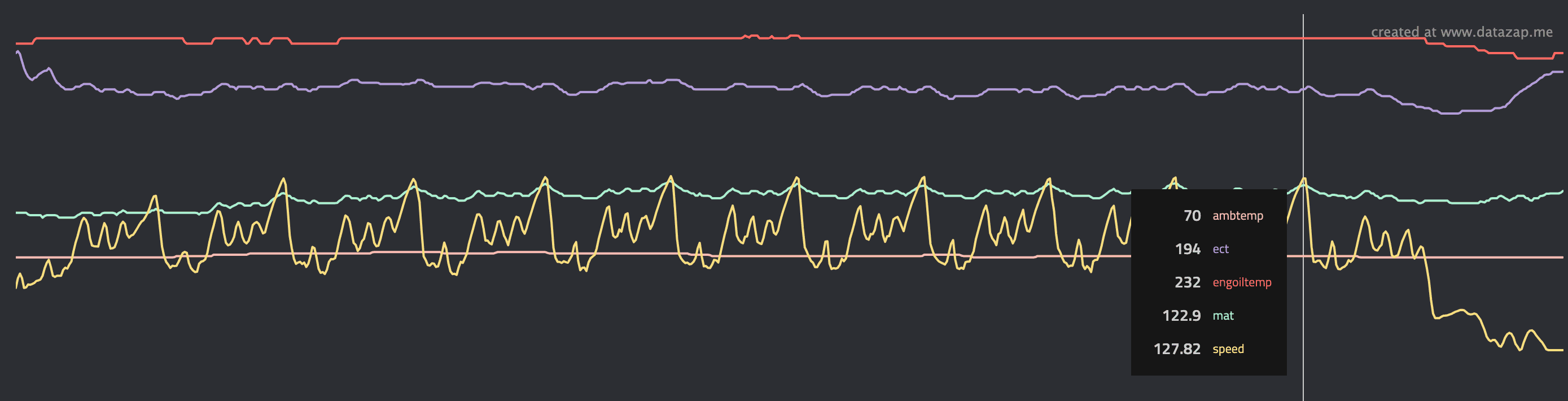

Manifold still working well. I have no IAT,Oil,Coolant issues with 500whp, which is why it's odd that people with totally stock tunes are getting 300F+ oil temps in 75* weather.
8,846
17,342

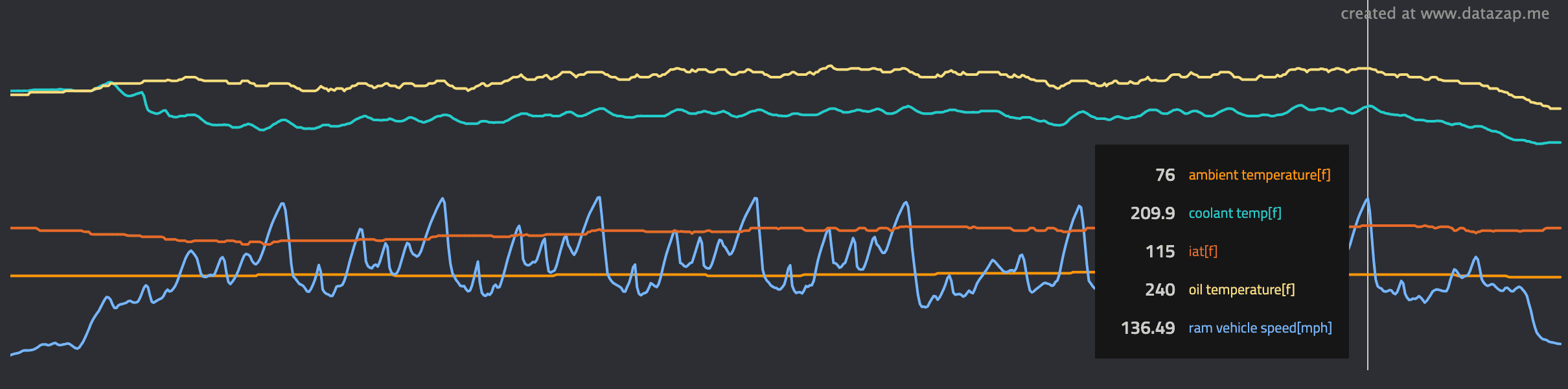

So what, PWR? Stock? Here's a log in the 75F weather.
Yea these seem very high for the weather. Not a very long or high speed track either. Oil and coolant for sure. I would at least try doing the high-temp circuit bleeding procedure.

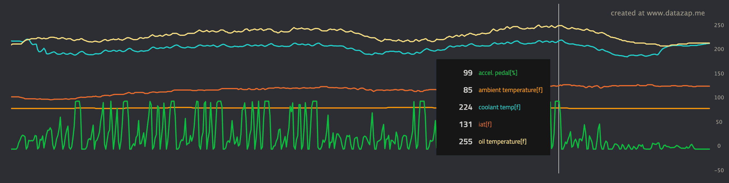

For reference, here is mine 8 laps in at Lime Rock with my 440whp map (22psi max), same ambient temp:

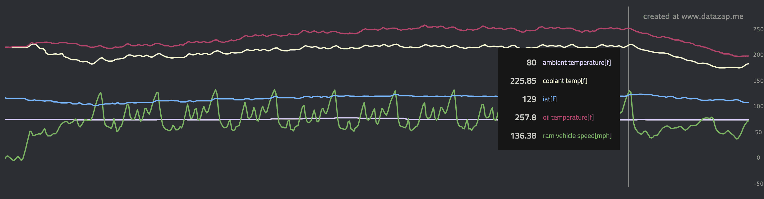

Here is mine 9 laps in at Lime Rock with my 440whp map (22psi max), 85F ambient temp:

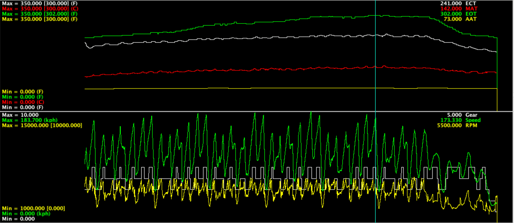

Here is mine 10 laps in at Lime Rock with my 510whp map (27psi max), 80F ambient temp:
I definitely will. I think I'm going to re-do the flushes, I'm almost wondering if I got too much concentrate and not enough distilled water in my mix. Probably throw in some water wetter.

Yup, all stock rads and exchangers, Wagner intake mani, Pure700 turbo, Triple7 GT4 hood vent, E40 tunes.
I didn't do too much logging last year on stock tune, no power mods, no cooling mods, but here is one in 70* ambient later in the year at Lime Rock, 10 laps in:

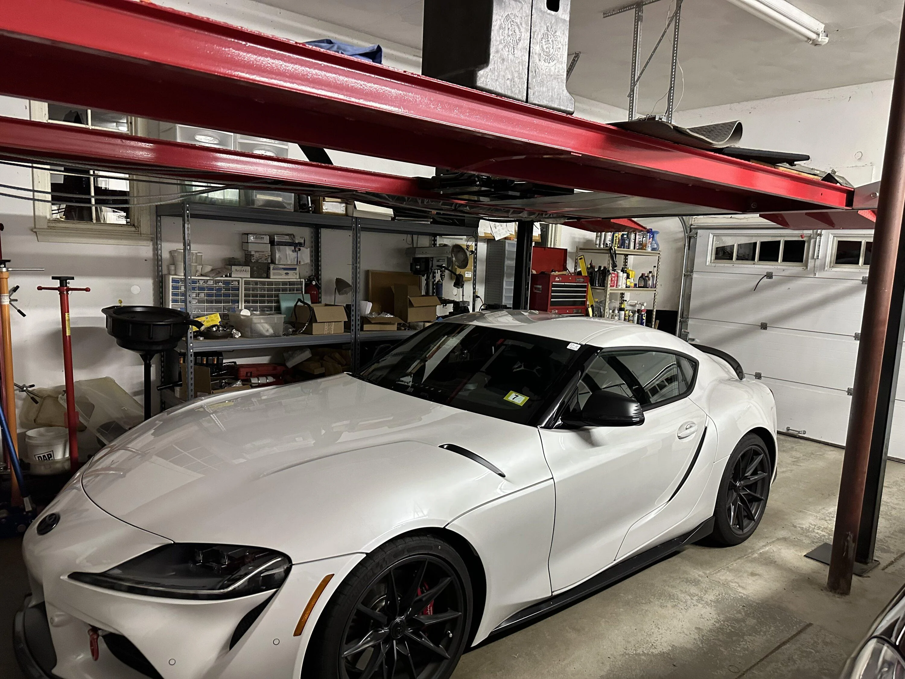

The brand is Autolifters of America. You can see the sliding jack crossing the ramps.
i see.
cool
that is basically a lift on top of a storage lift.

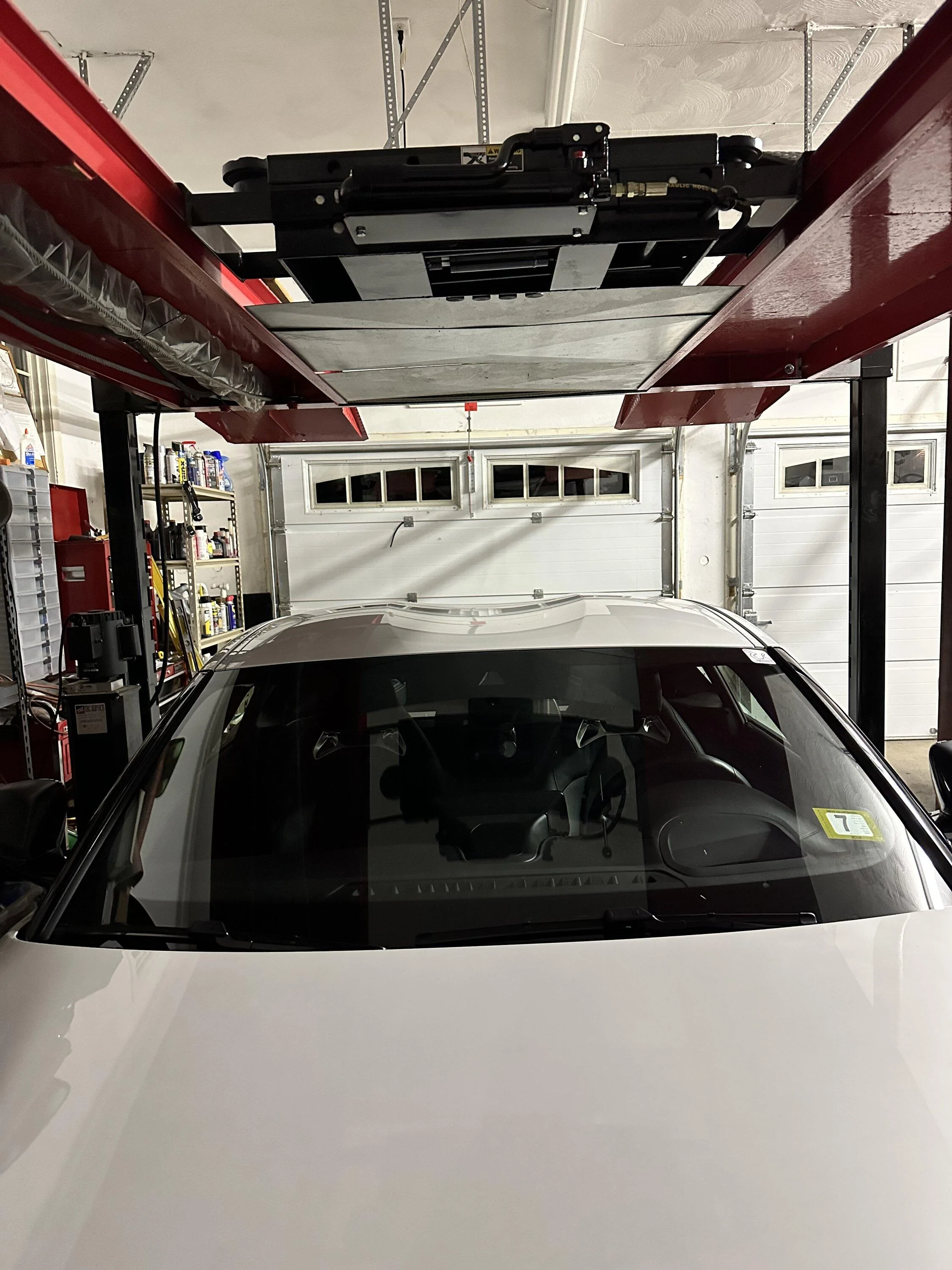

Yes and I have two sliders so you can lift the entire chassis or just front or back. Honestly best of both worlds been great. You also can work under the car without laying on your back. I also store the car on the sliders as they lock in position so the car is of the tires and suspension for the winter
How easy is it to move cars. Say I got my MX5 or Supra up there and want to flip em? Love the setup!
super easy unless the car doesnt start. I have ramps you just lower it to the ground drive on and off in like two seconds.
