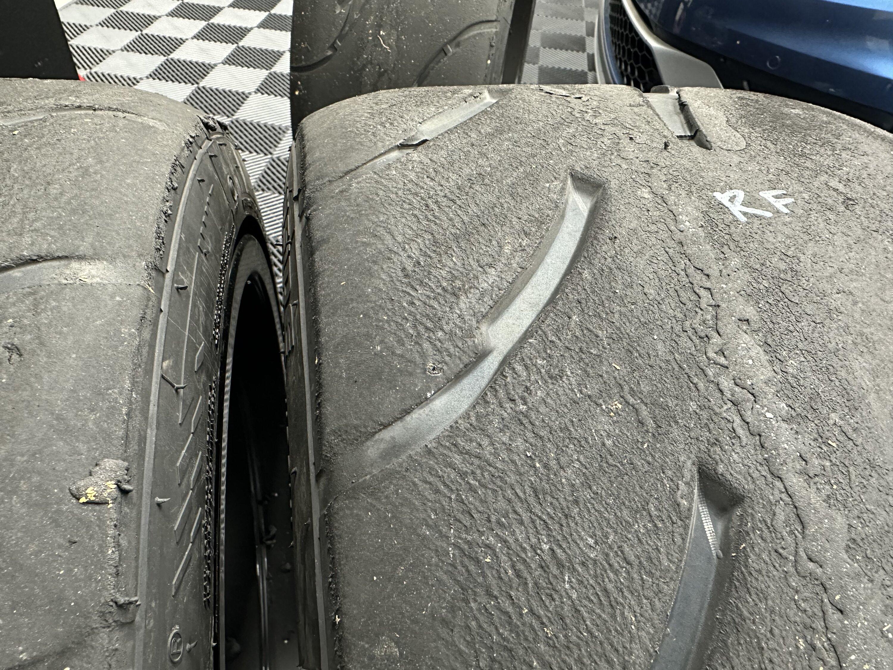

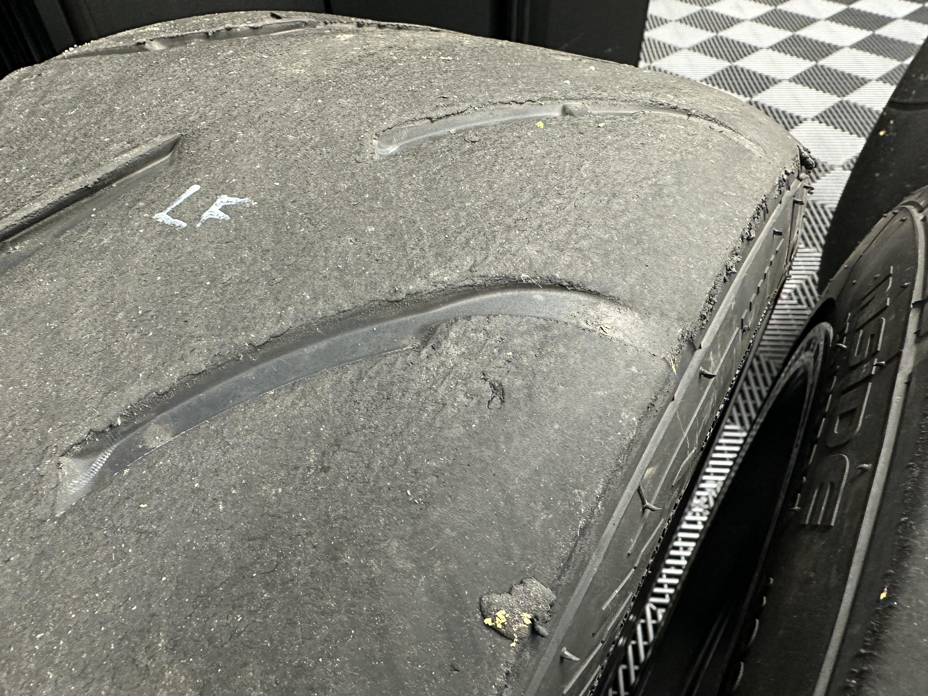

Hi all, my turn to come to you with a problem (besides ongoing cooling issues). When I brake, even a medium amount, track or street, my entire car rotates to the right, every time. It also doesn't quite seem to be EXACLTY when I press the brakes, but almost after a split second. Honestly, it's very hard to pinpoint exactly what is happening. All I know for sure is, after I press the brakes, the car rotates right after the nose dives. But, once it "settles" during the braking, after it has rotated, it doesn't keep pulling to one side. It's like it settles in at that weird angle, and I just have to countersteer at a consistent angle during the braking zone.
I've changed brake pads back to OE, still the same. I'm still slightly suspicious of a caliper issue or something, but the car had 3500 miles on it when I bought it earlier this year, and this was my 4th track day. I also would expect the car to keep pulling to one side during the entire braking period if it were related to brakes, but that isn't really the case... again, best I can tell.
I've had alignment checked like 3 times and by different shops, I can say with confidence that it isn't related to alignment. Unless there's something everyone missed.
All my bolts look torqued via paint pen marks, but I haven't checked every single one. Things suspension-related I've changed myself are:
  • Nitron R1 Coilovers
  • SPL Front LCAs
  • SPL Front Caster Bushings
  • SPL Rear Traction Arms
  • SPL Rear Toe Links
  • AMS Front Sway Bar
Could it be something electronic? To me, to the best of my knowledge, it feels like something is maybe loose and shifting under braking, aka dynamic alignment. Thoughts are appreciated.

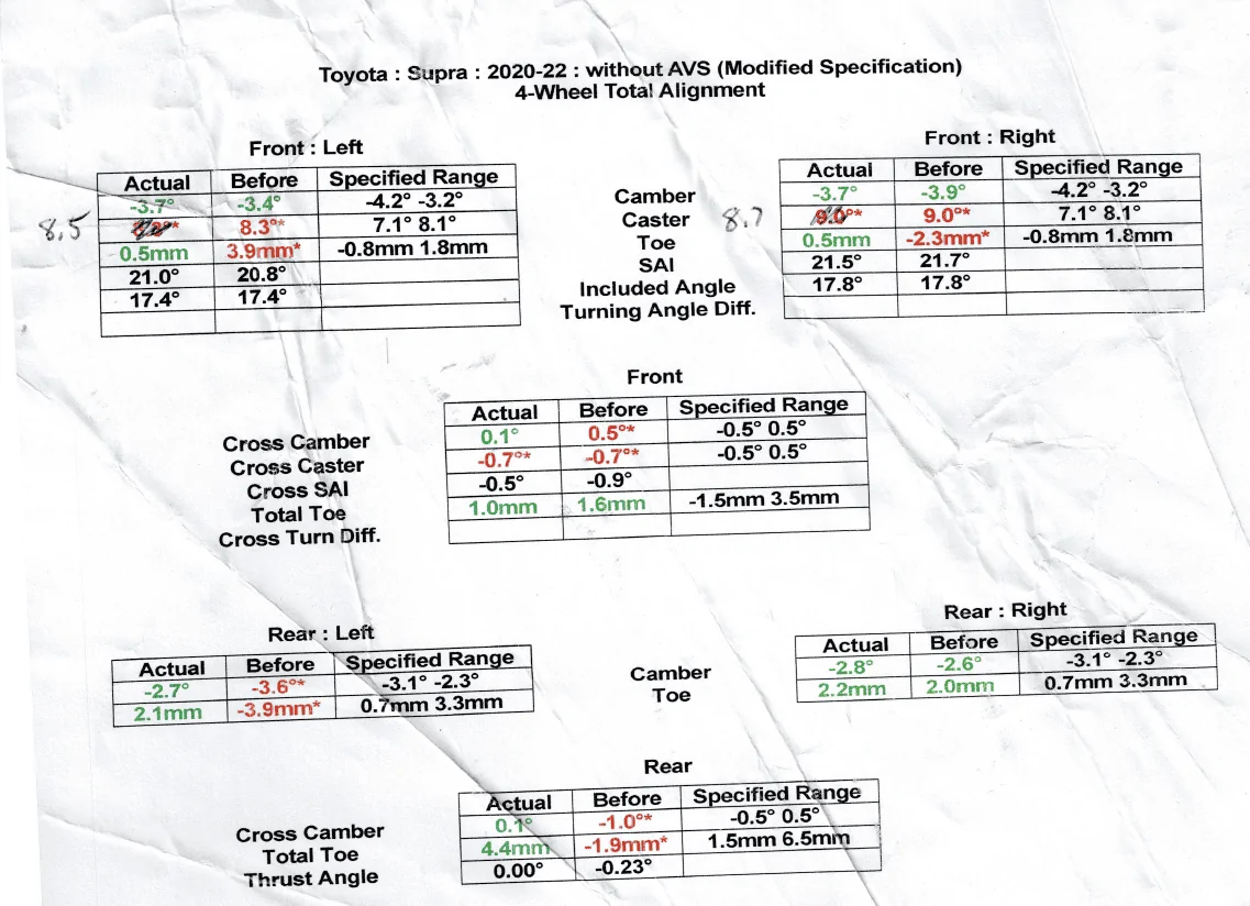

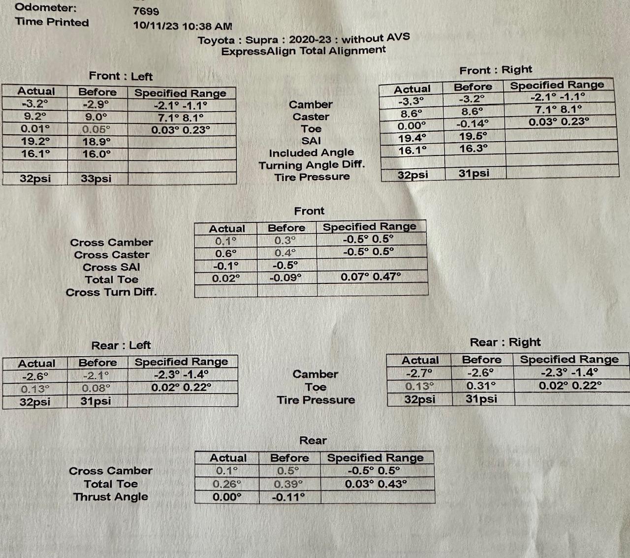

Can you post your last alignment? Toe makes a huge difference, even if they are doing it right. I played with mine in the beginning (like Bryan mentioned) and damn she did not like it.
Here you go. If something seems off, ask me, because I feel like they told me one of these numbers wasn't correct on the sheet. But it may be the caster that he wrote out (in which case the written number is correct)

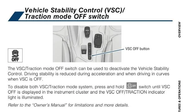

In regard to electronics, I track with traction completely off. I still feel like you never know what the 2,000,000 sensors in the car are telling the e-lsd to do sometimes, though. It also still doesn't give me all the power coming out of corners all the time.

Okay here’s mine:
And…

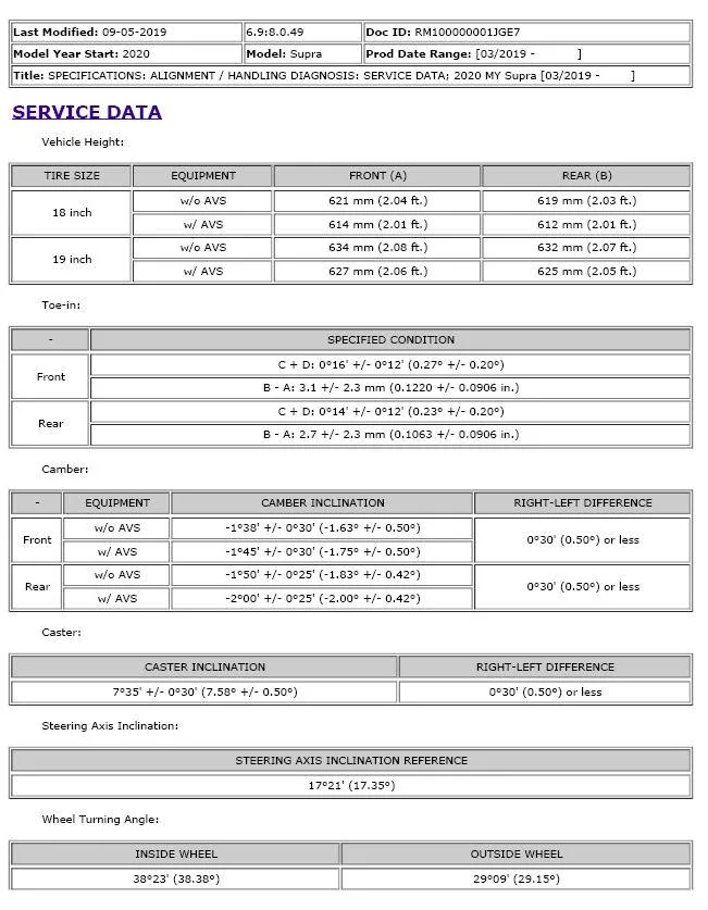

Spec above ā˜ (courtesy of Bryan from another page)
I know my car performed or felt off when my toe was off. The two go hand in hand pretty easily when you start messing with it. In the beginning my dash looked like a Christmas tree (steering angle sensor, you name it, while installing the SPL goodies). Last thing I needed to do at that point was messing with the alignment. Yet I did ?… I added too much toe out up front and more in on the back. Man she sucked on track! I’d definitely take your toe back in to spec (negative in the rear) and go neutral up front, until you can find someone thatā€˜s fantastic with alignment with adjustable parts.

My understanding is the rear toe is there to help counteract bump steer. I essentially copied a buddy’s specs in Austin that had his set similar/the same to Jackie D. He doesn’t have the problem I do.
I’ve had my alignment set this way without issue for at least one of my track days this year too, so I don’t think the issue is in the alignment setup. I also wouldn’t go off of official Toyota spec for a track setup. That spec is for the street and with OE suspension.
