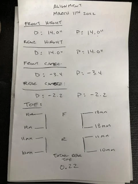

Is this what you’re still currently running Bryan? @razorlab
And how about you Rock @Rocksandblues ?
I think you both are on a 275 -18 square setup like me. Mine is literally sitting at Autoquest waiting to get put back to my -3.5 and -2.5 camber I was running before. You guys have way more time & experience in this car than I do. If you don’t want to post here, could y’all PM me. Muchas gracias ☺

so many different set ups... lol
stock struts
Height- too low
2.6 camber front. rear whatever OEM is
front toe .2 toe in each side
rear 0
200 tires, full aero, stock turbo and cooling
2:02 -2;04 in traffic VIR, 1:18s at Summit main. for reference

0 toe in rear? Are you sure?

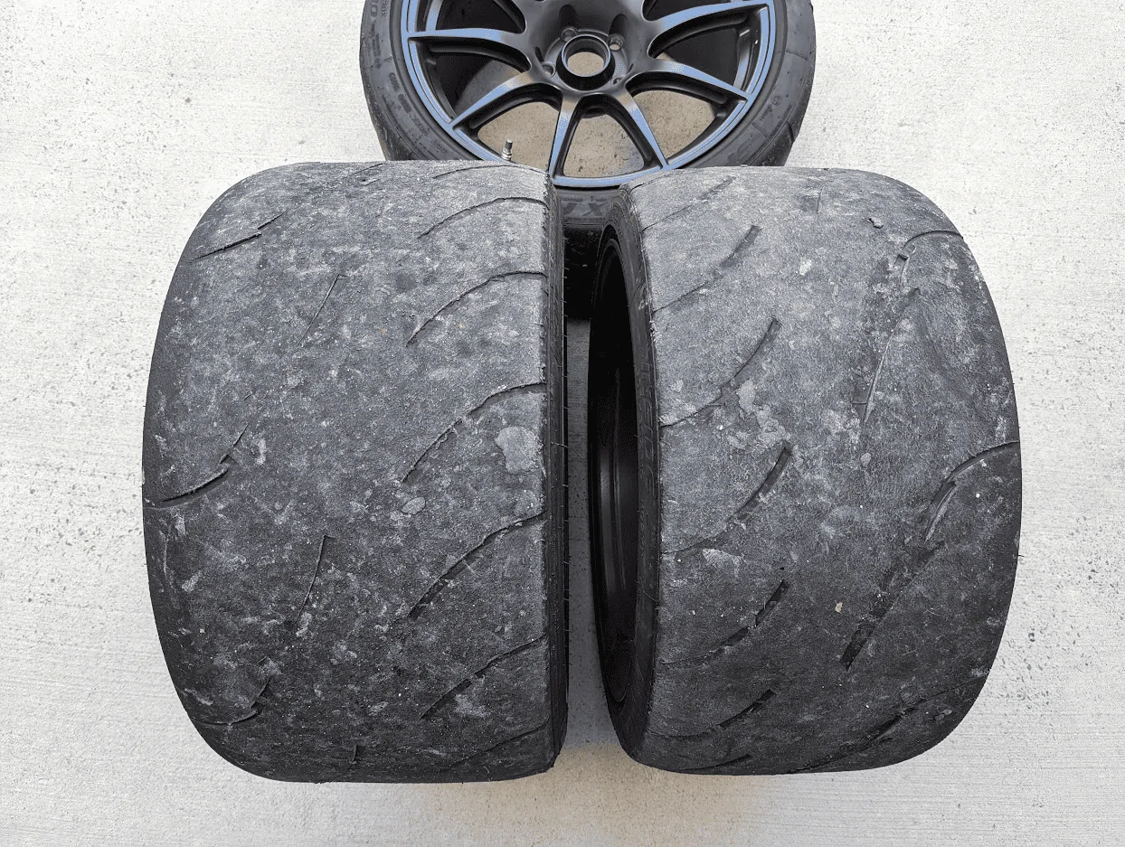

I bought these for fun lapping and not worrying about PB's. Ironically I used them yesterday at Palmer and I did a PB.
That said, I will never buy these again. They are SOOOOOO loud on the street. They low level vibrate the whole car and the hum is so loud I can barely hear the car downshift. The final nail in the coffin for me was the wear after basically one track day and driving to/from the track 2.25 hrs each way.
CRS are basically the same price, make no noise on the street and have more grip. Great example of treadwear numbers meaning nothing nowadays. 200tw faster than 100tw. I'm going to do another set of Kumho V730's instead of these for just fun lapping from now on.
That wear doesn't look terrible. I'd think they'd hold up a lot better on a lighter car. My experience on my C7Z with 305f 325r is they are indeed loud, but not as obnoxious as say an R888R. They get quieter with less tread. ? This was my first set at 16 heat cycles and a few hundred street miles:
My biggest gripe is they heat cycle out quicker than the tread wears. 1-5 they were on fire from the out lap, 5-10 they were pretty good and then fell off a cliff at 10+. I also had a difficult time managing pressures. They come up quickly and a LOT; I struggled to keep them under 35ish psi after 5-6 laps and that's starting at 24 cold.
The 2nd set I ran held up better by flipping them side to side each day -- more usable tread remaining but they've cycled out as quickly.

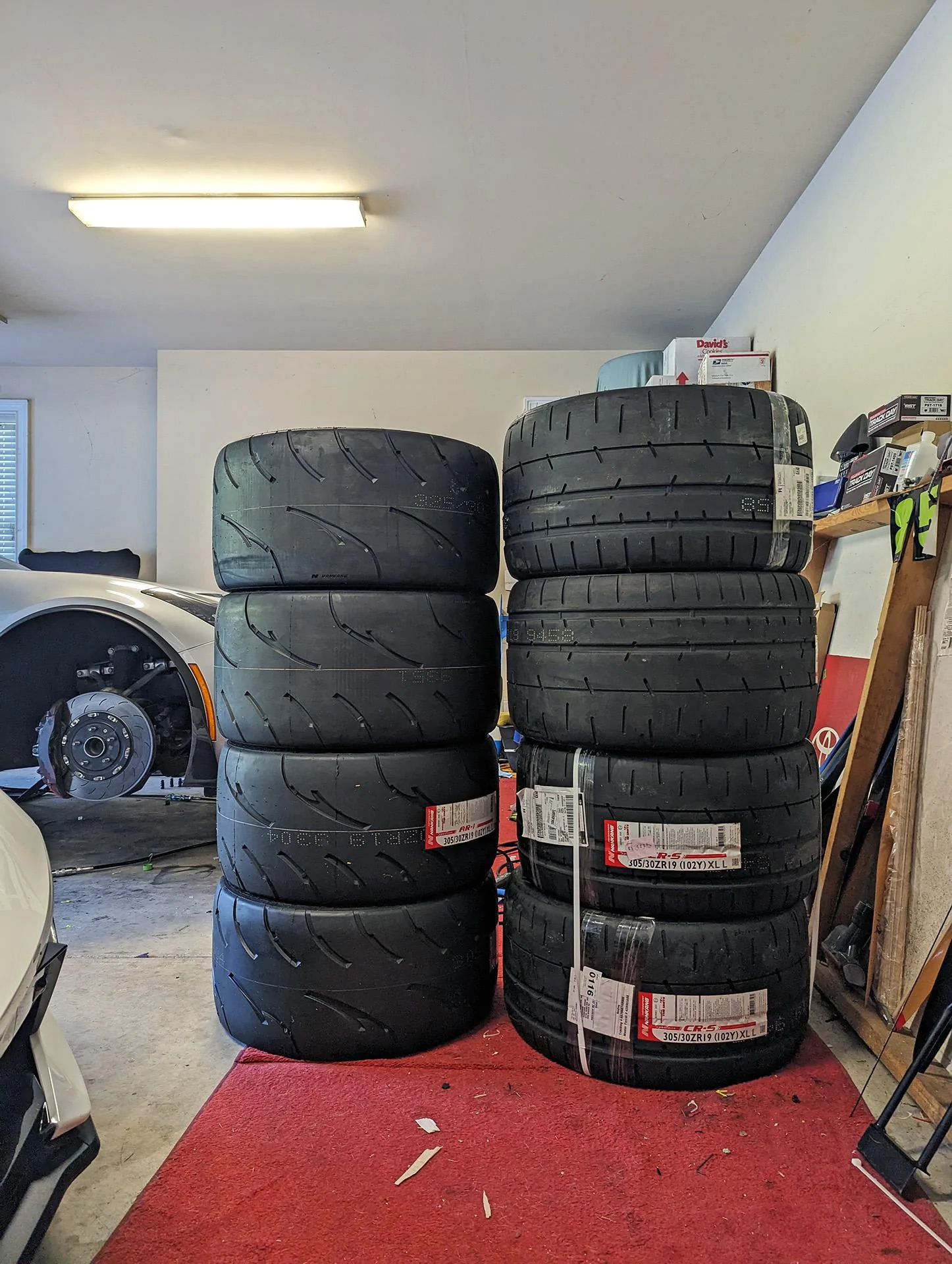

Enter the CRS V2 -- identical spec sizing and massively wider. I have these going on this week and I'm at VIR 3 days back to back so I have high hopes they will go all 3 days. Even if the grip is the same as the AR1 and just last longer I will be content.
Easily go 3 whole days and more grip than AR1. You will be content. V2 need a little bit more time to warm up FYI.

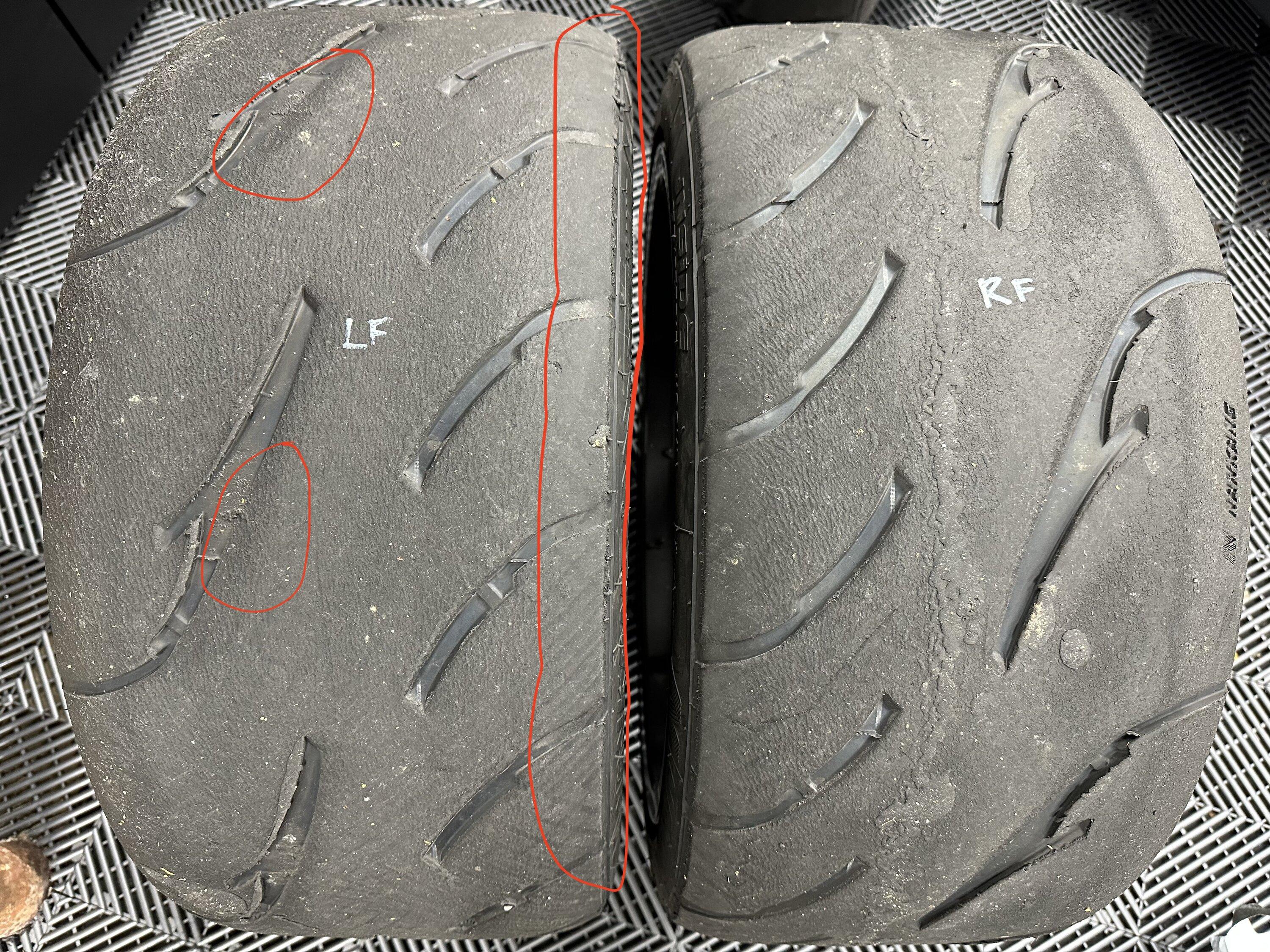

I'm talking about the abnormal inner wear and by the cutout sections. My CRS don't even look like that after FOUR days. Same alignment and everything.
I even put my CRS back on for my event yesterday and that would show if my alignment got all wack... Nope, same normal wear.
Slower tire
Wears faster and really odd
Loud as all shit.
Hard pass on these.

I had similar odd wear patterns but it didn't seem to have any meaningful effects. I think they'd be a great time attack tire because they are quick and ready to rip, but yeah.. the life is abysmal..
I have high hopes for the CRS! Options are limited in my sizes so if they live up to the hype then I'm set for a good weather dual purpose tire.
Slower tire
Loud as all shit.
Hard pass on these.
By the way I wear out that same spot on all my front tires regardless of car or tire brand. I have done it to Michelin Primacy, Cup2, RT660, GT Radial SX2, Federal 595 RS-RR using a GR86, GR Corolla and GR Supra. Always thought it was happening due to too much understeer as that part of the tire slides towards the outside.
Will be my 1st time on them as well. Looking forward to it
