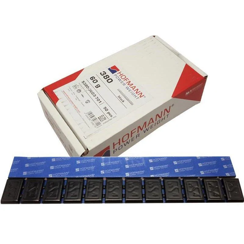

Yet another reason for me to switch over to them.... I only got 4 track days out of the 660s before the inside was down to threads. Sucks cause the rest of the tire is still good. Not even heat cycled out.
On another subject, what wheel weights did you say to get? The ones that dont melt off.
