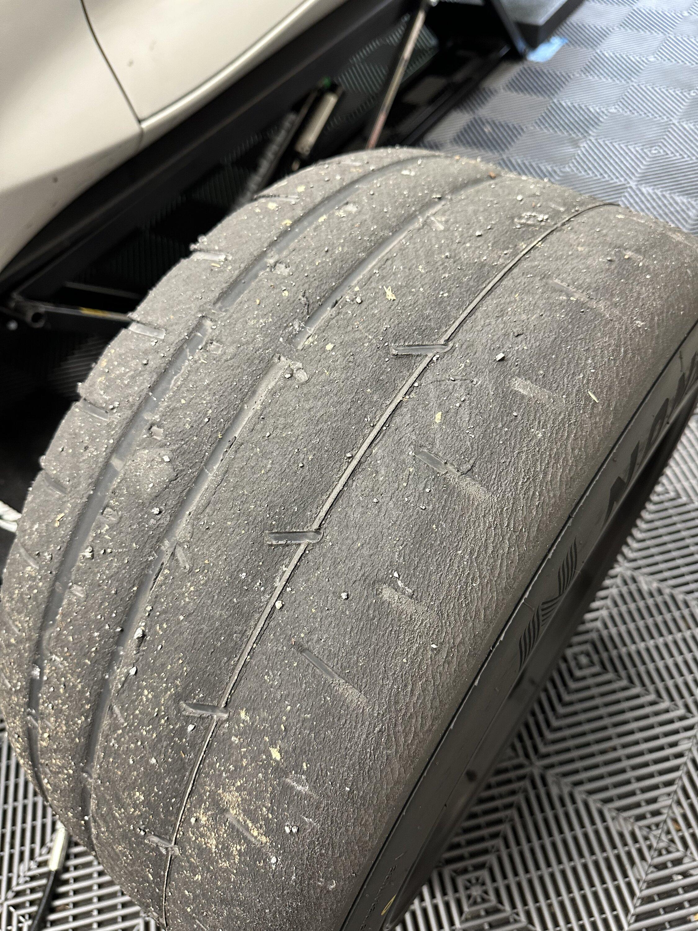

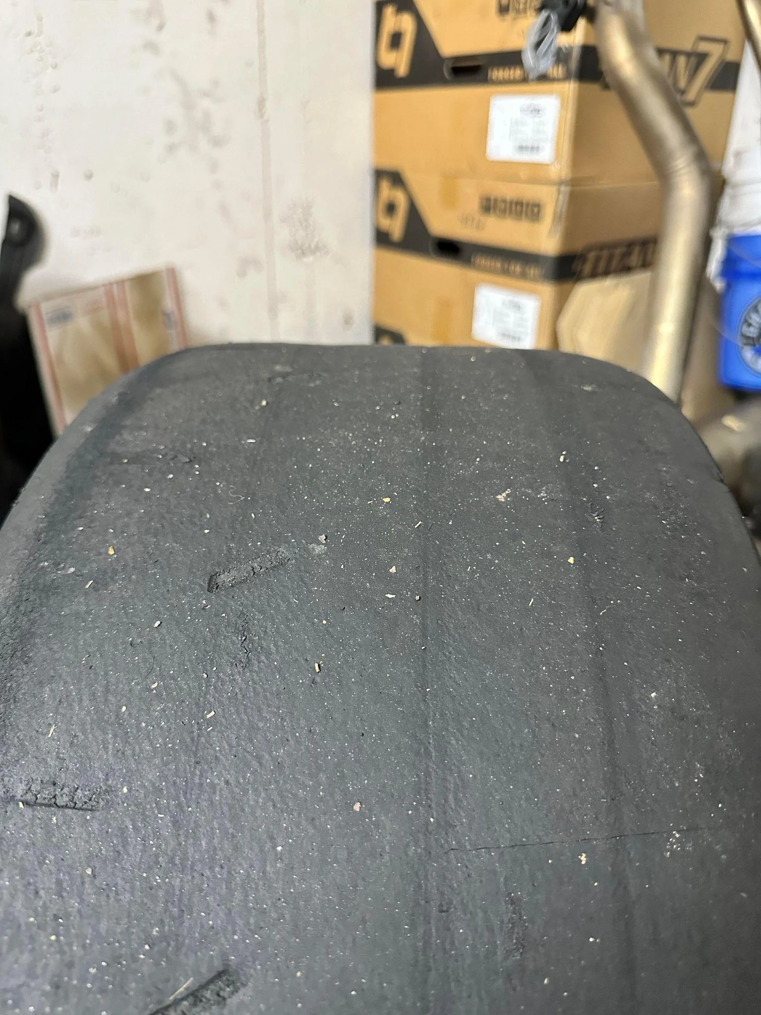

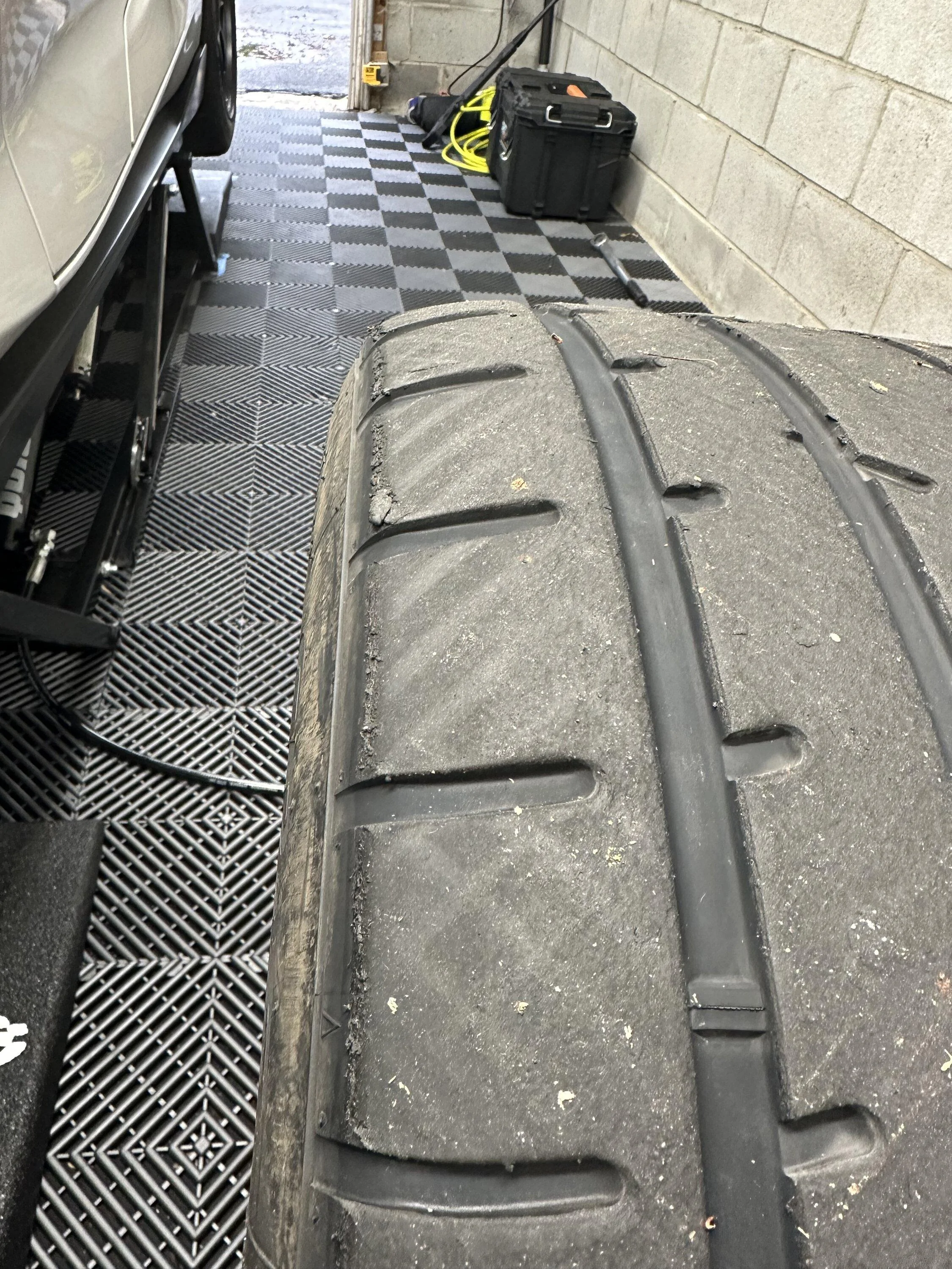

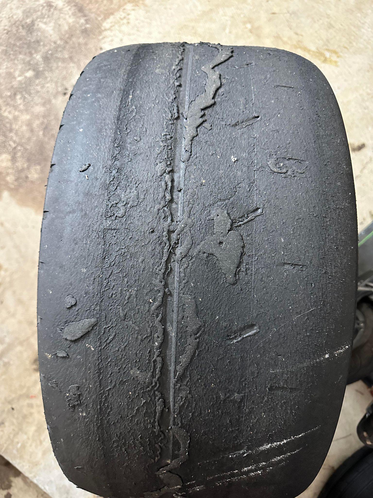

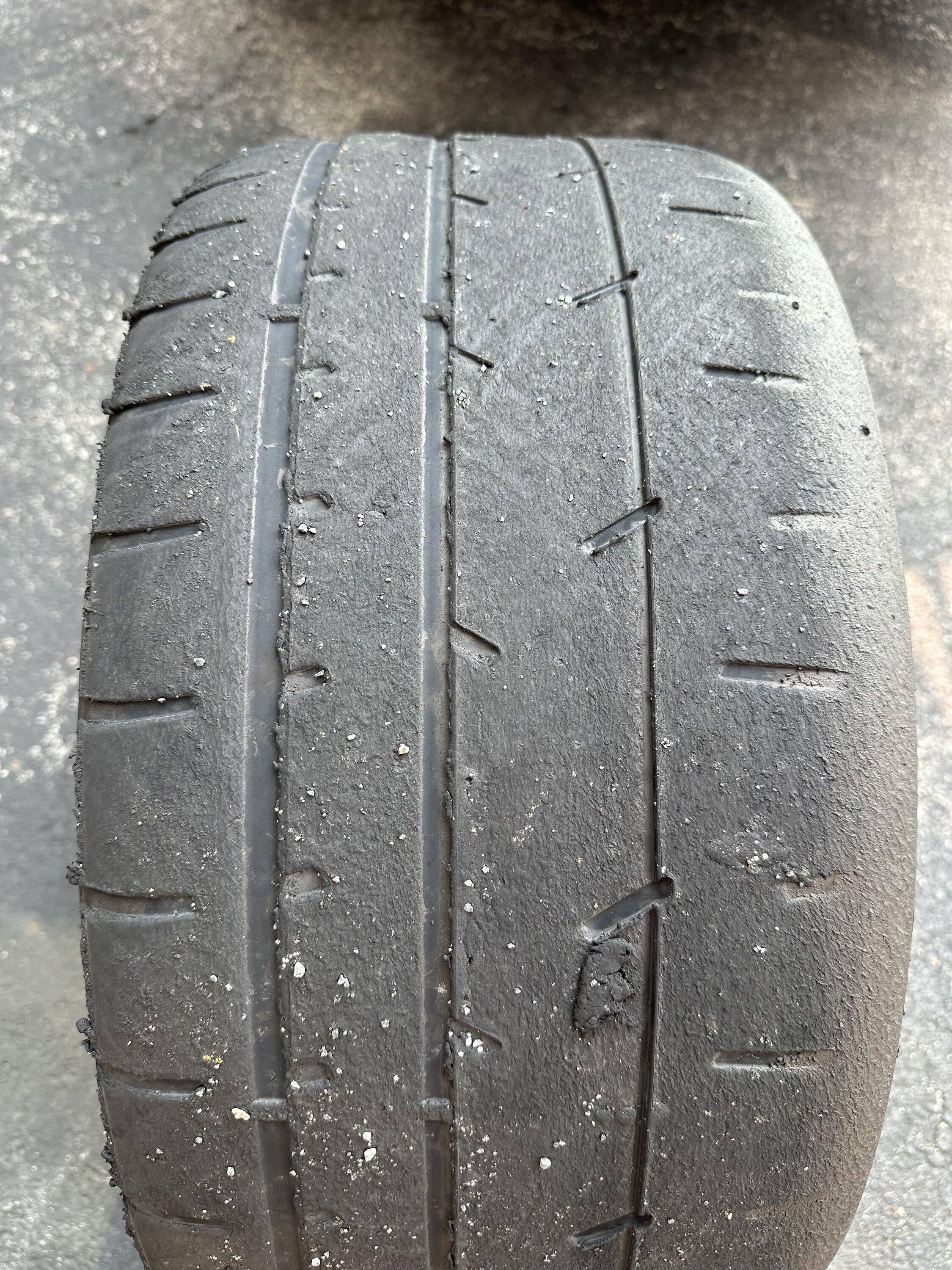

So I will jump in on tires and wear. I now am on my 18 th set of different tires and many different alignments and camber settings. Trying to get even tread wear down to the cords to get as much out of them as possible. Have used heat gun for tire temps from outside center and insides. I am still not an expert in this area but I believe if you all are coording the insides then you have too much neg camber. Some tires do want more than others. I get about 6 track days on average. Some of the softer 100 tread wear groups. 3 to 4. I Rotate at least once or twice per track day. Cross rotate if not directional or then fronts to backs. So you may want to back try backing off the neg camber a bit and see how it works. I found that about -3. In front and -2.6 to 2.8 in rear has been about the best. This also depends on how stiff the sway bars are as the car does need to rotate to flatten out the tire so have to play with all of these to try and get them to wear across the whole tire evenly. Anyway they are lot of options in this area but something to consider.
