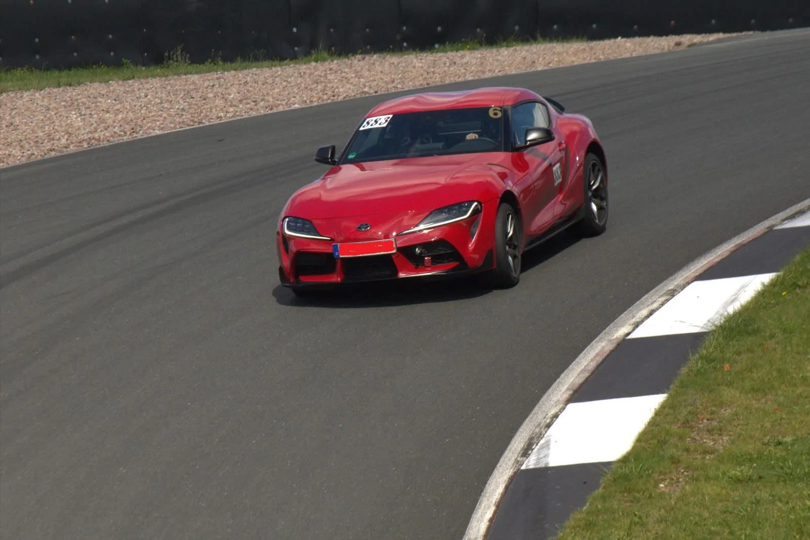

Hi everyone,
Thank you very much, for this thread, lot to read and to think!
I just finished my season, this car is a beast even with the EU engine. My car is fully stock except brakes, and I want to modify it as little as possible.
That said, I have been thinking about installing aftermarket front and rear sway bars to improve the behavior in the some corners (especiqlly the chicanes), and hopefully compensate a bit for the lack of camber on stock suspension/height/geometry.
Also, it just looks stupid how much it lifts on some tracks ?
I searched in the forum already but feel like everybody is directly switching to coilovers.
Is anybody on stock shocks/height and aftermarket sway bars? Any thoughts if this is worth it, for a track and mountain road perspective?
I know mounting the rear swaybar is a b*****, so any comment is welcome to help me take a decision :thumbsup:

Thanks for your feedbacks! Glad to hear some very positive experiences.
I like slightly oversteer, especially in slow corners, and you are both on square tire setup, which I would also like to avoid (German TÜV, etc...), so with only front bar I will definitively have an understeery pig.
My funds are definitively not unlimited, seat time, fuel, tires and brakes already makes a big hole in my pockets. ?

I have stock springs and struts and did Eibach front sway bar and later added the rear. I ran all summer on the OEM PSS tires. The car actually felt fine with just the front sway bar but as I got faster, with OEM set-up, really beat up the front left tire. I added camber (Verus) plates and the rear bar and boy the car is fantastic on the street and track. I may try a 200TW tire, the same tire size, on the OEM wheels. Sway bars and camber plates on stock suspension is great.

A good friend ran his stock, with only sway bars and tires. He has lots of experience and hauled ass. A lot of people didn’t like that he was so fast with so little mods. I wasn’t the only one he‘s lifted the engine bay for ?- So yes, sway bars front and rear will stiffen you up quite a bit. Tires are a must. Whoops, brake pads too… He ran Hawk DTC 60/30. Fastest Supra at the Miami/Homestead track. I’m so close to beating his time and I have coilovers. Sad ? hahahaha… Proof you can go a long way with just that
I also consider the supra to be a little beast out of the box. I'm not as talented as your friend, but regularly keep up and overtake >100k€ cars that should let me in the dust.
For tires I run the Goodyear eagle f1 supersport. They are not semis or 200TW but have nice stiff sidewalls so I can deal without camber plates for now. Btw amazing tires to have fun if you are not looking for the best lap time.
With the brakes I have the stock system except added front brake duct. It's so good I can run the stock Brembo pads for "most" tracks.
Anyway I am convinced now, I need to wait for April (season plate number) to have the Eibach installed and will post here again after I burn enough tire with them :thumbsup:
