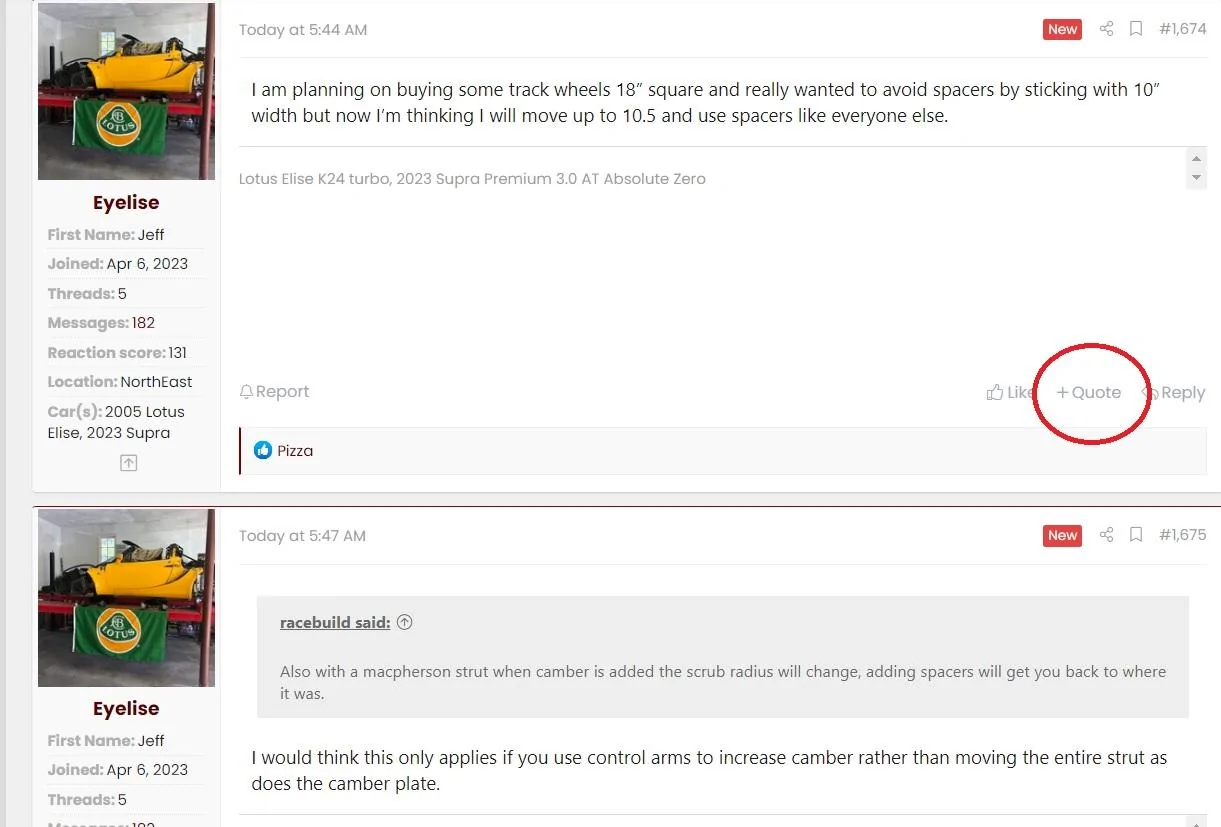

I am planning on buying some track wheels 18” square and really wanted to avoid spacers by sticking with 10” width but now I’m thinking I will move up to 10.5 and use spacers like everyone else.
wheel size doesn't matter so much as design and offset.

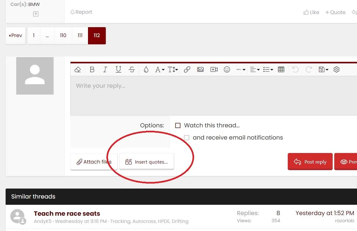

Also, FYI, you can quote multiple posts at the same time. If you click on the "+quote" of each post you want to quote, then hit the "insert quotes" button. It's a time saver vs making multiple posts :thumbsup: :headbang:

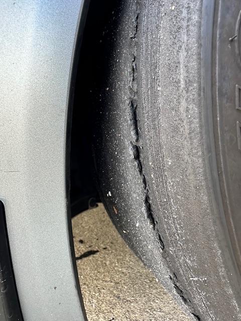

Turns out there is less than 10% difference btwn each of the softer settings on the Eibach bar and the first. You should not notice much of a difference cutting the last out. I have mine in the middle and the car is quite well balance
Found out all we need to do is use the “adjustable” endlinks ??‍♂and (when under compression - not in the air) the sway bars won’t touch the control arm. So you are right, I need to select that last notch. Met up with a good pro race buddy that said that along with dialing down (or is it up?) my Ohlins and make them stiffer. He was able to press on the front of the car and the back and could tell I was way too soft. Hence why I was getting rub front and back. He’s not working on my car & just a friend. But it made sense & glad he looked at it.
The end result after a weekend of really high speed right hand turns (drivers side). So I can adjust the height even more or… make her stiffer. Will be doing the latter and can go up in height, if needed. Also toasted my pads. I’ll have to get a pic when they come off for @Rocksandblues and see if I made the cut for maximum use ?
I knew this going in. Wife and I were doing double duty. Almost got two full days out of old pads and tires. Had a blast ?
