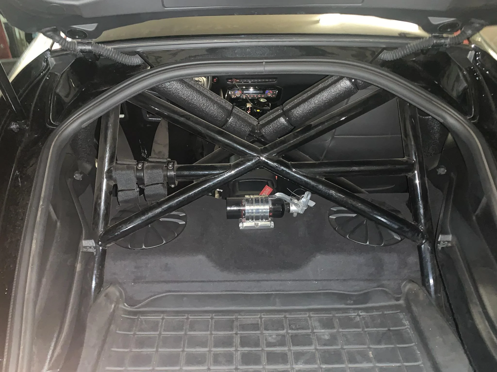

Roll bar shoulder straps and then the race seat base for the other connections. Pretty 101 stuff
I don't agree that the cusco harness bar is tissue paper. I have stress tested mine. If the car ever goes wheel to wheel I would have a custom roll bar installed. Most of the bolt in one's weak link are the zip bolt fasteners which would mean you have a loose roll cage bouncing around inside in a wreck.

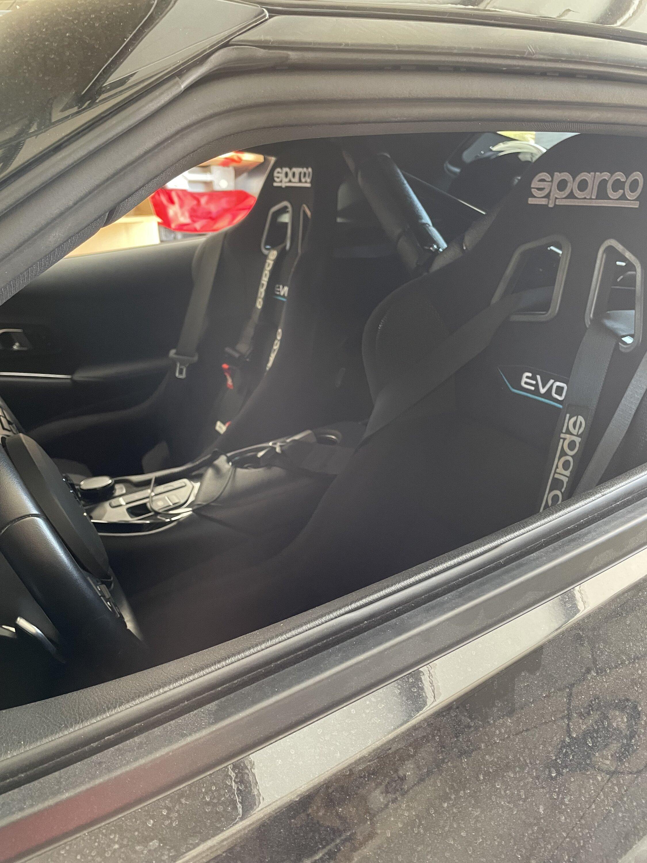

I will just add that I have a studio rsr role bar exactly for this purpose. I would not classify it as bad. They all are bolt in role bars. Bends and stubs are all acceptable for NASA etc and floor mounts are solid. I have 6 point sparco harness and seat. 4 eye bolts with proper backing plate on each eye bolt through floor board for the side belts and front center belts. Shoulder go to roll bar with collars so they will not slide. Then of course you need a HANS device on your Helmet. I use necksgen. I Bolted another seat belt socket to the seat bracket so the 3 point stock belt can still be use for the street. Here is a pic
of what it looks like if that helps others.
