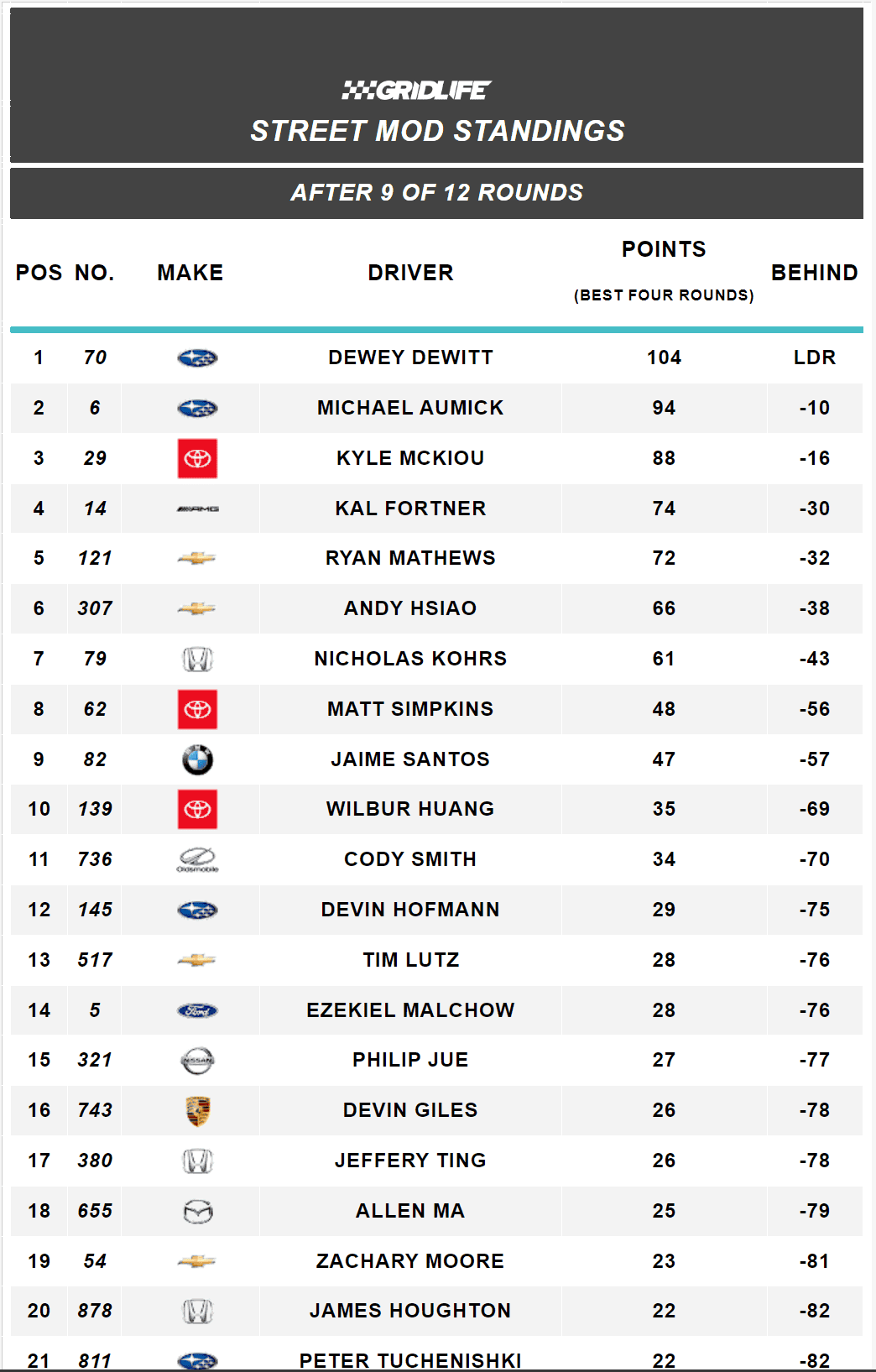

Kyle, I know who you are (Gridlife) and I just wanted to thank you for taking the time to personally share your experiences with the JRZs on this forum. This sort of information is invaluable.
For people who don't know who Kyle is:
Am I supposed to be impressed? I am Dewey Dewitt #70.

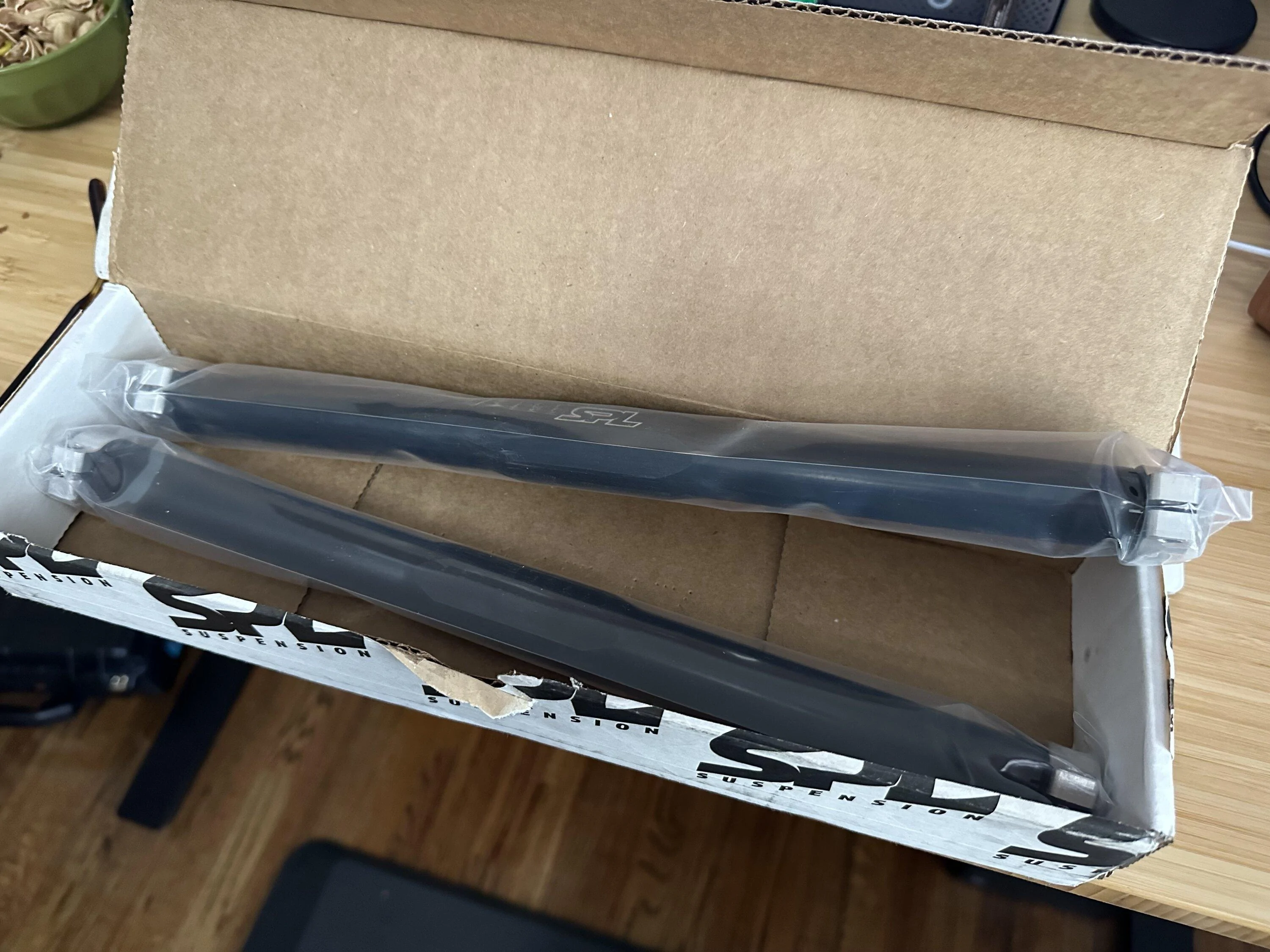

A reminder to always inspect your whole car after/before your next event. Found this issue today. Rear toe arm is broken. There is an inner piece here that the collar clamps onto to prevent the arm from being loose. This is obviously broken as the collar is cranked down and the arm is still able to move. This will eventually break the arm itself and be not good. I would not have caught this if I didn't have a habit of grabbing everything and twisting/pushing/pulling as I inspect the car.
Now to call in the morning and get a replacement asap as I have an event this coming weekend.
Following up on this. Kudos to SPL, they sent not one, but two replacement arms, no questions asked.

So being in the market for either SPL or Verkline goodies, any consensus on which one to go with? It seems a handful of people have had SPL parts fail on this platform. Looks like SPL is stepping up to support them, but I wouldn’t want someone to have a failure on track - or on the road.
Am I overthinking this? Should I expect to have to inspect the parts every x number of months/events?

If I did it all over again I'd go with Verkline. I've dealt with SPL CS and I'm afraid my experience wasn't as positive as @razorlab. Also from a mechanical engineering perspective the design of the Verkline components seems to be superior to the SPL stuff.

Go with what your installer is most comfortable with. If doing it yourself, I can second SPL has been mega helpful and sent me a free replacement as well. I think the error might have been our fault, regardless they were helpful as ?
(edit: Wes beat me to the punchline again ?- Verkline for the design win - honestly I didn’t even know they were an option when I was shopping, just Megan racing and a few others that didn’t have other matching part - if that even matters?)

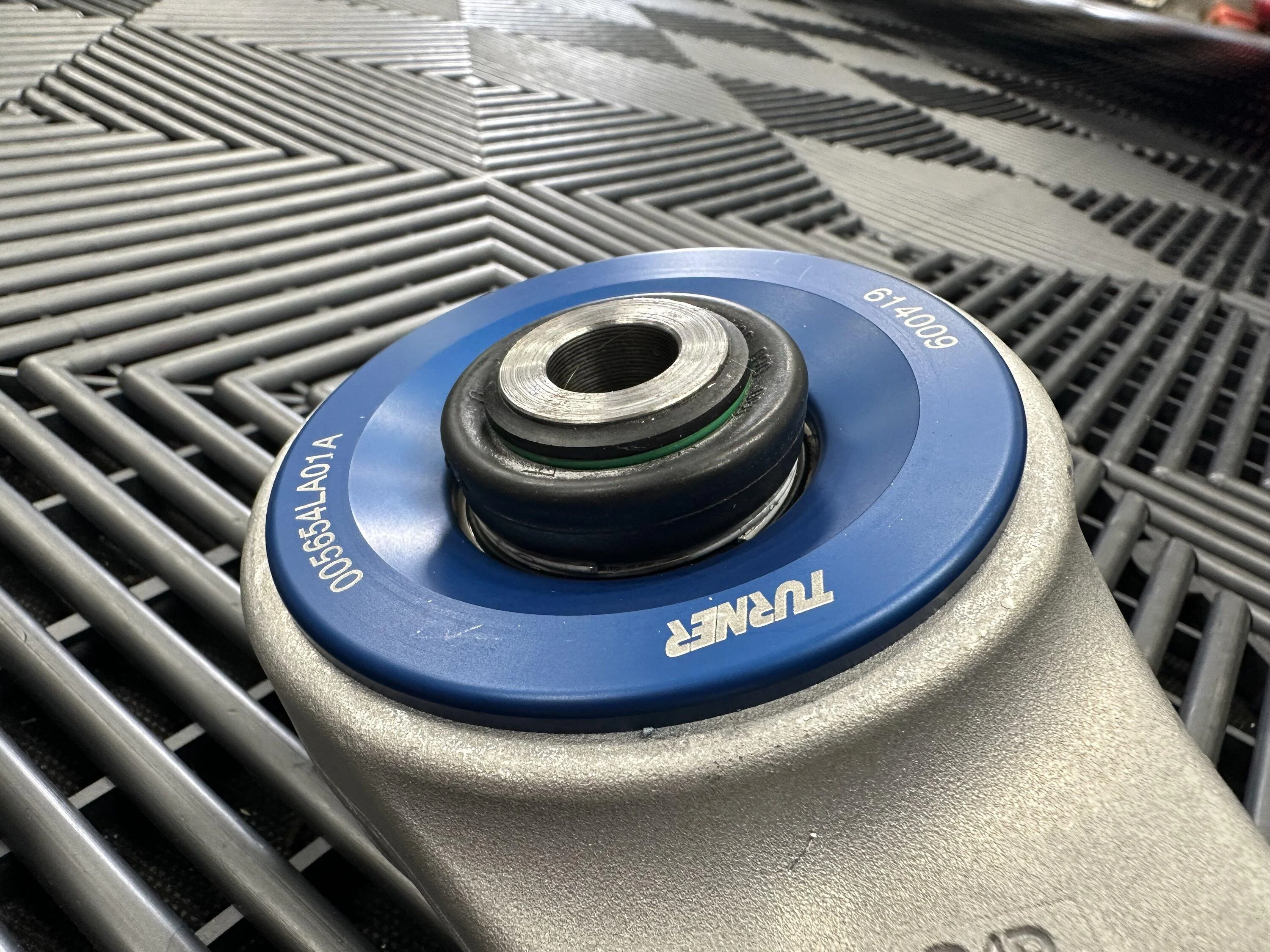

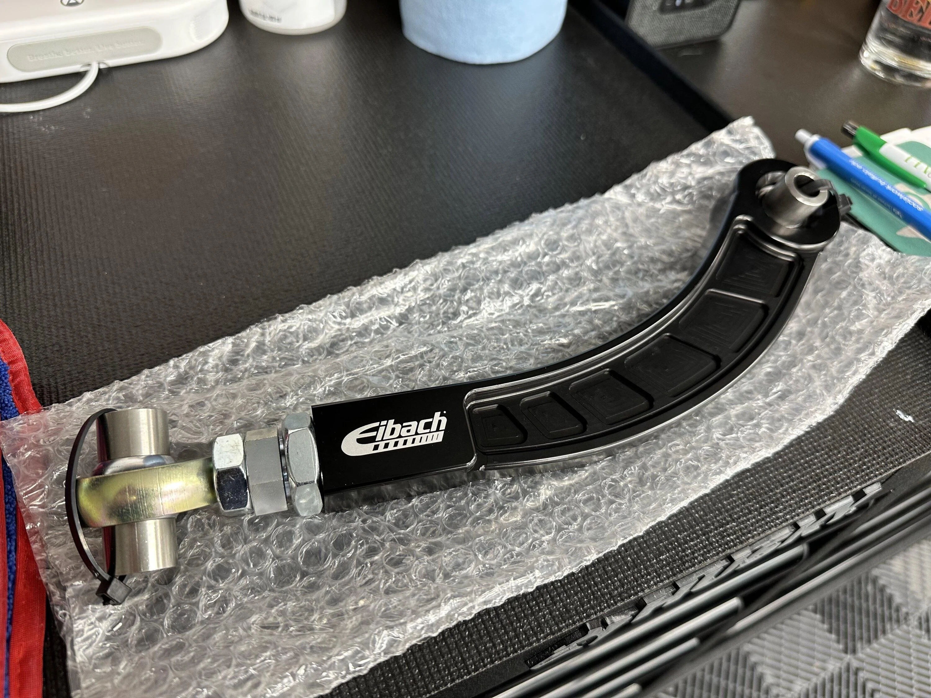

100% agree. Eibach also makes a rear upper arm that is really nice quality with actual high quality bearings.
Turner has real nice front caster arm bushings. Sealed even!
I’ll be installing both of these over the winter.
Double check the collar sleeve/spacer tolerance to the bushing. I had some with a little bit more play than I’m comfortable with so I made new ones.
