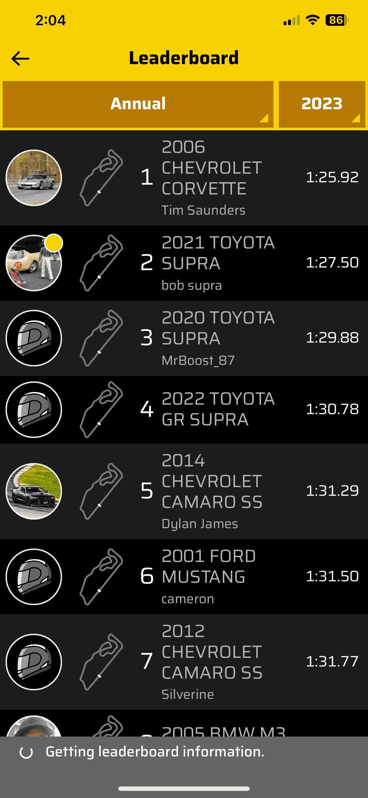

The Supra can be so fast with it being almost stock. There is a local guy that has a 23 MT that is knocking on the door of 1:4X's at Palmer with just springs, a seat, harness AND oem tires! It's very impressive. Stock camber and everything, he just keeps destroying the front tires, lol. We keep joking he is going to destroy us all after this winter when goes down the same mod rabbit hole we have.
He is #4 in this list:
I assumed springs would make the car worse. That's awesome.

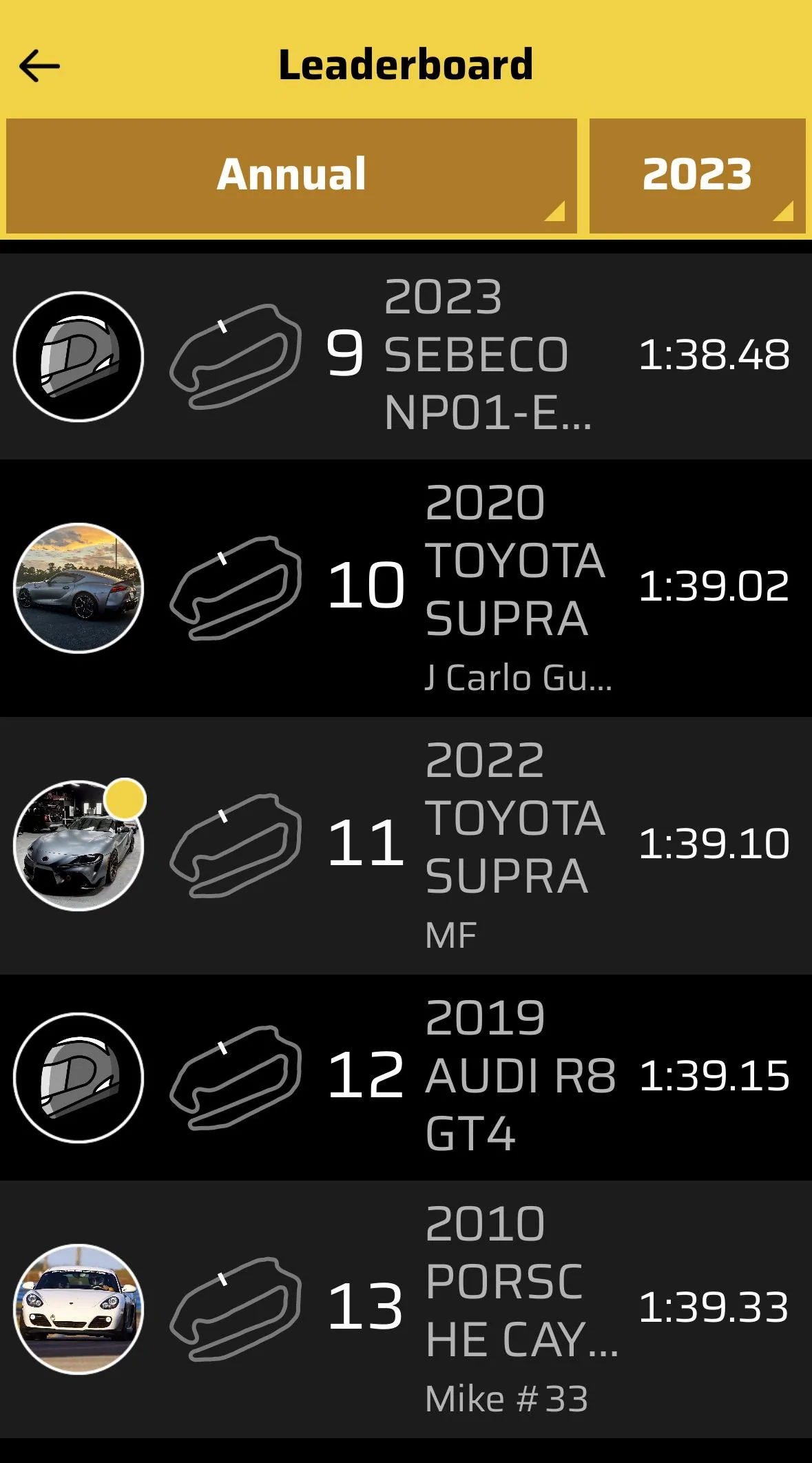

Dang mothafocka! That is hauling ass w/out coilovers. I’d like to think most of you guys also have sway bars as well. Regardless, proof it don’t take much ?

Love it! Your car being the exception on how to optimize this Supra for track. How does your buddy with the red Supra do on that same track? You two seem to be pretty evenly matched. Assuming he doesn’t have the Catalyst.
