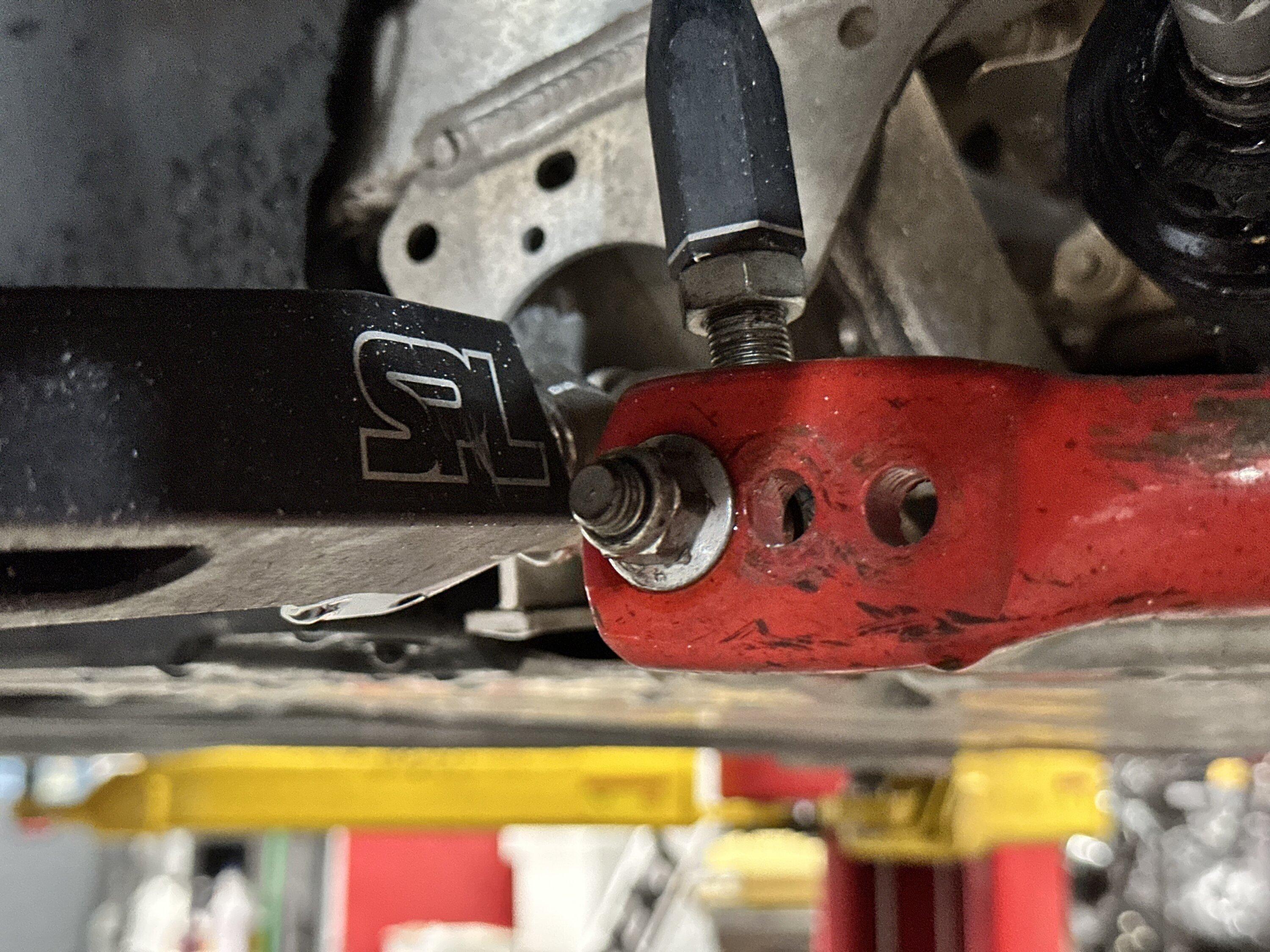

I will say sway bars, if you decide on SPL lower control arms

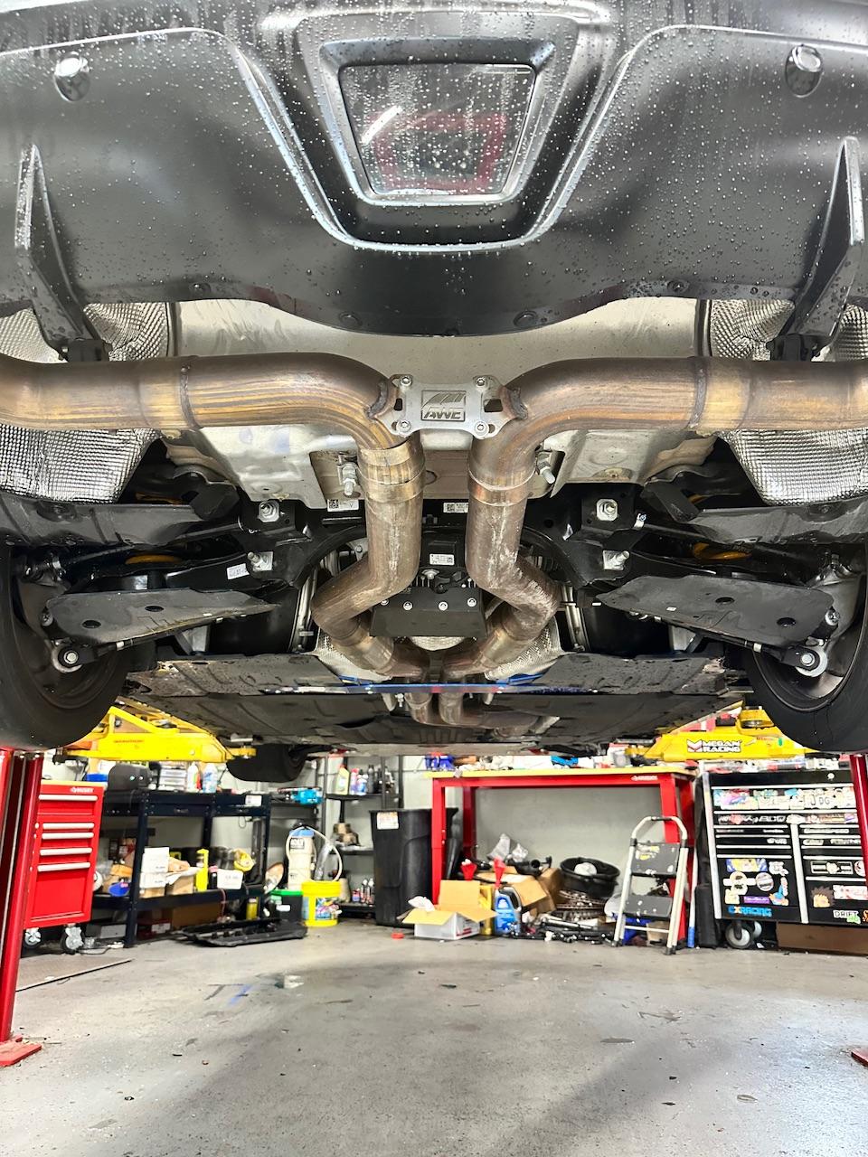

On a full turn I can get these two can audibly connect. Not my intention, so we’re going to use the adjustable SPL endlinks and move the sway bars down further. This is up in the air, so it shouldn’t take much and ideally the sway bars will be horizontal (under compression) and out of the way.
Eibach sway bars are a bit too long with the SPL lower control arms. On a full turn (again not going to do full turns on the track but…) I can get these two to connect and make a noise. Not my intention, so we’re going to take her back a notch and cut her down before next track day - Daytona.
Otherwise good track inspection and here at Sebring. Looking forward to getting back on track! Should loose a few pounds today. Still hot ?. Expect better weather tomorrow.
Turns out there is less than 10% difference btwn each of the softer settings on the Eibach bar and the first. You should not notice much of a difference cutting the last out. I have mine in the middle and the car is quite well balance

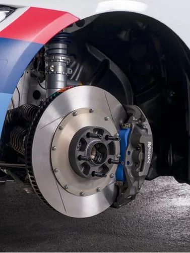

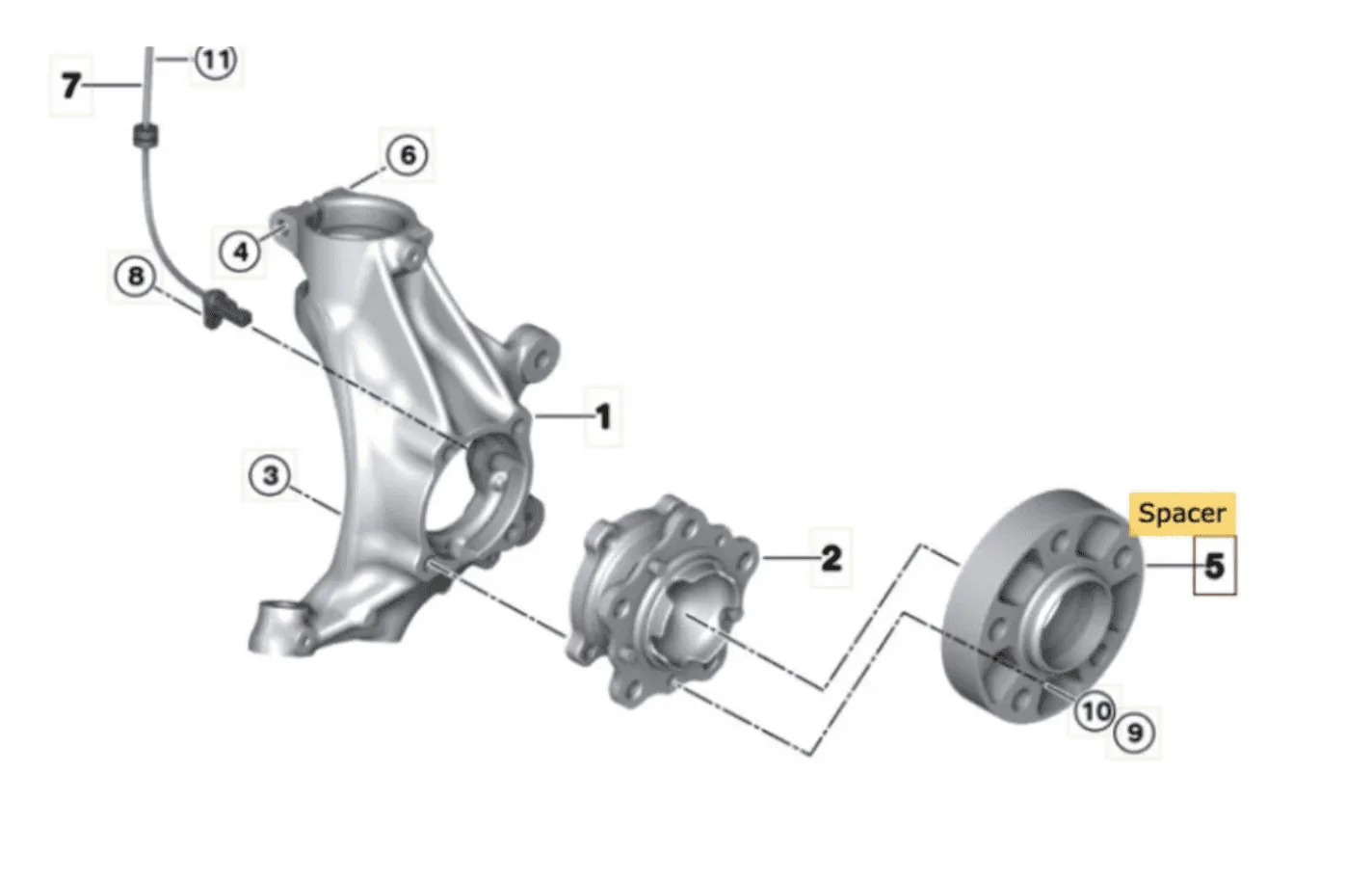

The M4 GT4 race car uses big ass 32mm spacers. They are even in the parts catalog.
Huh, interesting. I understand that spacers are used in various events and such but such a big spacer seems like a detriment. I was just reading the other day, the Cyber Evo was running 18x10.5s with 50mm spacers all around. Just seems odd that an unlimited time attack car would do that when they could get different wheels with a more negative offset. Maybe I'm missing something?

Also with a macpherson strut when camber is added the scrub radius will change, adding spacers will get you back to where it was.
