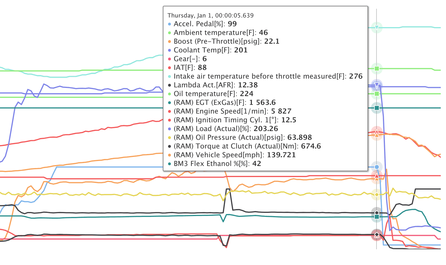

EGT logging is inferred unfortunately and I doubt anyone has run actual EGT probes and logged.
Just don’t run a ton of boost through the oem style turbine housing and you should be okay.
@Islindur
Here is a snippet from the end of the straight in my Supra. This is in cool ambient temp but inferred EGT is about the same even in 80F+ ambient. Pure 700 turbo, GESI catted downpipe, oem catback.
I am having individual EGT sensors placed on each runner of my Elise manifold. Cylinders not uncommonly run at different temps even when the injectors are all well balanced. Hot cylinders are pretty common and it has a lot to do with the intake manifold design. Even more common in boosted builds. On top of that, injectors can fail slowly causing one cylinder to slowly lean out and EGTs to rise. Monitoring is not all about preventing detonation, you have to safeguard those exhaust valves from excess heat too. If you know the actual EGTs you can build in safety parameters (cut ignition) or add additional fuel selectively to the hot cylinders. It's pretty cool stuff.
