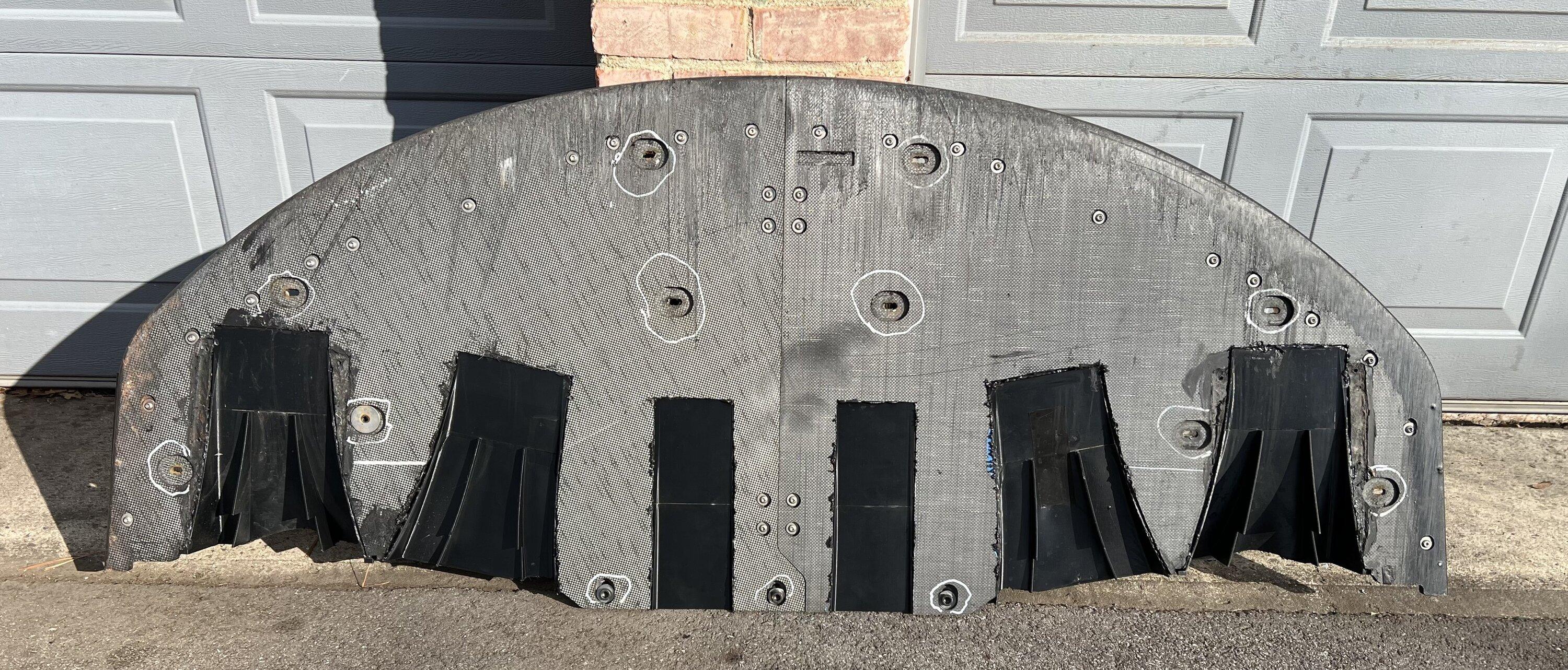

Booo, i was just thinking of the sheer girth of diffuser tunnels we can shove in there if the coolers wasn't in the way of 3.0 builds, way more than this:
you could take the aux cooler out and easily run a bigger main rad, lines, and pump to beef up cooling considerably. Or you could add an oil cooler and delete the aux rad since that would decrease the load on it.
Any non-oem style splitter would be illegal in GLTB Street class, though
