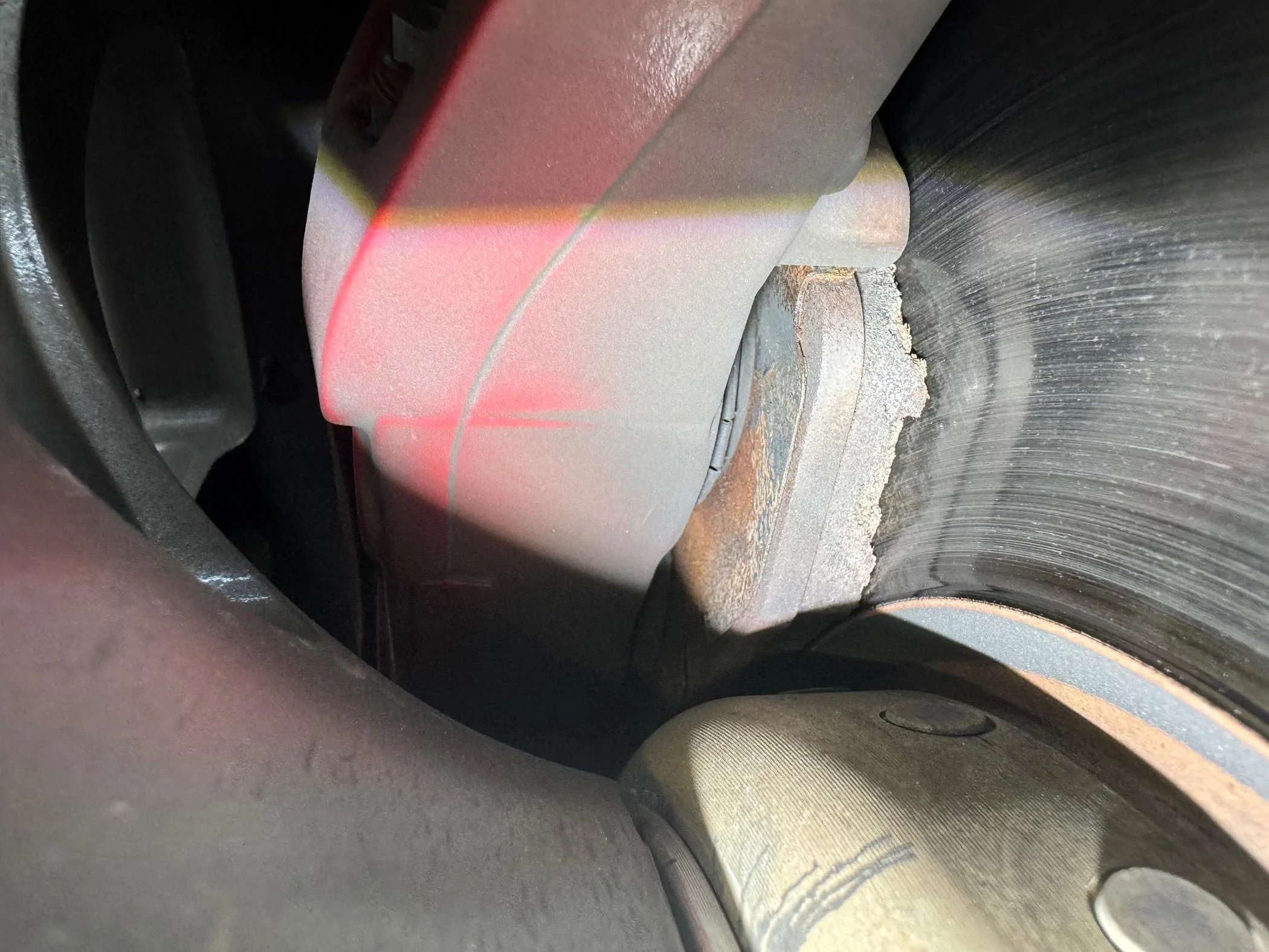

After a case of severe laziness, I finally put some effort towards the Supra this weekend - pulling the front pads and rotors off the car. I'm running CSG pads at all 4 corners, and these had about 10K miles of use that included 2 OneLaps and a couple of track days thrown in there for good measure. At a glance, the outside pads looked great, with about 1/2 the pad material left. In previous lives, I learned the inside pad often tells stories you weren't expecting, and it was true again.
The pass side inside pad had significantly less friction material than any of the other 3 pads. I think it's just a function of the tracks I drove and working the pass side brakes more than the drivers side - not a caliper dragging issue. All the pads are still usable for at least 1 more track weekend. I'll swap the pads left to right and put the more worn pad on the outside. (@razorlab...yeah, yeah, I know...PMu Club Racers are my next pad, ordered them today)
The rotors had some heat checking(nothing to worry about), but there was a defined lip between the unswept outer part of the rotor face and the swept area. They definitely failed the "does your thumbnail catch the edge" test. Anecdotally, I'd read here that the CSGs eat rotors, but I can confirm it. That was a LOT more rotor wear than I was expecting, even with all the street miles. FCP Euro warranty to the rescue.
