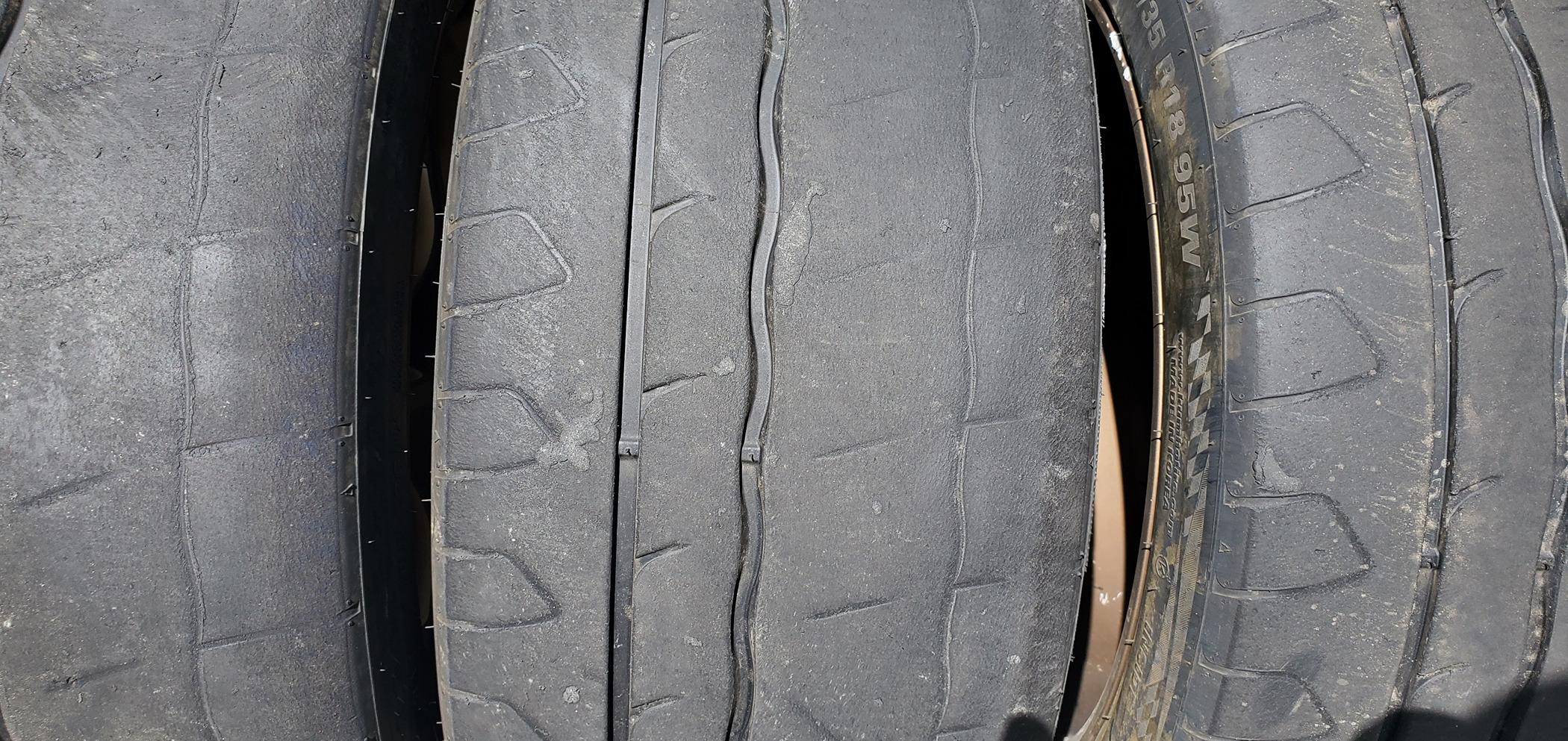

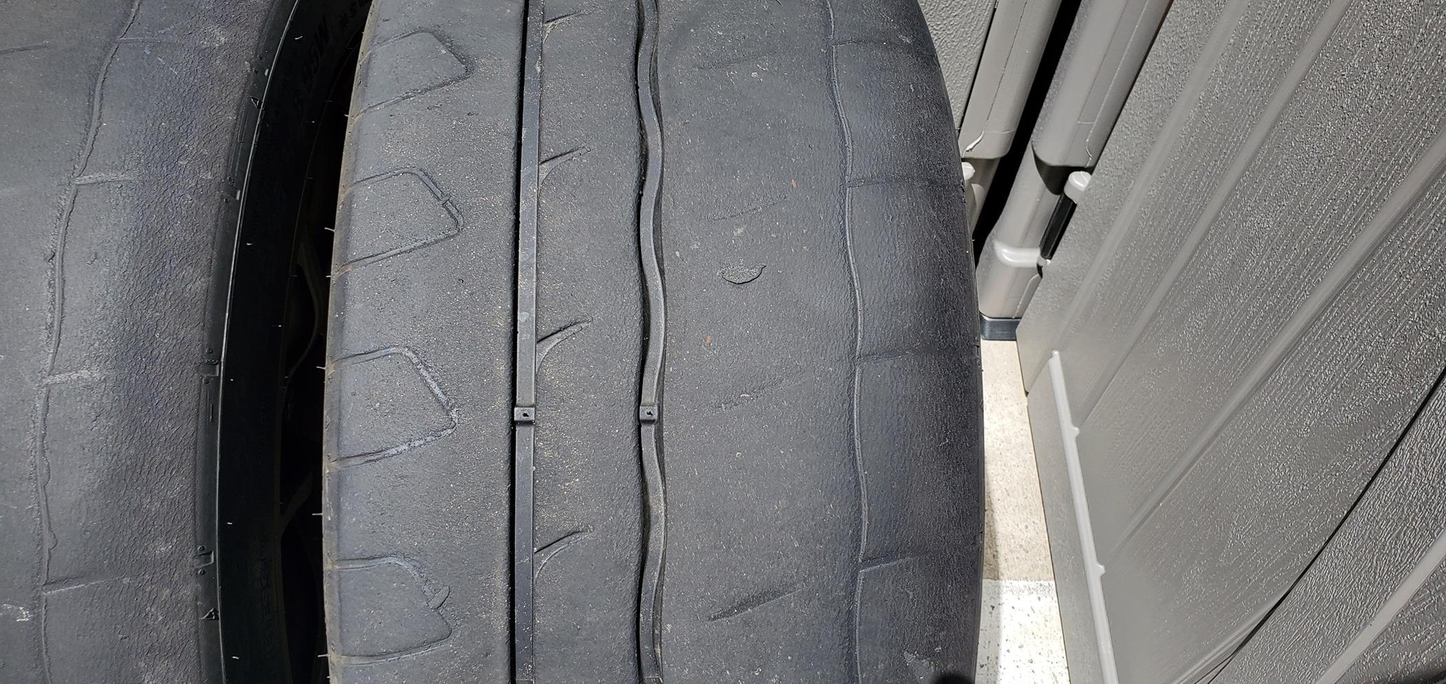

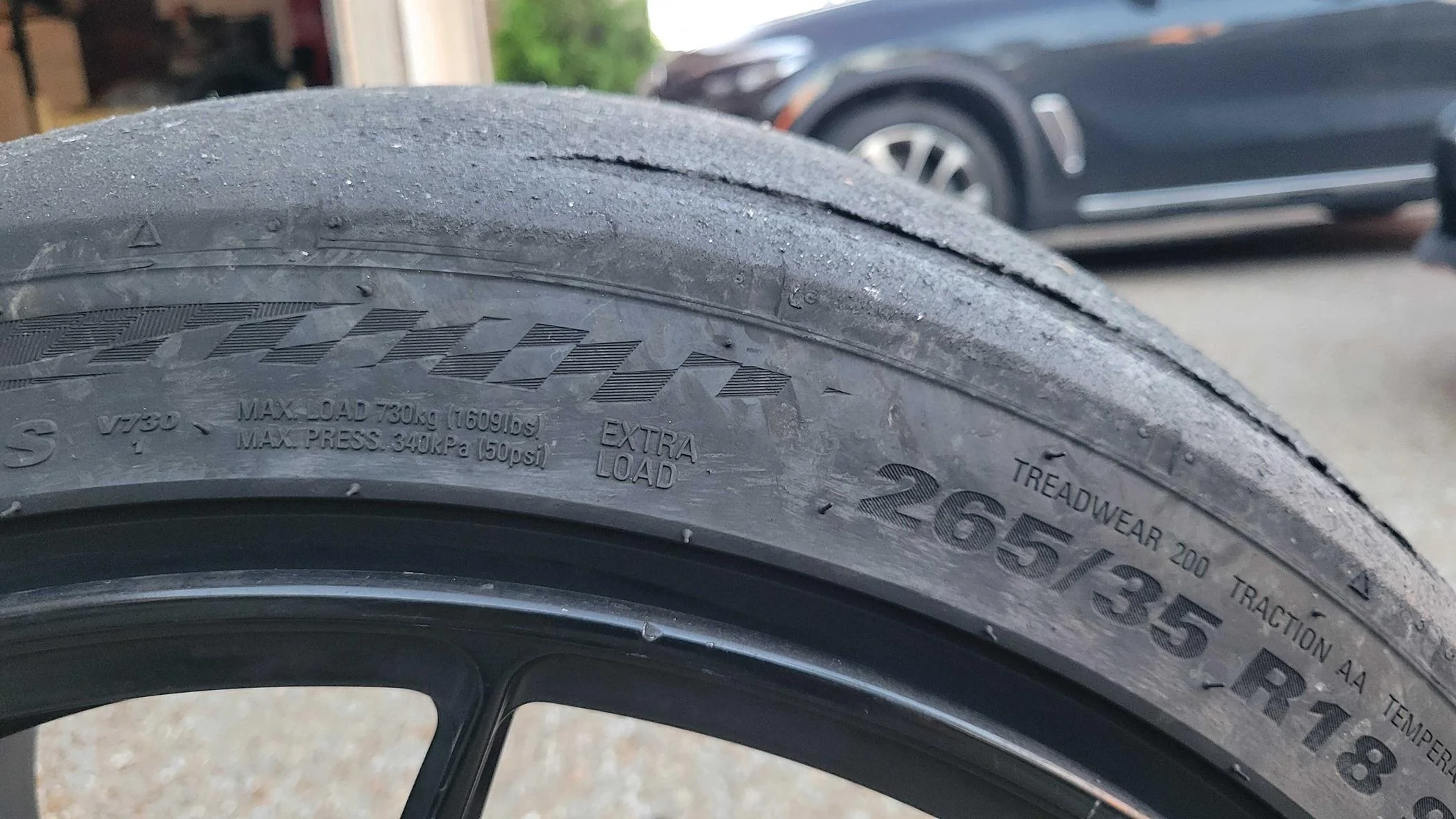

Teach me to read this tire wear. I'm stock, so camber is what it is for now. PSI too high, I'm guessing? I kept lowering it session after session. Total wear is from 5 days of HPDE. I swapped opposite corners each day. Kumho v730.

Show us a side view so we can see how far down the sidewall it's been worn. With stock camber I adjust my PSI based on that. What PSI are you running?
I'm running the same ones on my front and tend to start at 26-28 PSI on an ambient temp day around 70-80 degrees which puts my hotlap around 30-32 before ballooning on the later laps which I don't really care about since they're not really ever going to be PBs anyway.

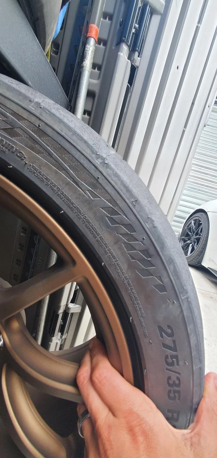

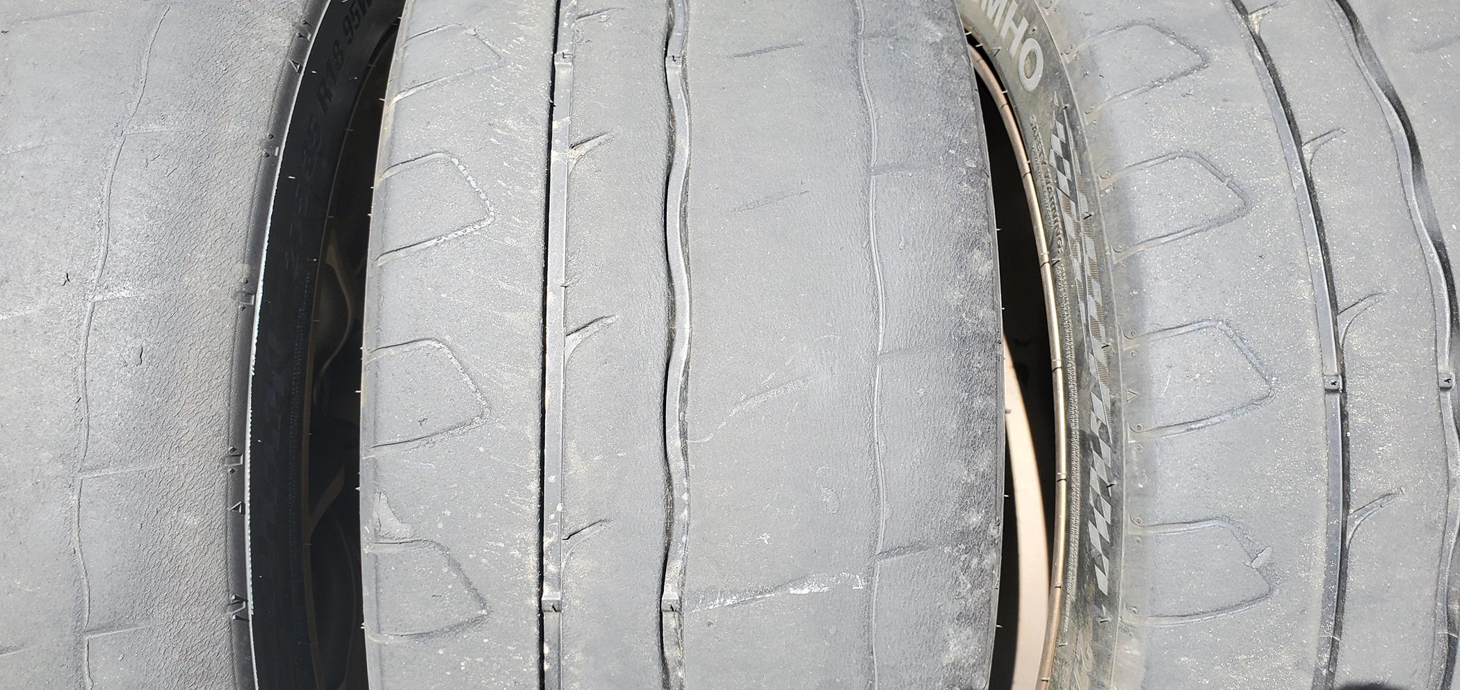

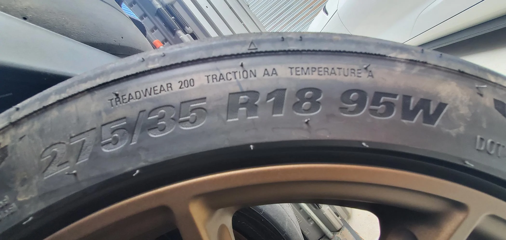

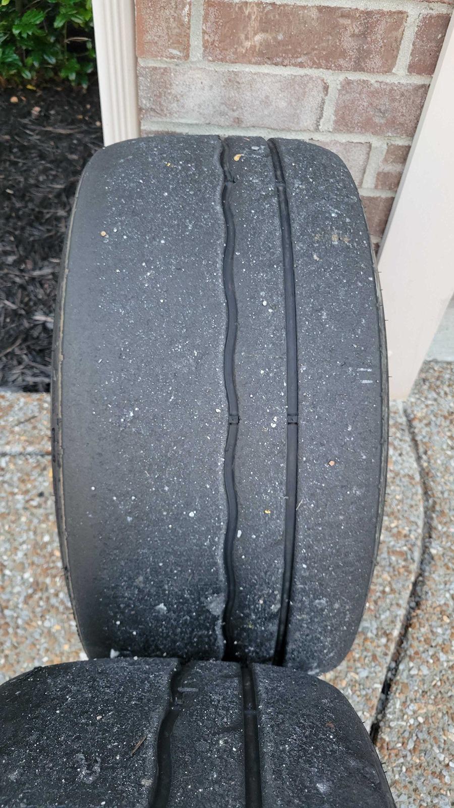

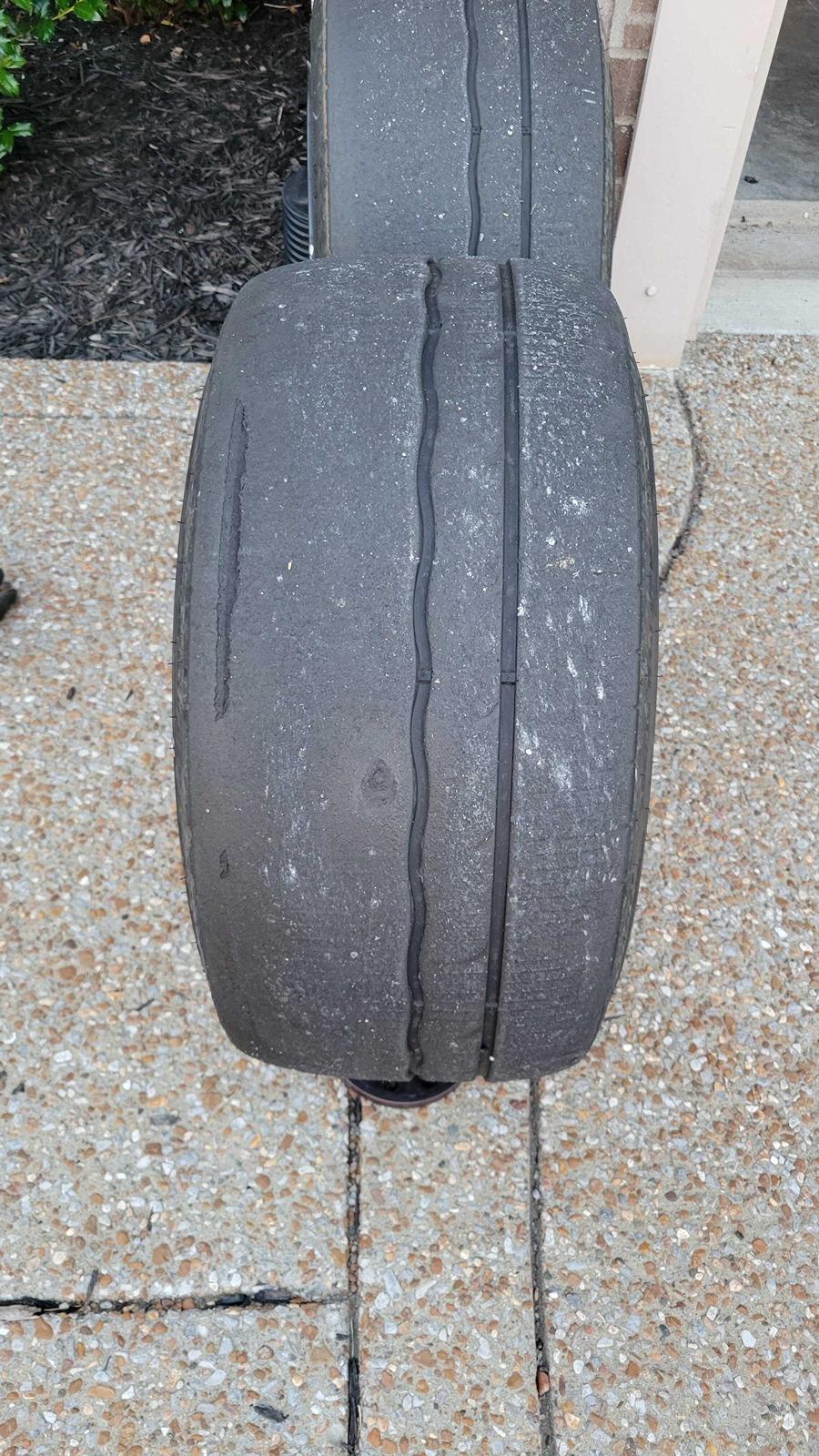

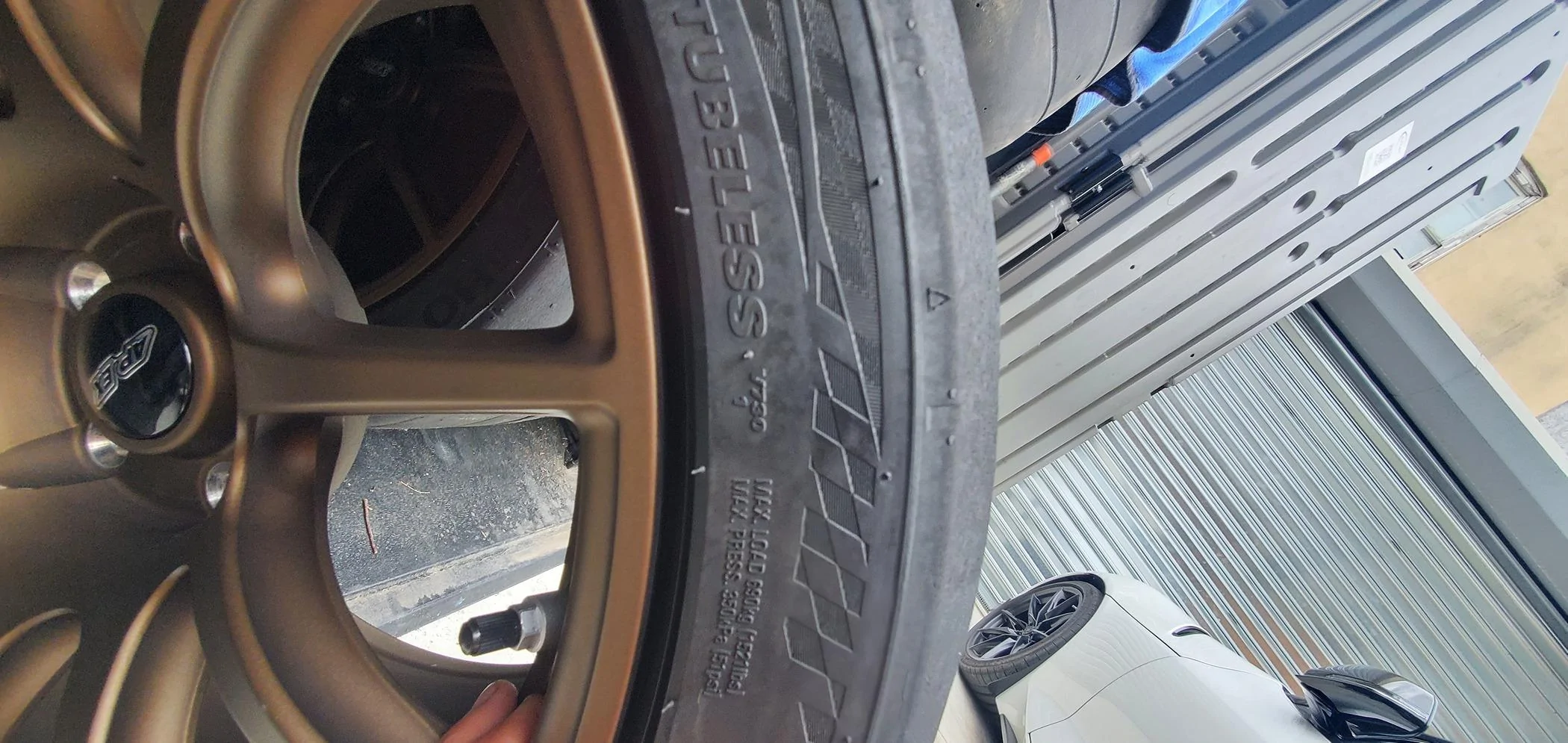

Side views below. I was starting around.....32 cold at the beginning, and then about 29 'warm' right before going out for a session by the end. I should have kept better notes. I keep the display on pressure/temps, too bad i deleted my go pro footage already.

The wear pattern is right on the top of the triangle and the two little dots that are to the right and left are nubs instead of still being pokey so you're just about right. Nothing more you can do besides add camber eventually so keep doing what you're doing. You could try dropping 1-2 more PSI but honestly it probably won't make much of a difference and seat time and track/weather conditions will make more of a difference over 1-2 PSI.

This is typical characteristic of v730. On my race car, even with -4.0 camber, there were no groove left outside after a day of driving. there were plenty of groove inside so it was a mystery. However, after looking at every car that uses v730, it yielded same pattern. smooth outside, no wear inside no matter what camber or car. increasing pressure helps a little but not whole lot of difference. the running theory at the moment is because side wall flexes so tire is skewed to outward hence increasing pressure helps side wall to stay in shape just a little bit. v730 is good tire for money and I will use it again for my race car, btw.

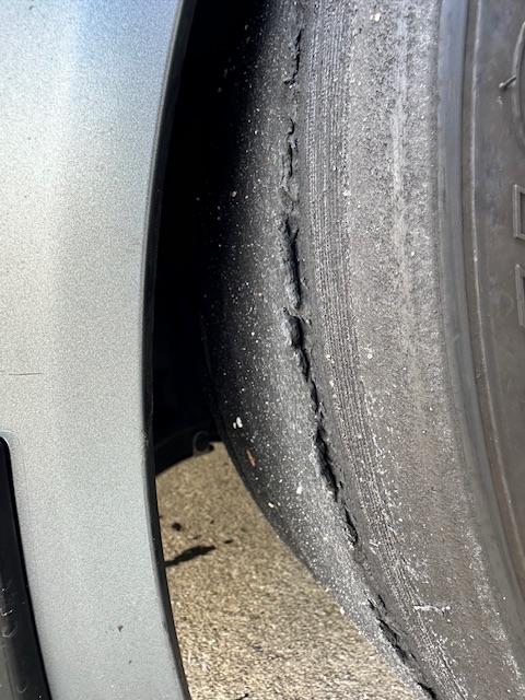

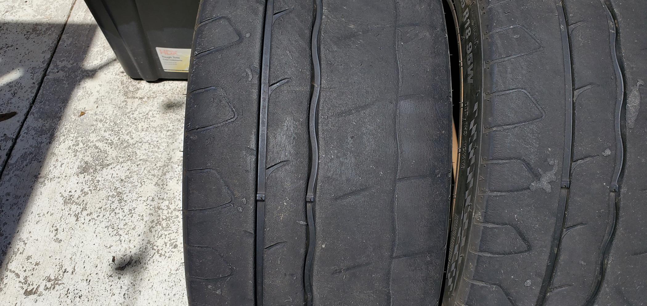

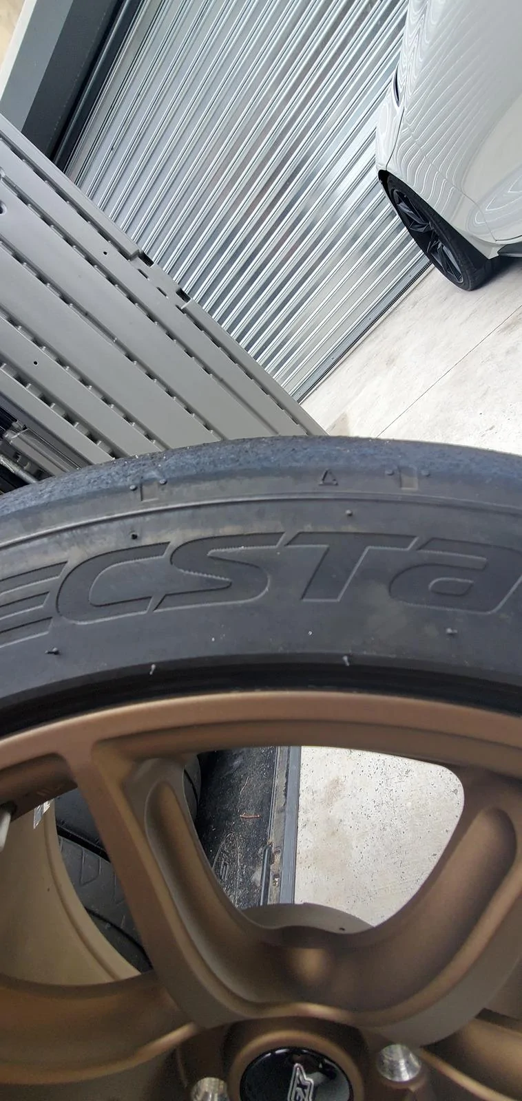

Just finished mine off this past weekend so for reference, here are my fronts after 8 track days (4 sessions per day) and I'll need to replace them before next event since one is now corded. Plenty of inside tread depth left.

More negative camber.
*(side note: bleed tire pressure down -36psi or less- as the day goes on when driving HPDE. And…. don’t ? lower the car until you get rub ?)*

It’s actually how the v730 is molded. If you look at a brand new one, the outside half has grooves that are molded about half way deep compared to the deeper inside grooves. This is so the outside wears to a slick faster. Still way more tread to go after the grooves go away. People, like yourself, commonly think it’s a camber issue, when it’s actually the tire design.
“Mystery” solved.

Did you rotate them at all? ^^^
Yes I rotated them after every two sessions. Only time I didn't was this last weekend when they put 1 early session and the next 2 sessions only had a 20 minute break between them. At the end of the day it had very slight chunking but no cords, so for Sunday I put that tire on the passenger side since it was a clockwise track. Checked the tires after every session there on out and didn't hit cords until the last session.
