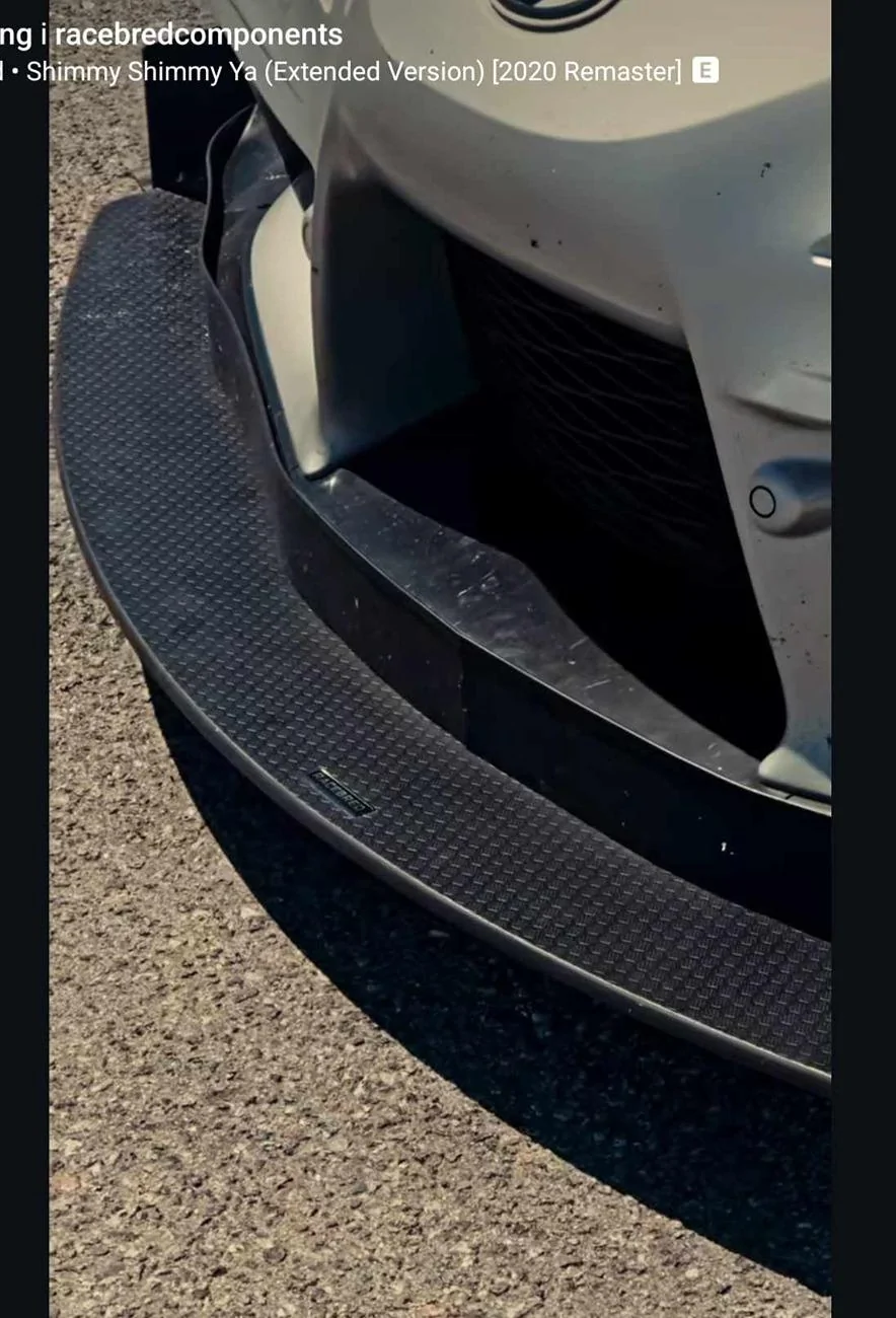

There is new splitter in the works from Racebred, tunneled, with variable widths aviable, with optional endplates, with some df charts provied. Said to be couple more weeks away.
Man that looks nice! I‘d break that sucker so quick on track. Do they make those in tear off versions? ?

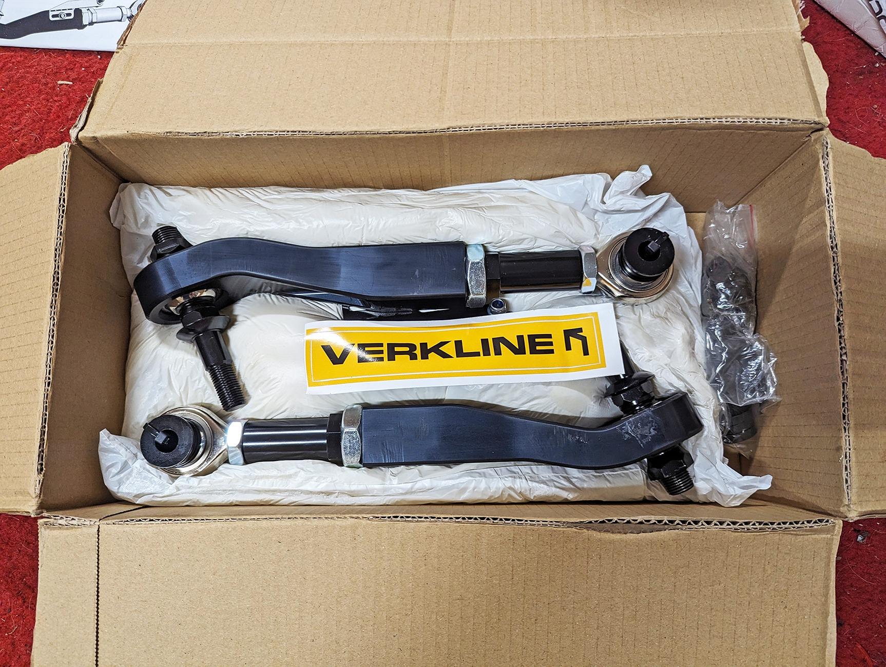

RE: Verkline -- I ordered these last week and they're going on today. MUCH beefier than the SPL arms I had on my previous Supra. They're currently showing 2 in stock.

I have a set still in box beside me...haven't opened them yet. Thanks for sharing. I'm liking the decision to go Verlkine more and more.

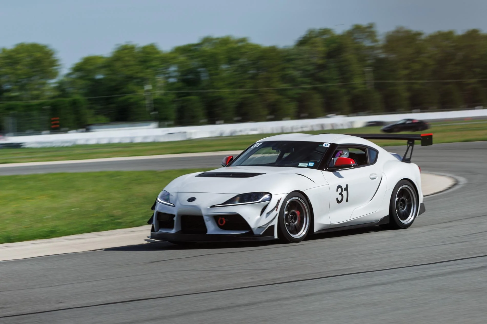

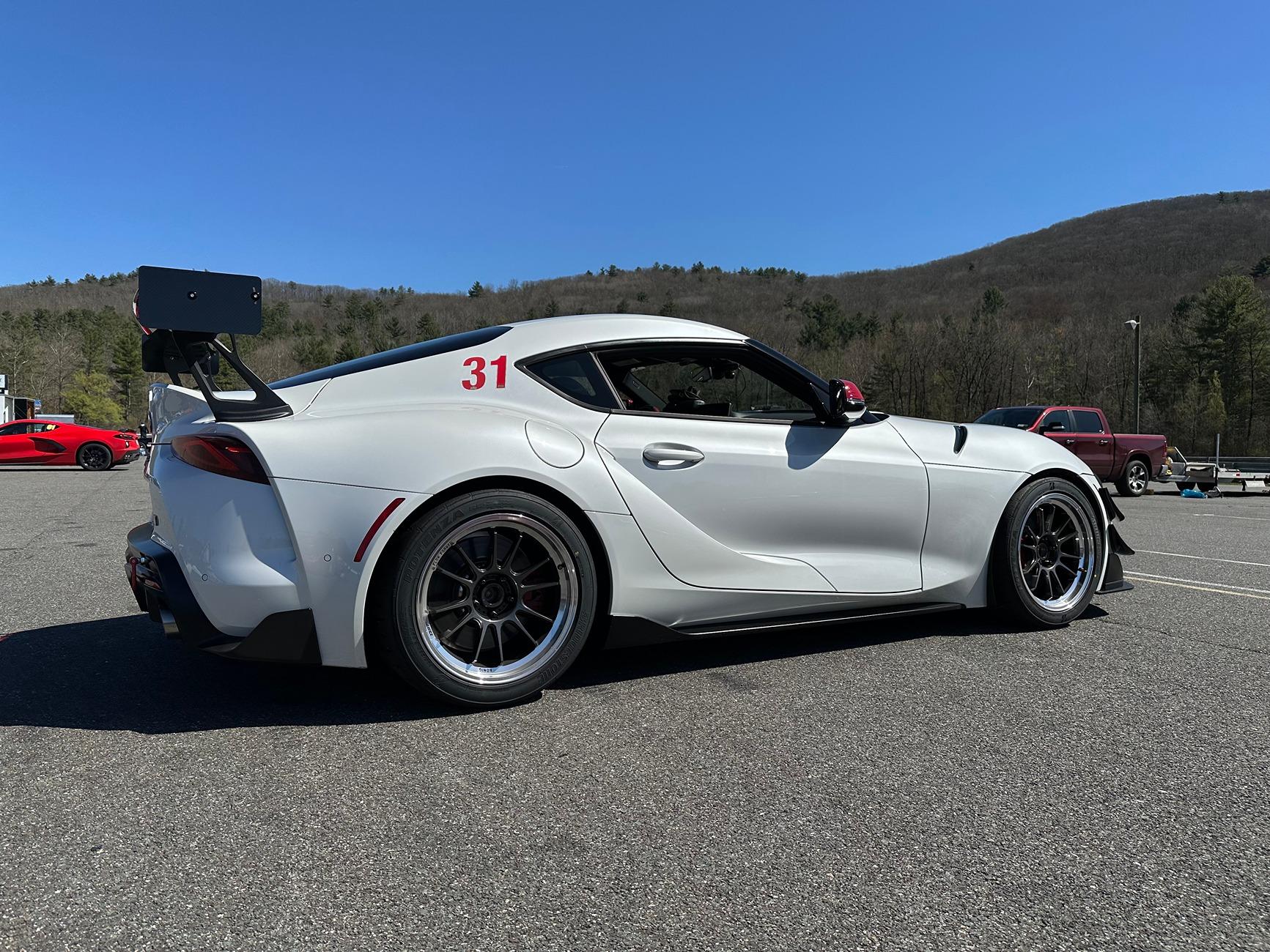

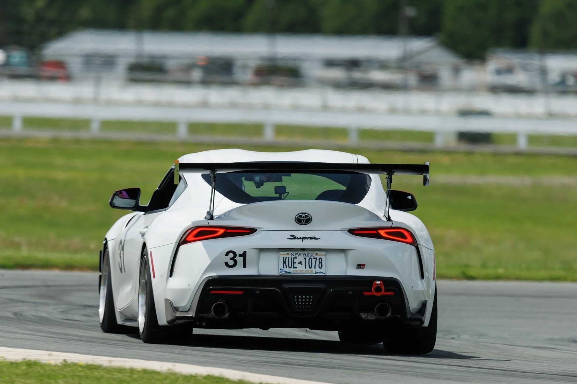

Yes 18x11 +40 works without spacers with coilovers. I would suggest a 35 in a 295. 40 gets a little tall. You can run 30 too, I just found to have less forward accel traction and the gearing gets a little weird depending on the track.
Sway bars are going to be setup and personal preference. If you look them as a tuning aid, and not a main modifier then you are off to a good start.
18x11 +40 with 295/35/18 RE71RS on my supra for reference:
Who here gets happy when Bryan posts pics of his car :-D. I'm seriously considering a set of those same 18x11 Hypergrams for my car as I am doing some other upgrades (coilovers, LCAs). I'd need to do some horse trading to make it happen, though.
