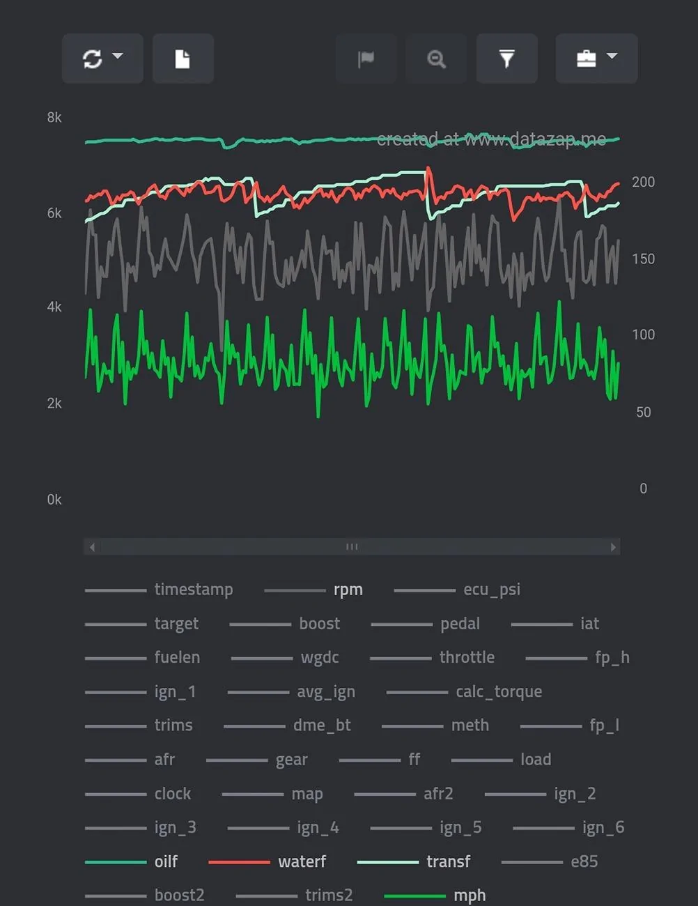

ran 7 sessions at gingerman yesterday, noticed that the trans cooler (pump? fan?) is pretty lazy and would only kick on once every ~5 minutes but that would be enough to bring it WAY down.
does anyone know if this can be controlled via custom trans tune or bm3/mhd? Upgrading the pan or the heat exchanger seems unnecessary if all we need is a software change.

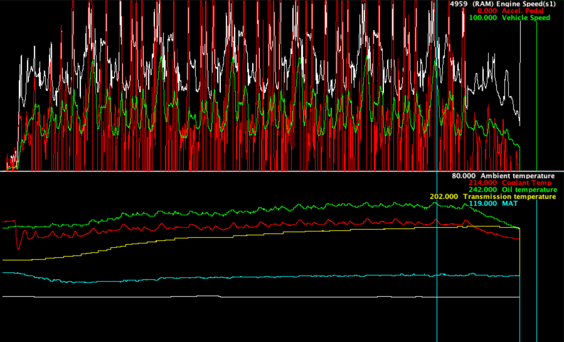

8,689
17,035
Looks like you are logging the wrong item. What are you using to log?
i3igpete
May 16, 2022
46
1,306
1,574
Chicago
2023 3.0L 8AT
using whatever the autologger for jb4 is. can you share what the dataset looks like on bm3? i wonder what "transf" actually is, then.
8,689
17,035

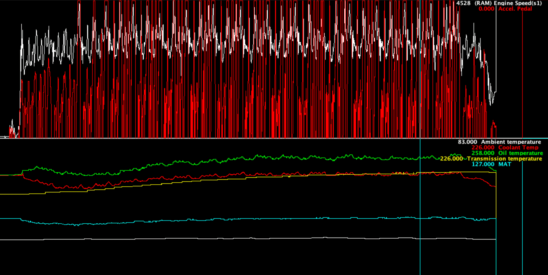

It almost looks like it could be radiator fan duty/speed or something.
Trans temp is a gradual increase through the session. Here are two BM3 logs. This also mirrors what I see when I log the straight CAN trans temp ID#

Chicago
2023 3.0L 8AT
Hmmm looking through the jb4 forums it looks like it could possibly be the (hotside) of the intercooler loop. Seems plausible, but the behavior still seems weird.
