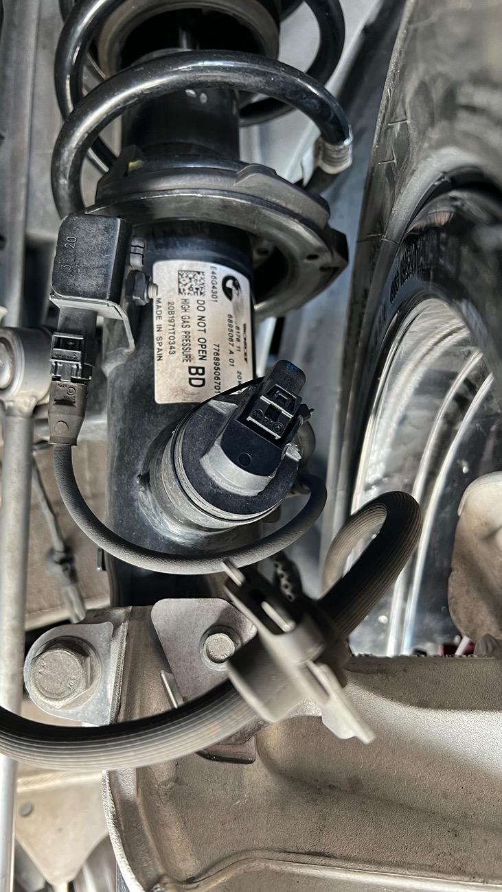

Here are the fresh 275/35-19 RE71RS on the front 19x9.0 wheels. There are ~3-4mm of clearance between the front tire and lower spring perch with standard offset wheels and no spacers. I’ve run tires with less clearance successfully on a McPherson front suspension because the clearance between the tire and suspension will not change during compression or droop.
