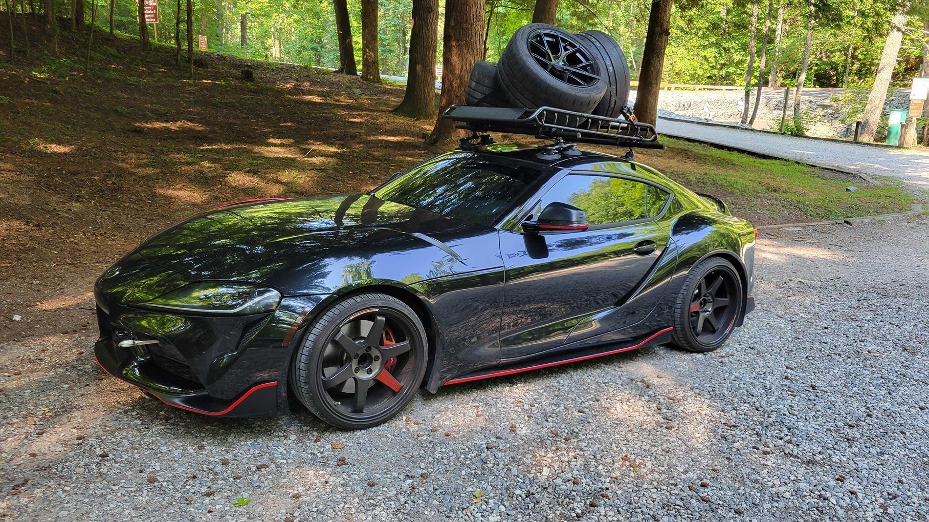

Has anyone here tried transporting a set of wheels on the roof with something like the seasucker roof rack?
