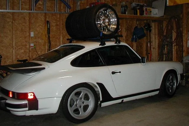

Has anyone here tried transporting a set of wheels on the roof with something like the seasucker roof rack?
Yeah it worked great, it's best transported on flat driving routes and avoid curvy mountain roads. Only thing you'll really notice is reduced MPG due to the extra drag. @Suggs.OR was running Seasuckers + a Thule Box for a while just for standard storage. The box wouldn't work for tire transport so you'd need a rack like in the picture of mine. I ran 3 wheels up top and one in the trunk. Might be a little better if you can squeeze two in the trunk and 2 up top.
I've got my bars for sale if interested. Possibly my rack by unsure about that one, with shipping cost might make more sense to just get a new one on amazon. This is the one I ordered: https://www.amazon.com/gp/product/B073G49NPV. I don't need them anymore since I fabbed up a trailer hitch plus I have now moved on to a full on car hauler.

I loved it with the roof box. Don’t think I would drive with tires though.

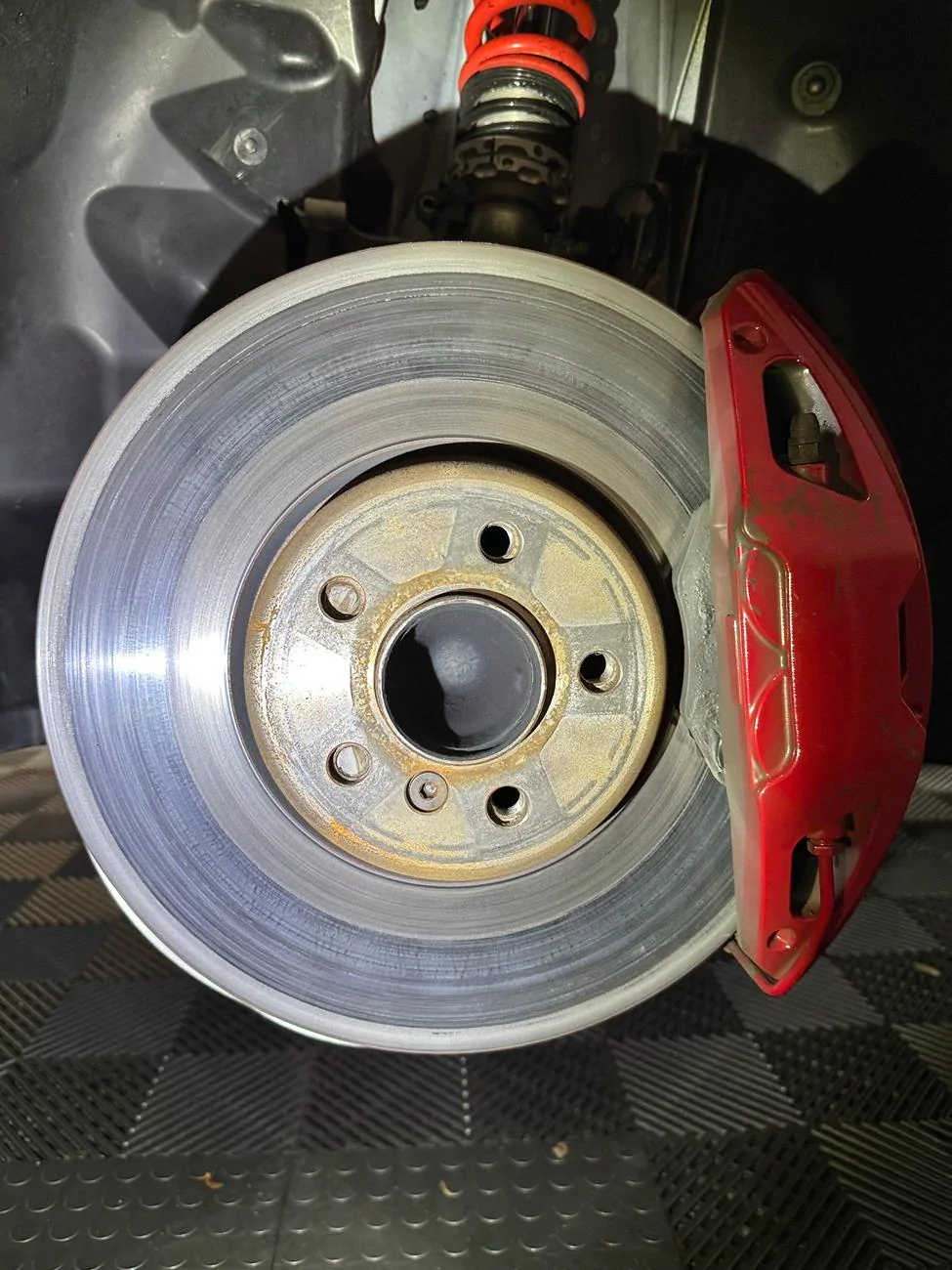

Finally got to test out the DTC 60/30 combo compared to the PMUs. I like the DTCs better. I feel like they handled the heat better. Pedal feel and bite is better as well. Got the fronts hot enough to melt the paint off the pads and experience no fade or odd pedal travel. Also to note, I felt like I hit ABS a lot less than the PMUs. Brake dust was absolutely terrible after bedding them in but after a day on the track, I would say its the same as the PMU. The best part, my brake shutter is completely gone now!

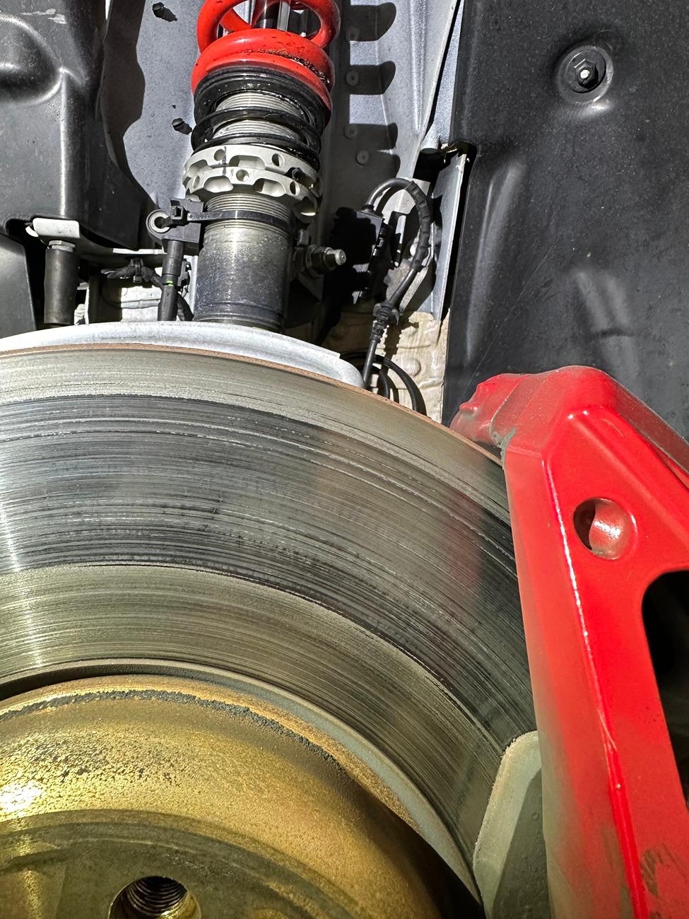

Argh, not very encouraging for my vibration issues :(
Might be time to pop your rotors off. When I installed the new pads, I took a wire wheel on a drill to each rotor to remove the old compound. Would be worth a try for you, then bed them in again.

Glad the DTC60's are working for the stock power crowd. I def won't be using them again. Smear all over my rotors from over heating. Can't handle the extra power I guess. :p

I've been waiting to see if anyone else said anything and I'm having the same issue as you with my Club Racers. They were put on fresh rotors and I feel like I bedded them in very well. My first track day with them was exactly as you're describing. On normal street driving and autocross I have no vibration. I'll be at the track this weekend to see if the same thing occurs again or not. Roebling won't be as hard on my brakes as Road Atlanta was. I feel like it's probably an issue when the pad hits the top end of the heat spectrum.

I'll be at the track Friday for a full day as well, please report back and I'll do the same.
If I can't get on top of the issue quickly, I might try the Endless ME20 next year.

I just did a track day at Sebring with a new set of club racers on used rotors and was getting some crazy vibrations. As the sessions went on the vibrations would show up later and be less intense. I also felt like I bedded them in pretty well before the track weekend. I guess they are just sensitive to the older pad deposits like Bryan was saying.
Will probably just replace both the pads and rotors if I still have the vibrations after my next track day.

Bryan is usually right. I did low grit sandpaper one older set and that helped. But didn't get much from the rotors after that. Started to show a lip. So, I'm back to just buying a new set of front rotors when it's time. The rear just doesn't need changing nearly as often. Hence buy rotors when they get new pads as well.
