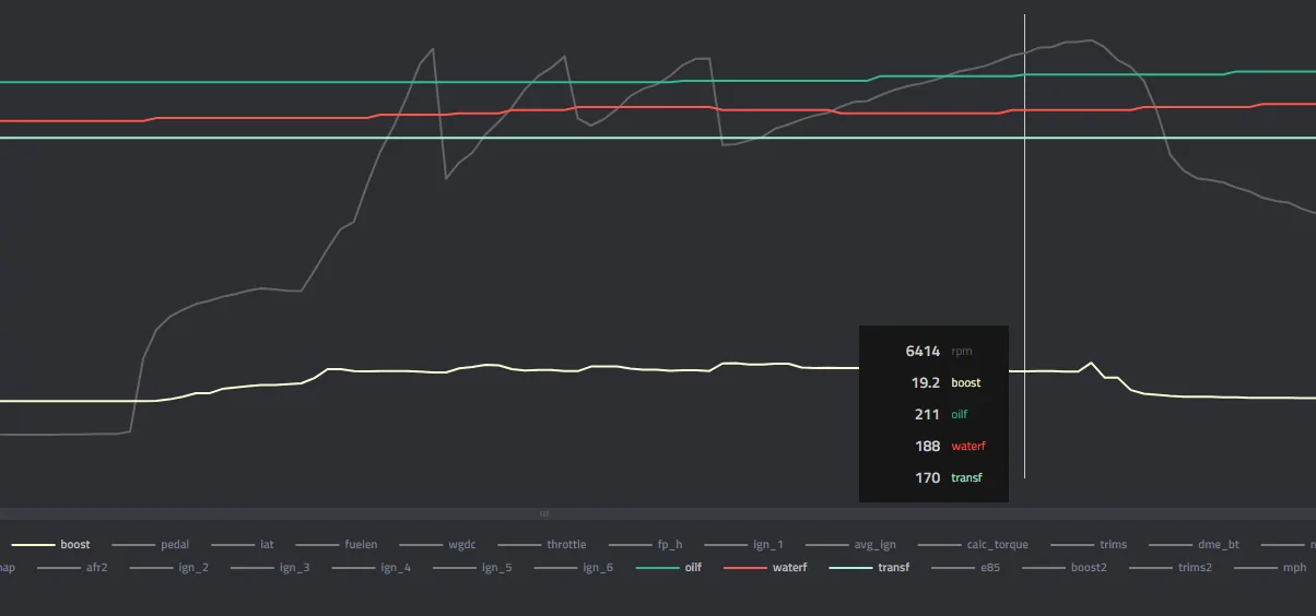

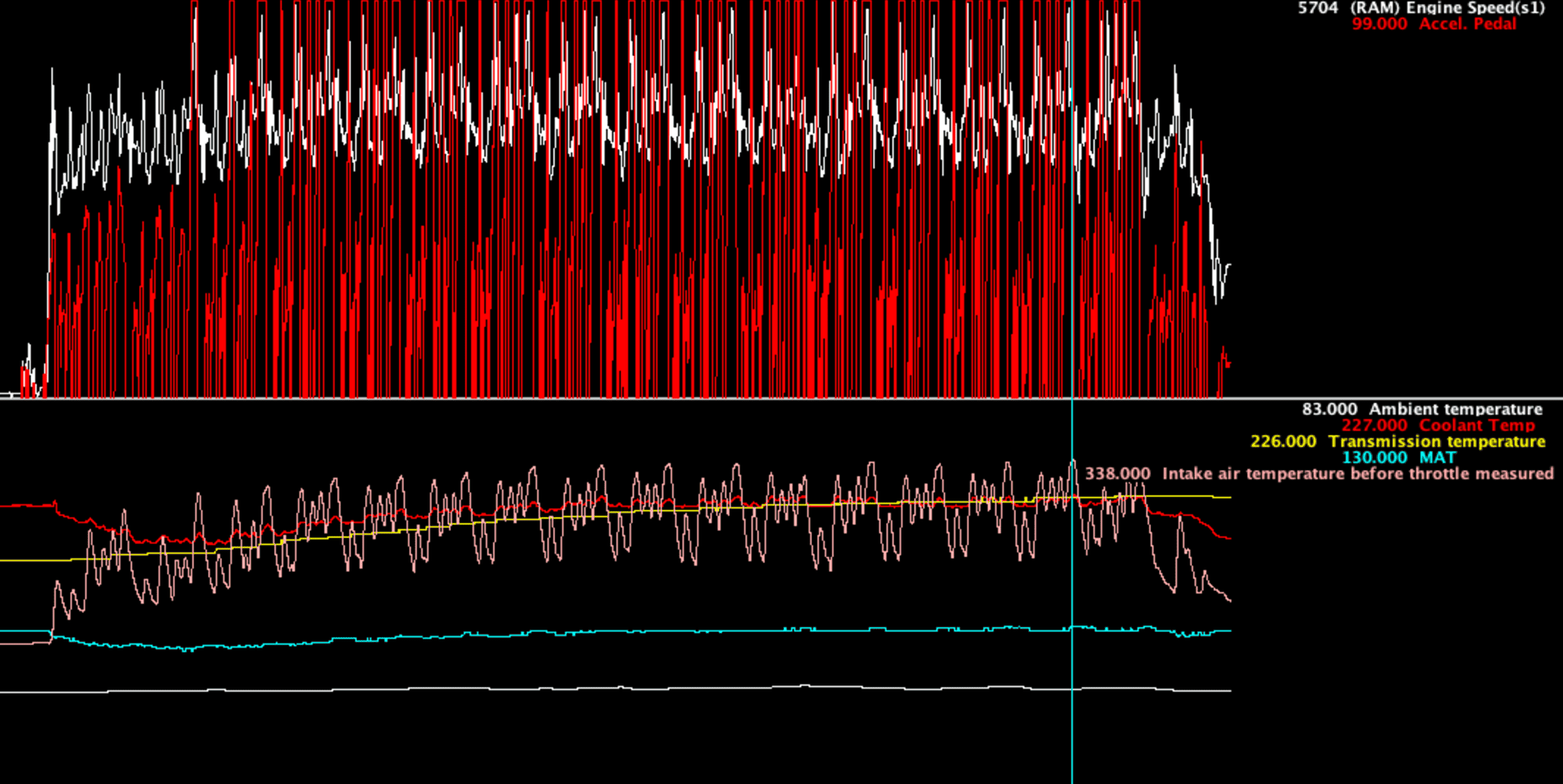

using whatever the autologger for jb4 is. can you share what the dataset looks like on bm3? i wonder what "transf" actually is, then.
transf was actual transmission temp when I ran a JB4 a few years ago. Maybe it's changed in a later firmware?

Hmmm looking through the jb4 forums it looks like it could possibly be the (hotside) of the intercooler loop. Seems plausible, but the behavior still seems weird.
Pre intercooler charge temp? Or the actual hot water side of the intercooler? I would hope it cycles faster than that. ;)
Charge temp before intercooler looks like:

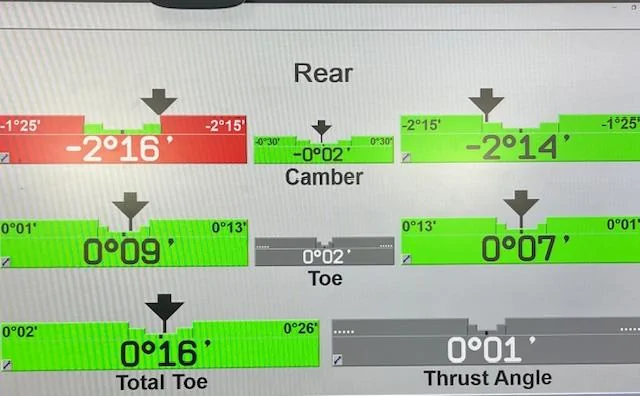

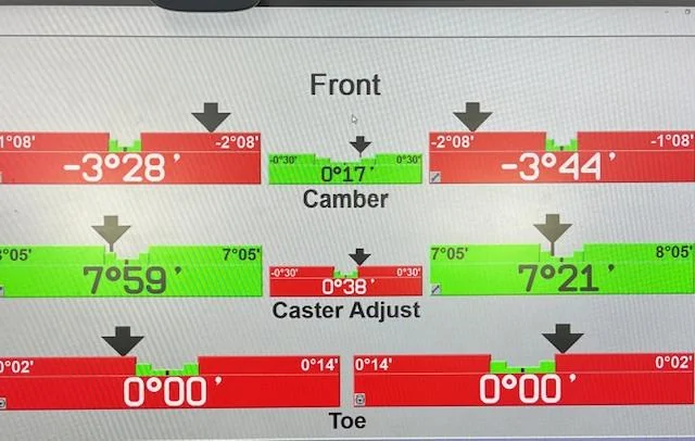

Unsure what all else would be "needed" vs "nice to have" in terms of aftermarket arms and achieving a track alignment on this platform.
I'm still running all stock suspensions arms/bushings and was able to get the alignment specs I wanted with just front camber plates.
I'm sure some of the aftermarket arms are "nice to have" if installed and set up properly but I haven't felt the need after a few years of tracking the car.

Thanks. What alignment specs are you running? I’ll be getting camber plates by default when going to coilovers but am not sure if LCA or tie rod ends are needed to achieve -3.0 to -3.5 front.
If it helps, I started at -2.5 & wore the shit out of the outer tires. Got plates and up to -3ish. Then andded adjustable LCAs with 10mm spacers to where I’m at now. Somewhere around -3.6 at stock height. I’ll still wear the outside of my tires 1st. But it takes longer and she noticeably corners better on track.
I drive all year keeping the same alignment. Bottom line, the max you can get up front without hitting anything.
I think it depends on ride height but I got 3.5 (the above sheet is in degrees and minutes) with just the plates.
