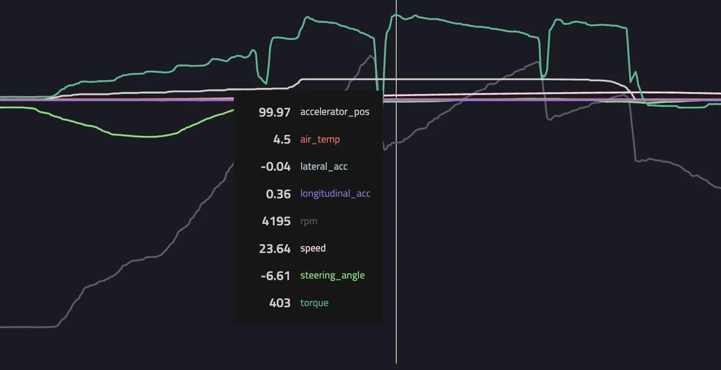

For the peeps that want to log CAN data at 50hz+ (like brake pressure, steering angle, etc) but don't have/want a full AIM or Racecapture setup but have a phone/tablet... We are working on something super cool.
Everything is working, we just need to do a little more testing. After that, expect a full writeup here!
