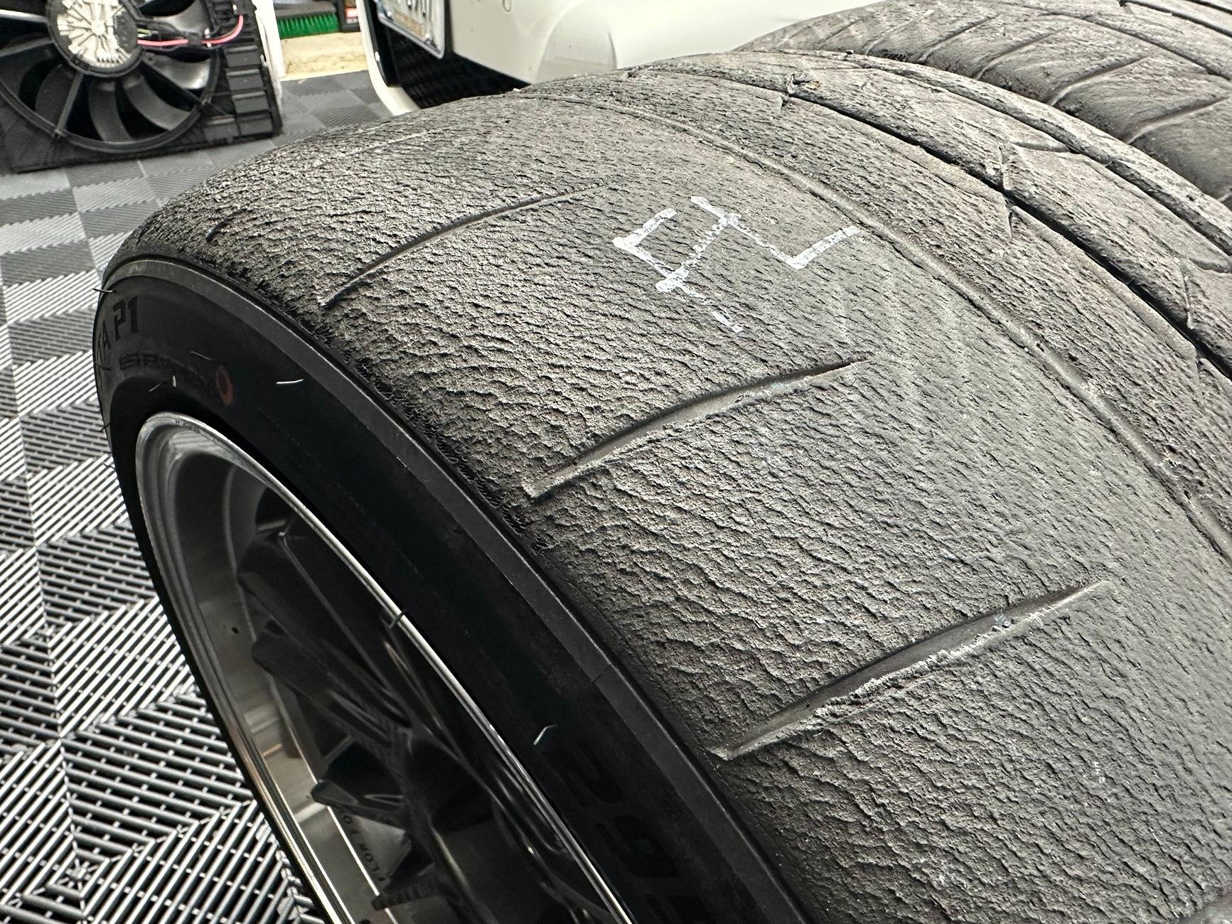

Tried out the Vitour P1's last week on track that have a bunch of hype surrounding them.
295/30/18 on 18x11
Two days at Lime Rock Park. 1st session was cool, about low 50F ambient and holy crap are these things hockey pucks when not scrubbed in and zero heat in them. I've actually never experienced a 200tw that are like this. I ended up going four wheels off on the fourth lap from terminal understeer, then snap oversteer. I wasn't even driving the car hard yet.
Second session I was able to get within .10 of my PB that was done on RE71RS. Here is a video of that lap:
However... after that lap, and every session after that the tires were consistently 1 sec slower no matter what pressures I used and how I drove the car. The second day, even after rotating the tires, it was the same story, however I drove the car in anger during the last session because I was pissed the tires got so slow and while I was still not close to my PB I was able to get within about .50 of my PB, but I had to really overdrive the car and work for it. I could also tell the tires weren't happy being driven like that, and they were VERY vocal about it.
Overall, not very impressed, especially given their quick falloff. They also seem to not like multi-tasking at all. RE71RS are MUCH better at that. I'll be going back to RE71RS after these.
Here is Vitour P1 wear after the first day and approx 55 laps. Keep in mind Lime Rock is 95% right turns so the drivers front tire gets a beating. I'll take photos of the wear after two days sometime this week.

Great review thanks for posting that. I've heard similar things. Maybe in the same group as Hoosier Track Attack for most over-hyped tires?
8,659
16,977
With the hype that Dallas and others have been creating on the Vitour FB group I half expected these to drop my lap times by 10 secs and last for two years. Neither of which came true, in fact they reminded me more of v730's (but with a bit more pace) that are about $700 less.
The one thing I did really like about them are the stiff sidewalls. Great steering response.

If you take them out for another day, dial in ~30% more compression then you do for re-71s and see if you like them more.
Agree the 71s are an easier tire to work with in wider conditions, and on the heat. The vitours need a ton of compression damping to perform well (why? idk. probably the stiff carcasses).
I did and they got even worse, especially under braking. The front started skittering around even more under lateral load as well.
The fact they completely changed after one “fast” lap makes me think they are a cheap under developed tire with a very vocal marketing person (Dallas) over inflating their actual performance.

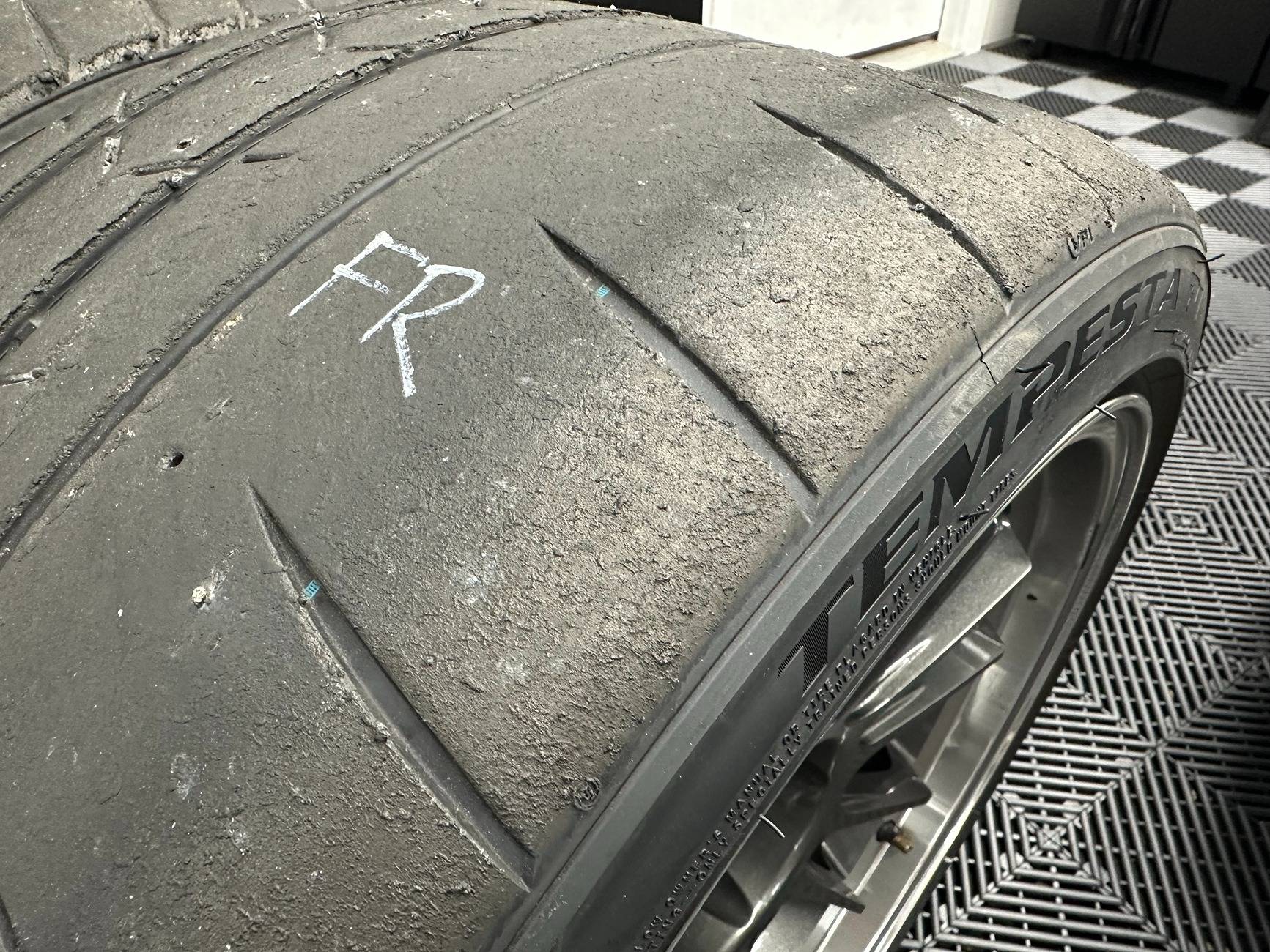

How much life on average have you guys been able to get out of the RE-71RS?
I have a pretty weird use case, and I've been through 3 sets in the last 2 years, so YMMV.
Set 1: 2 HPDE days, 14 3-lap time trials, 3 autox runs, 4K miles of street driving. These were absolutely done and treacherous in the rain
Set #2: 5 HPDE days, 3K miles of street driving. These had about 30% life left on them when I pulled them off the car
Set #3: 14 3-lap time trials, 3 autox runs, 2900 miles of street driving. These are on the car now, I'd say they're about 30% left as well.
8,659
16,977
Going to depend on driver, car setup, tracks, etc.

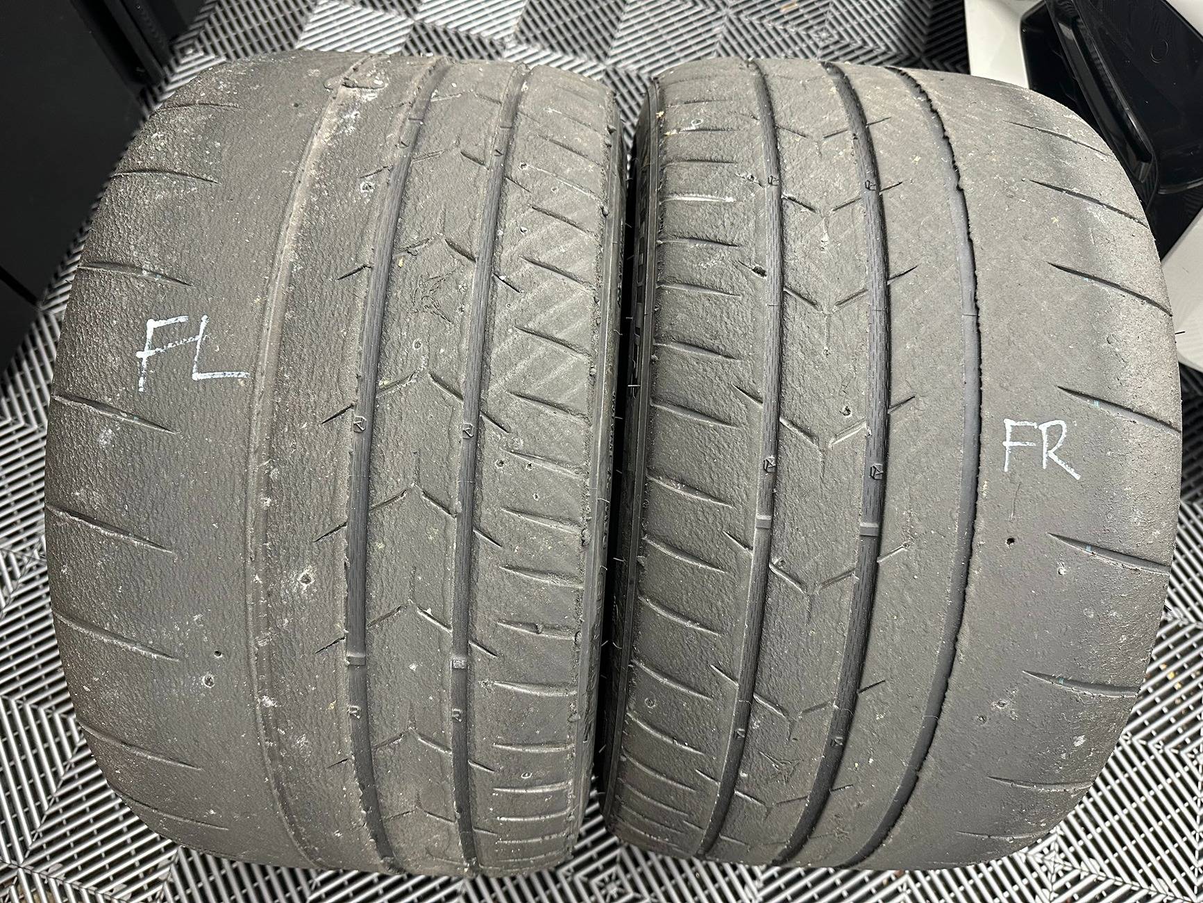

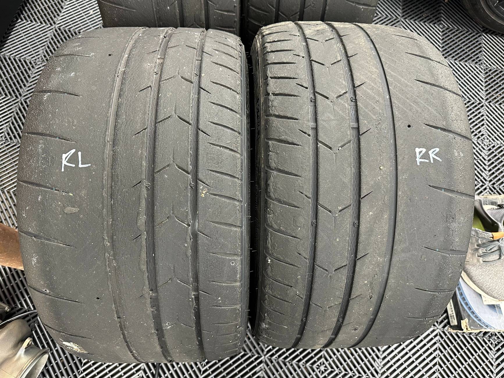

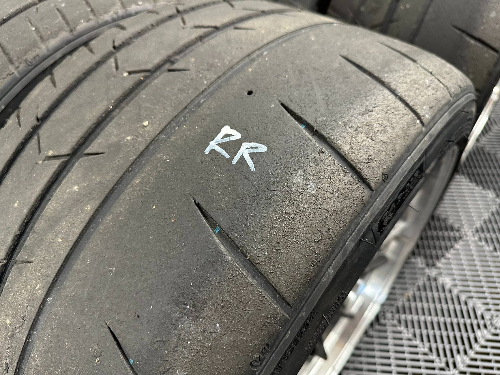

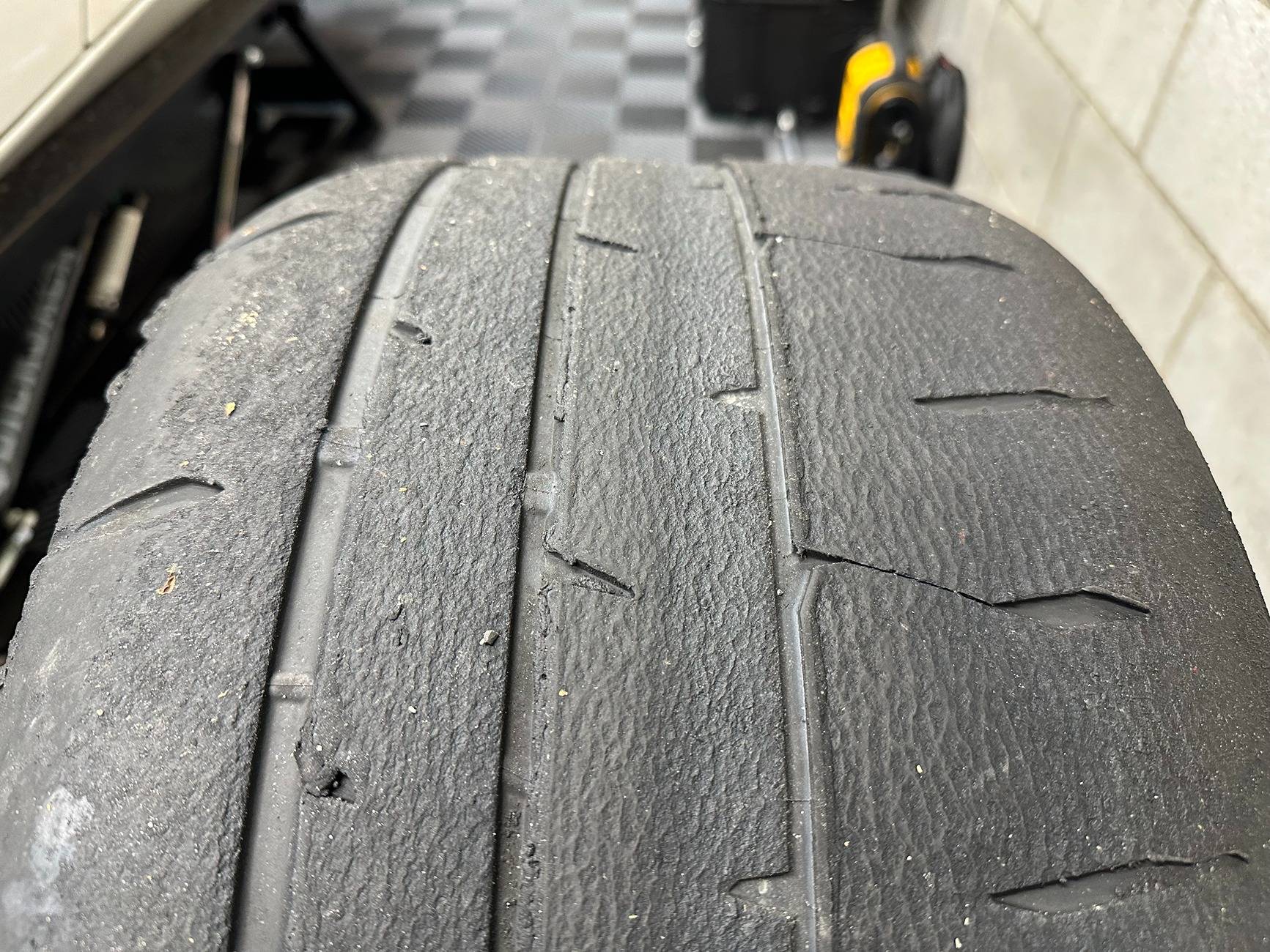

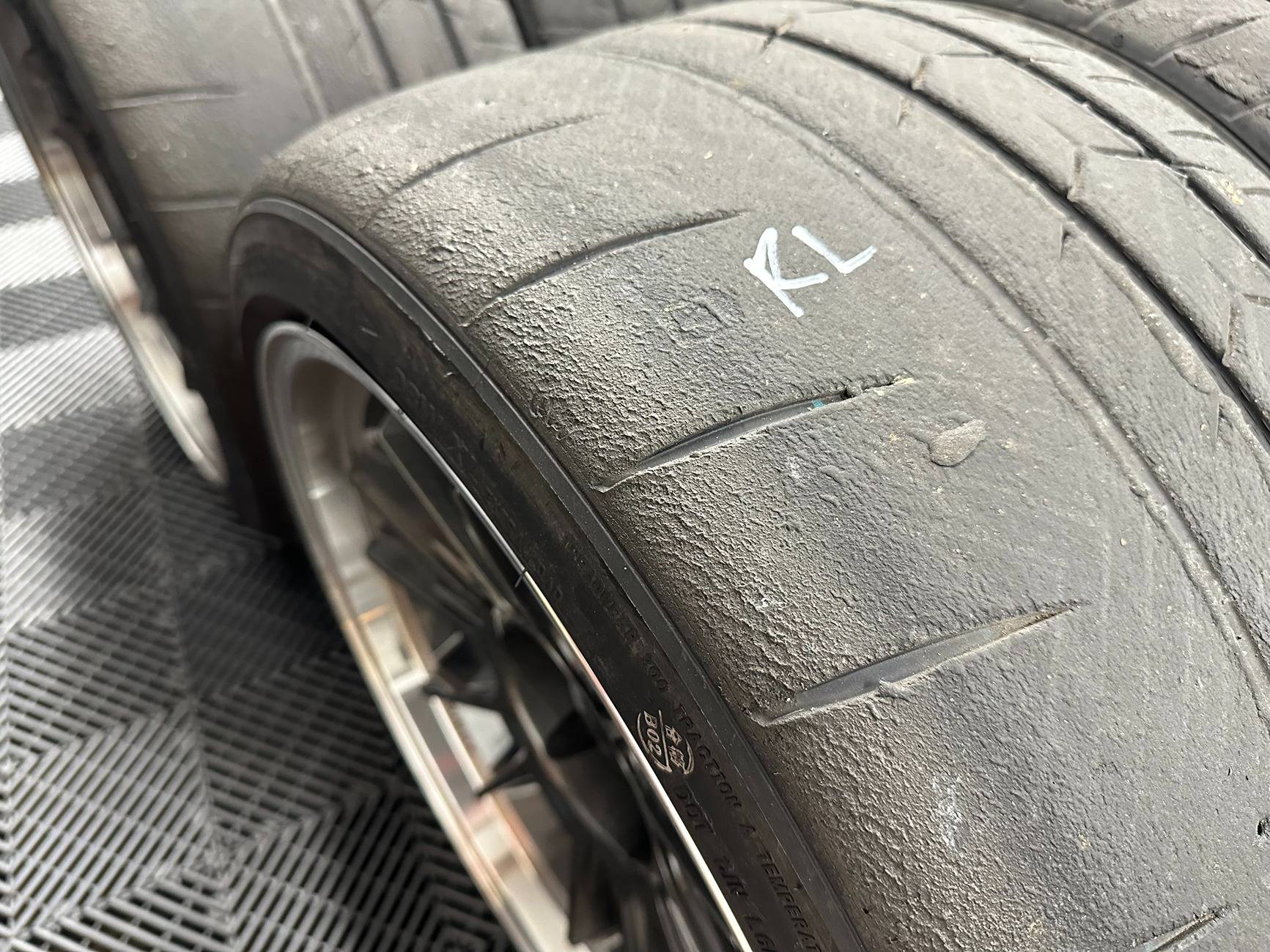

For me, they drop in pace long before they cord. I get about 4-5 track days out of them (full track days with 40+ laps, not time attack 3 glory laps), before they drop in pace. Usually about 4 solid days at relatively same lap time pace. For just normal lapping days where you don't care about PB's, I can see using them until they cord. They only get slower, they don't drop off a grip cliff and become liabilities like the Nankang CRS can do.
This is usually what mine end up looking like day 4-5 before I replace them:
