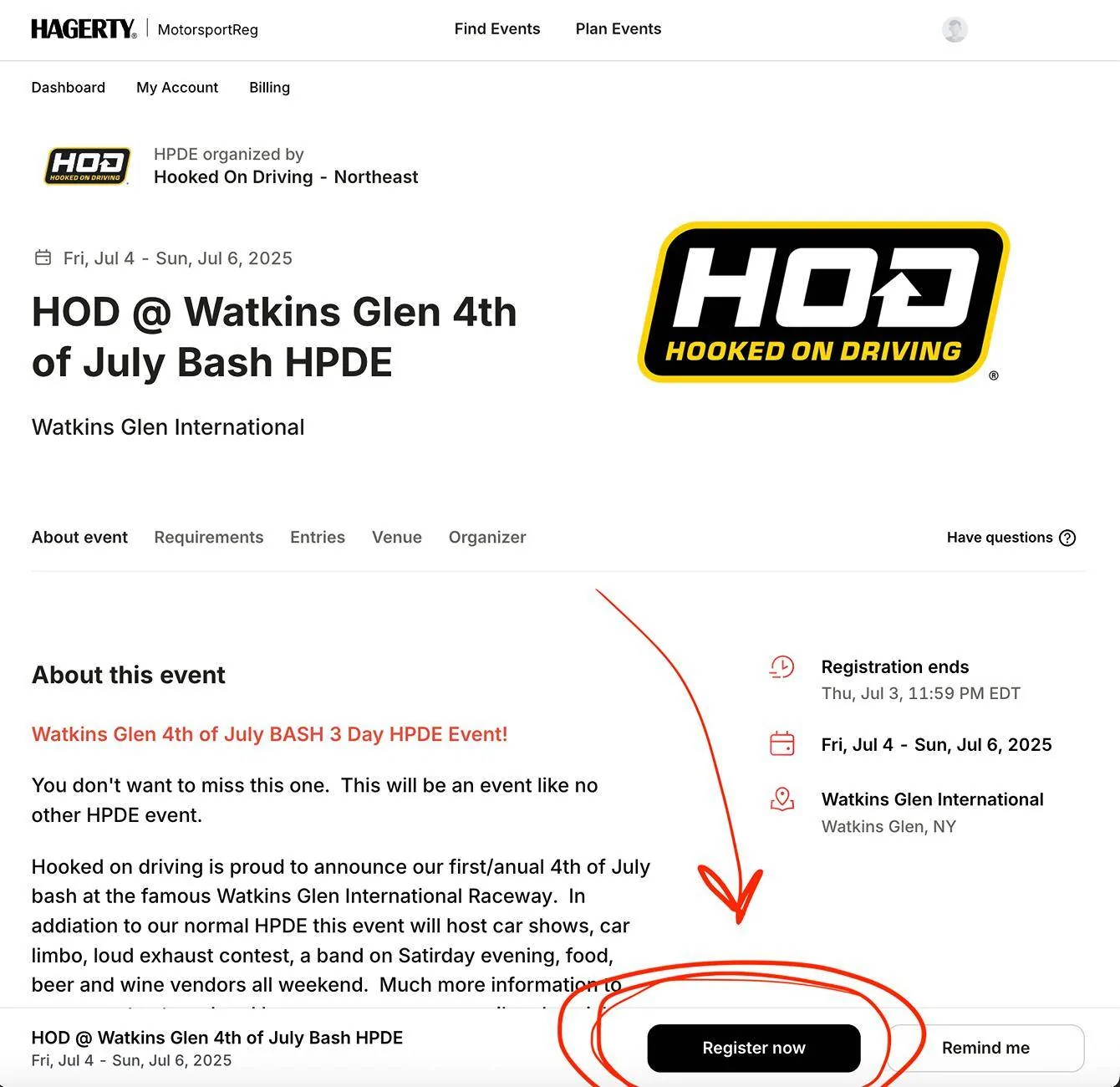

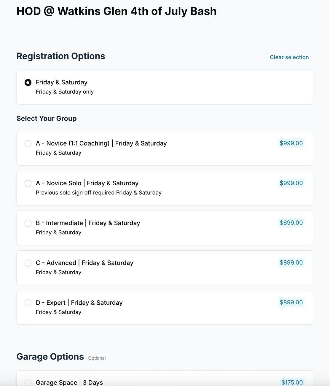

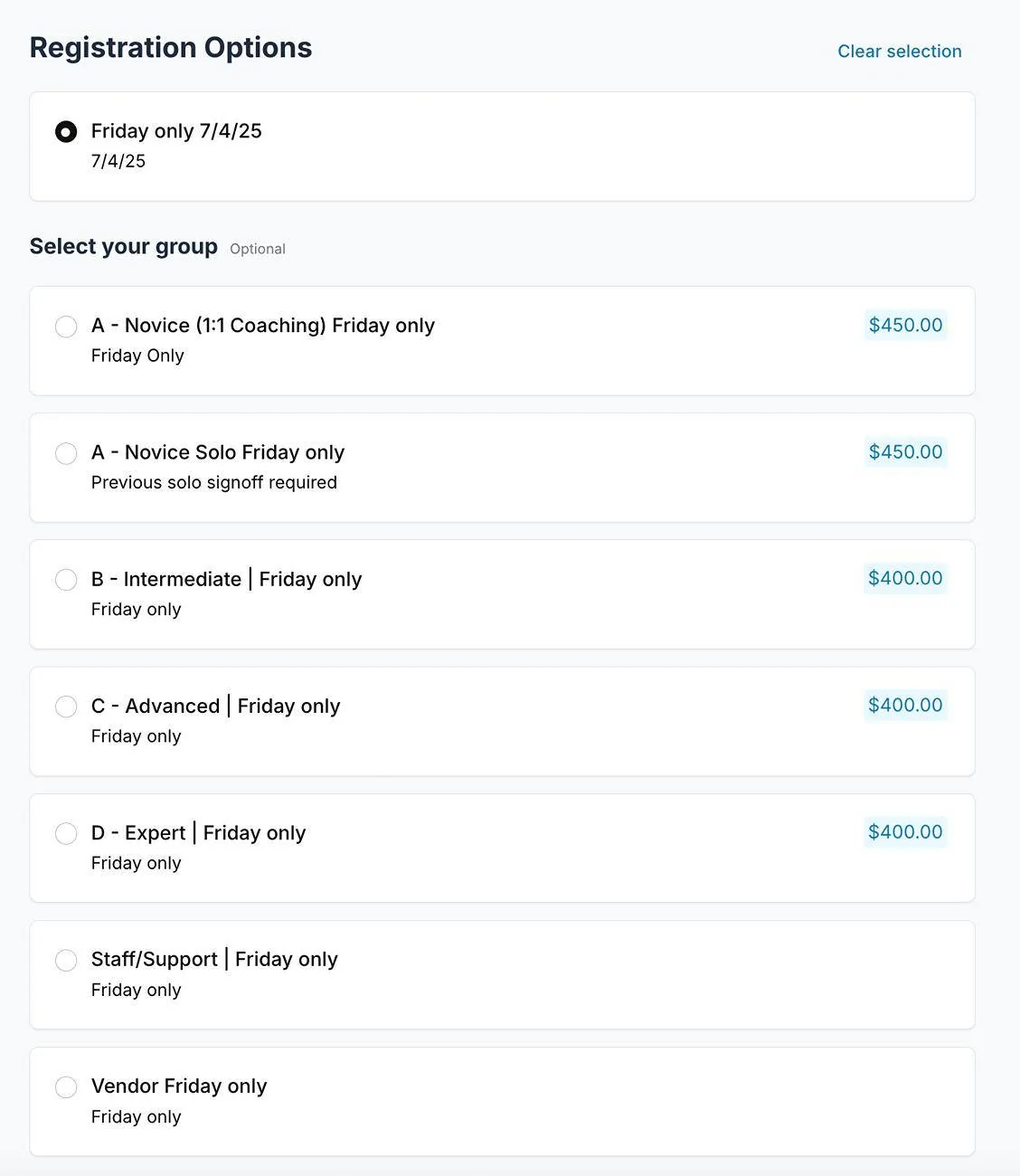

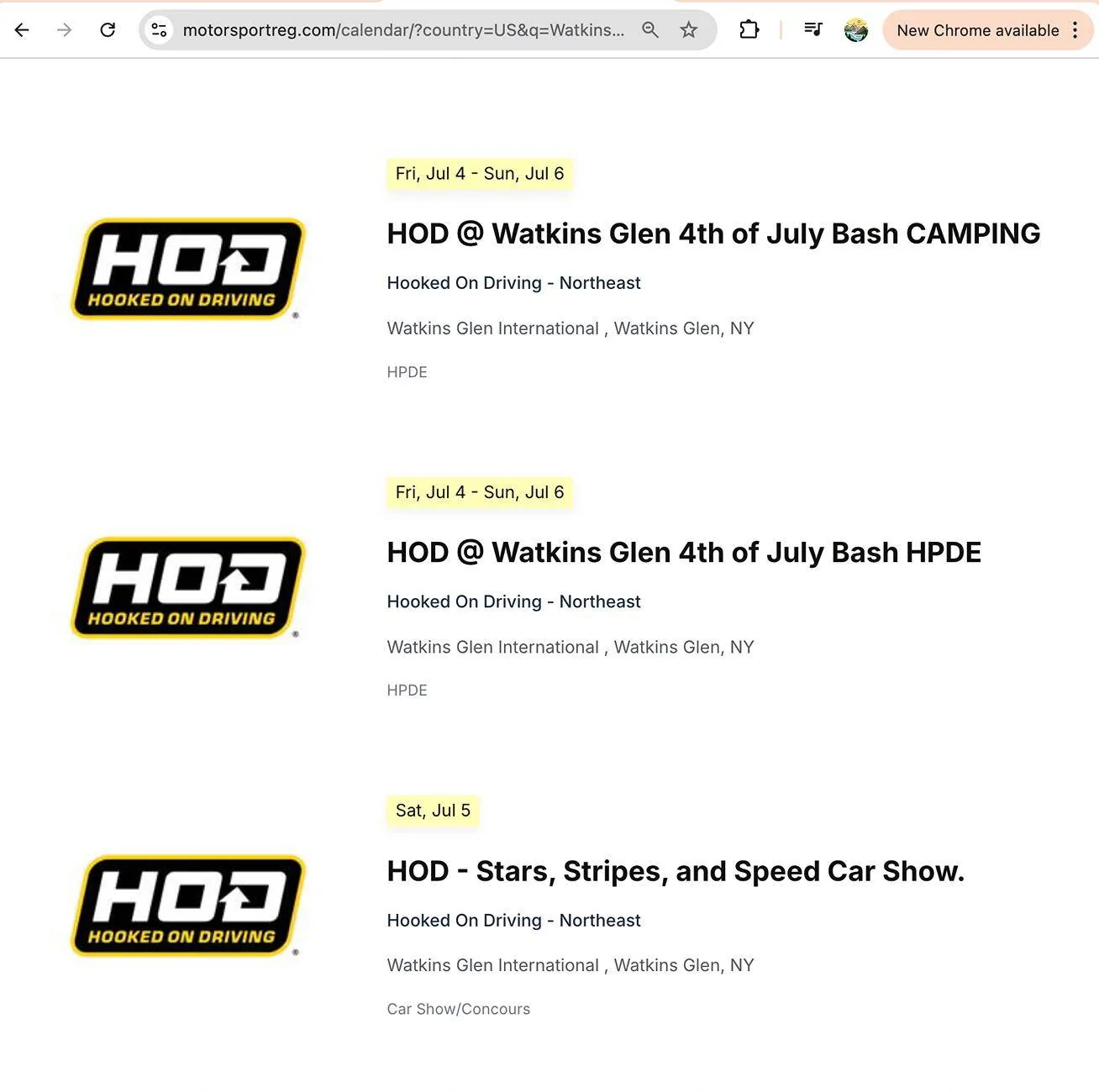

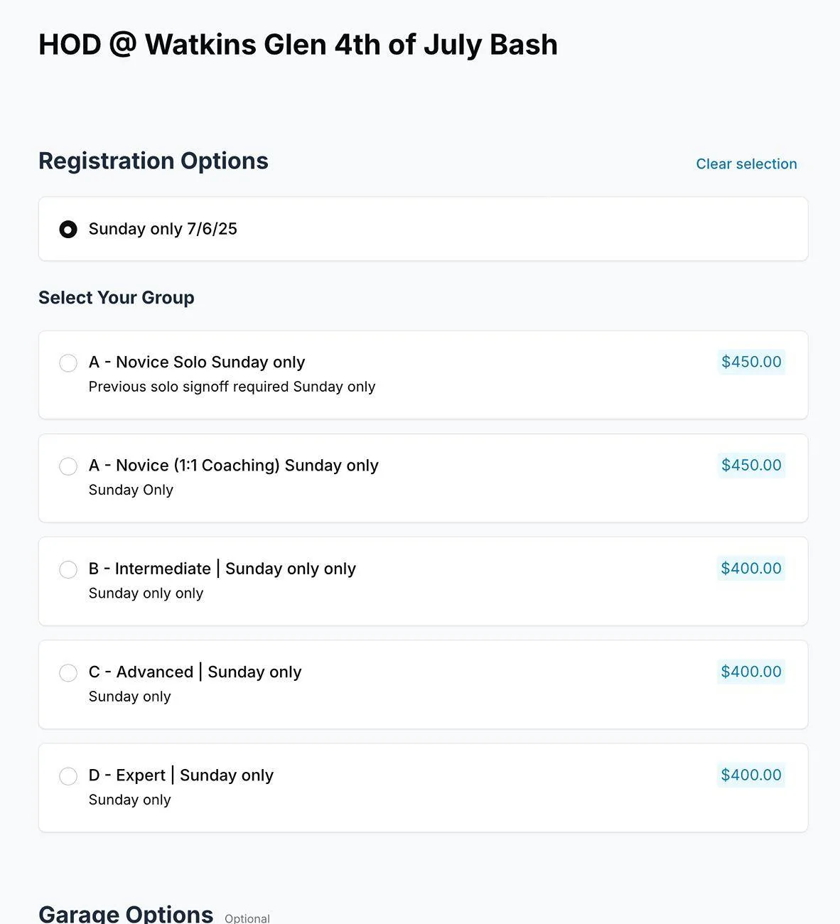

Thanks. NEQ seems a bit less expensive at Watkins Glen then others.
You don’t actually register, you just click the button which brings you to the registration page which has the pricing listed.
Yeah I just see prices for camping for the Watkins Glen 4th of July event. I don't see the hpde prices. Maybe they are sold out but it does not say? I see prices for other events so I don't know.

It's literally where I said it was:
