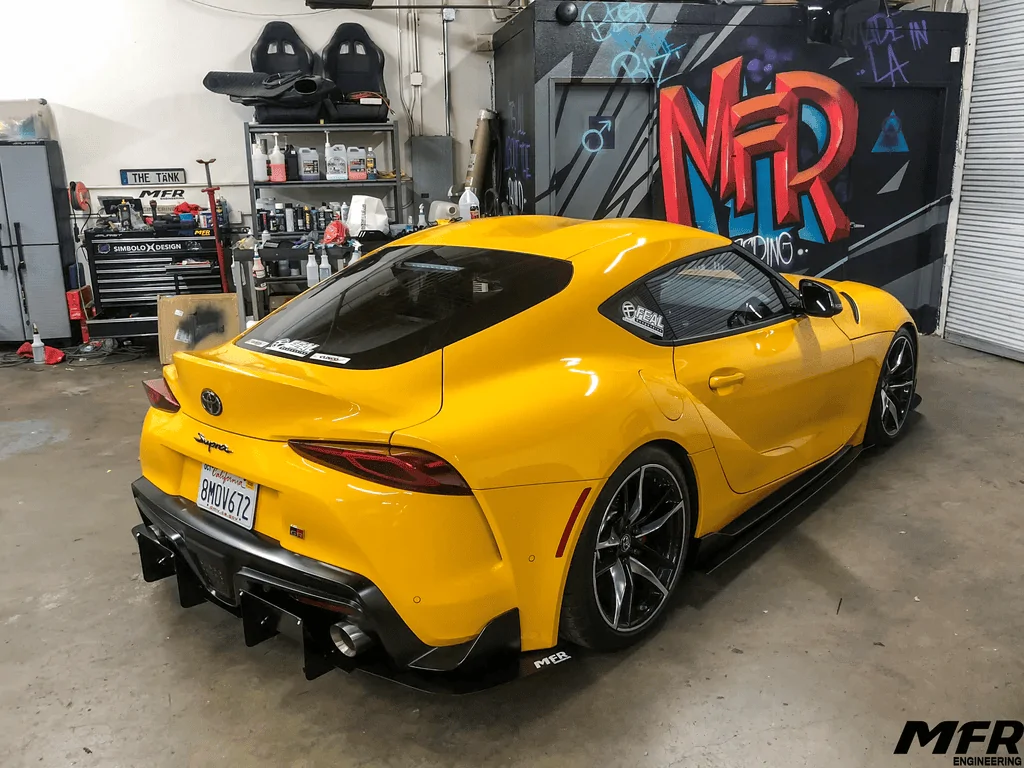

MFR Engineering has one (aluminum) :

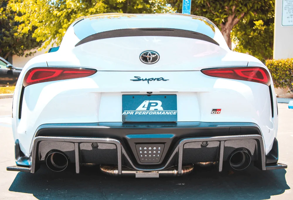

APR diffuser (carbon) :

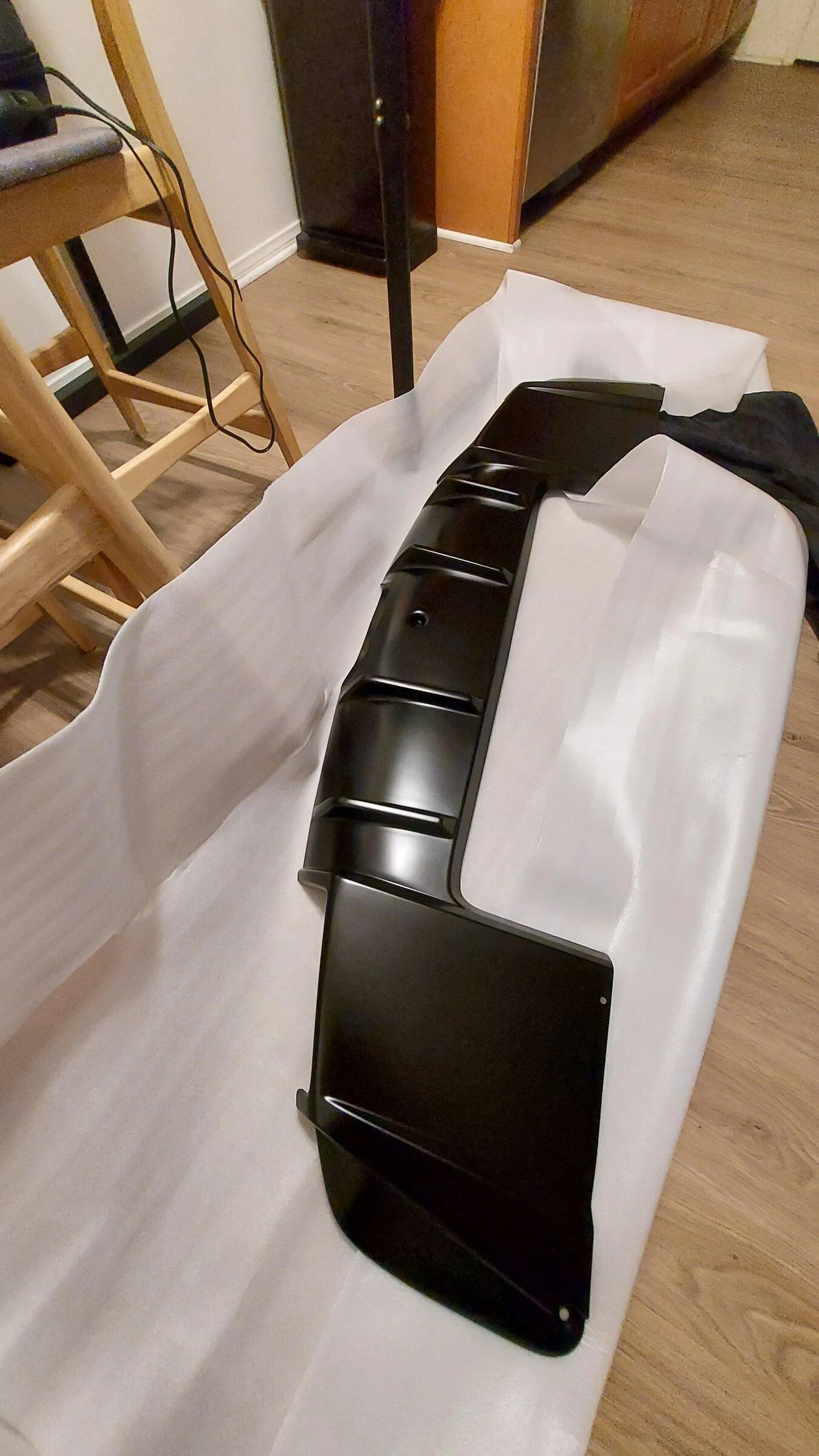

Both of which cost double the price of the Verus diffuser and would have far less of a performance benefit.
With a diffuser being such a niche market compared to that of rear wings, and the already difficult nature of balancing front and rear downforce, I doubt we'll see any other performance minded diffusers for the supra, especially at the Verus price point with proven testing.

Honestly, you’ve got to use loctite (blue) when you attach this guy and make sure it’s tight at the start of every weekend.
But outside of Verus, I don’t think there is another functional rear diffuser, with the exception of doing something custom or making the AJ Hartman (or similar) diffuser work.
The Verus one, in my experience, does provide a noticeable performance improvement on track through, both subjectively and in terms of laptimes.
When mine fell off (was not attached properly by the shop that removed and it put it back on) it hurt my lap times a lot more than I expected. I immediately ordered another and made sure to loctite it and haven’t had problems since.
