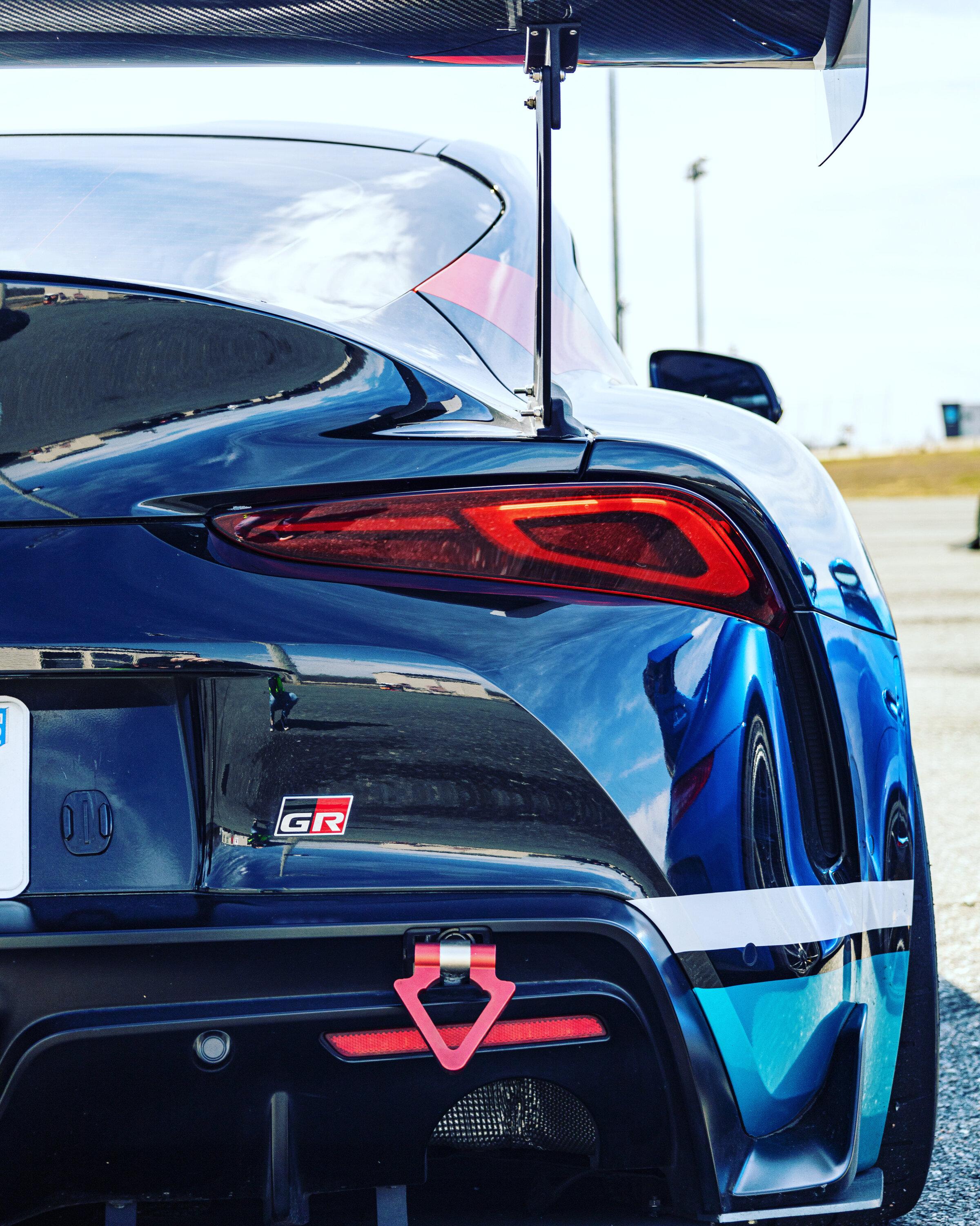

you can see my friends GT3 in the reflection
5th track day this month…. Pressing pause till next one april 1
That is such a badass photo ?. My guess is you’ll be able to drive all summer at VIR.

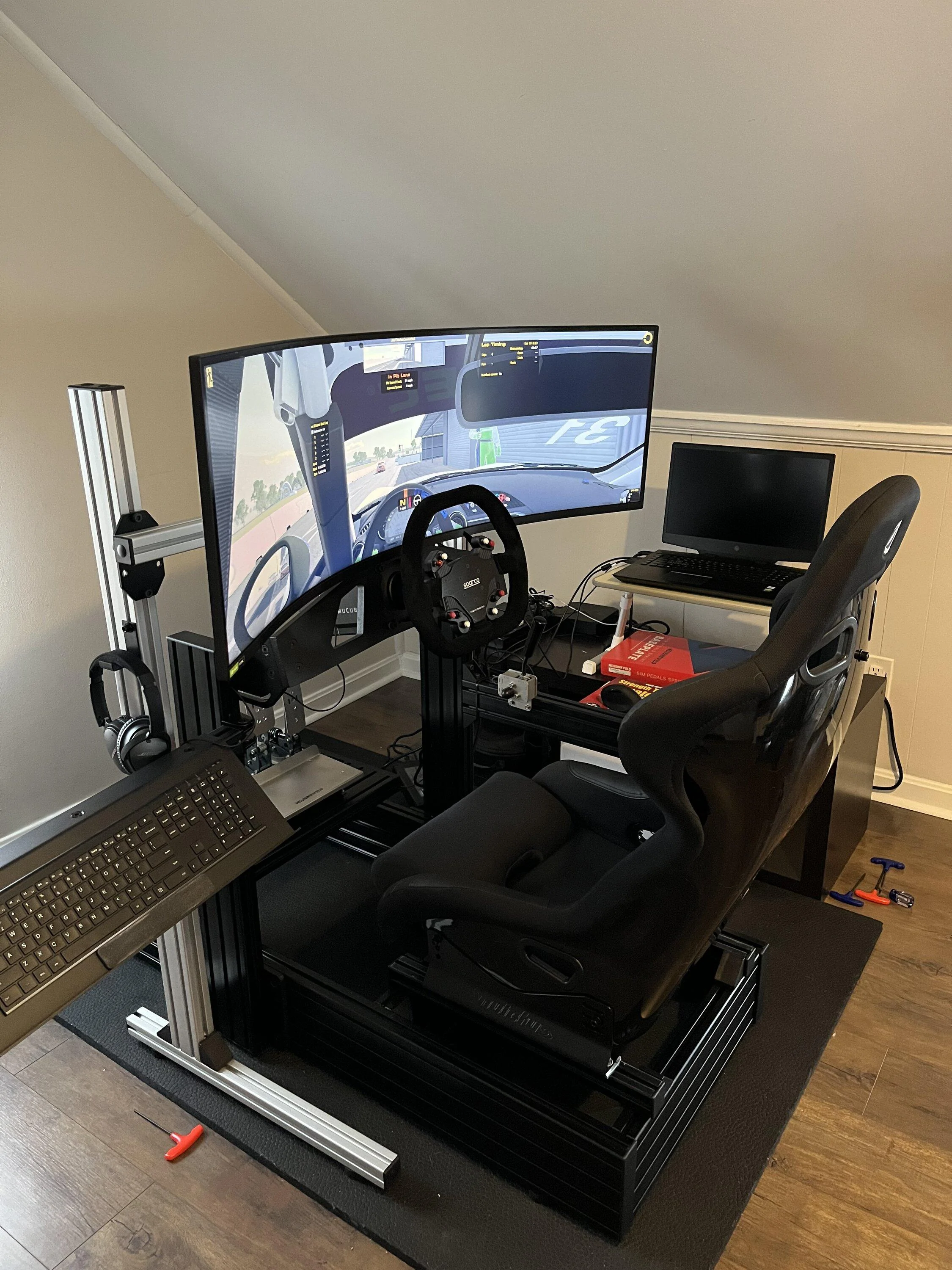

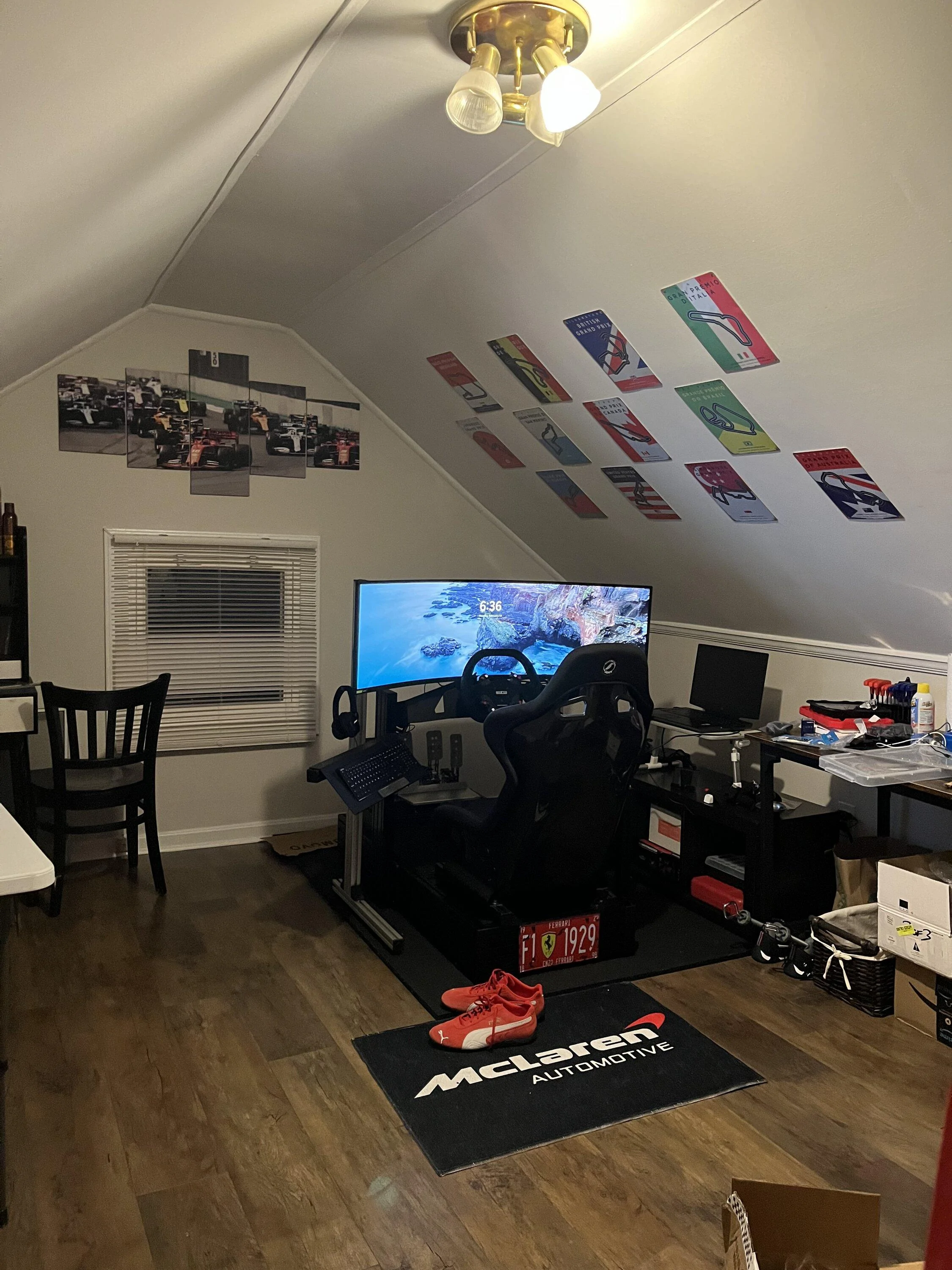

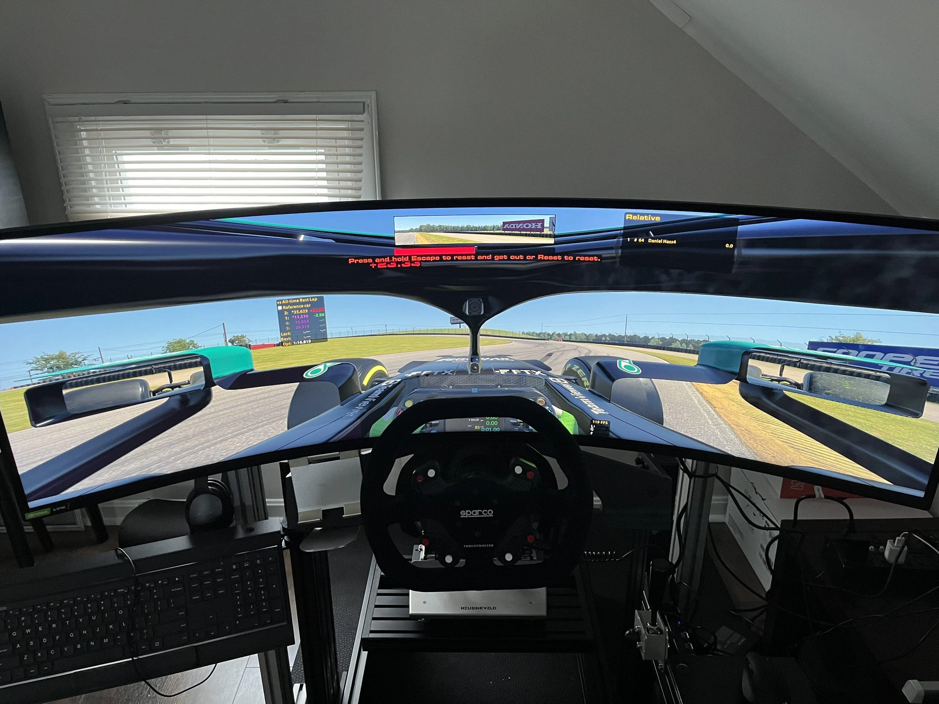

At least I finally got my PS5 setup for my off season. Will be looking for @nibble to get me through until October on the gaming sim ✌?
That’s badass dude ?
I have the PS5, new wheel, and some virtual thing Grand Tursimo is compatible with. @nibble is willing to host a group of us. At least he was a while back. He also has a gaming thread. Check it out ✌?
absolutely would host one. PM me your handle so i can request friend via PSN. that way, it will be invitation only event.
