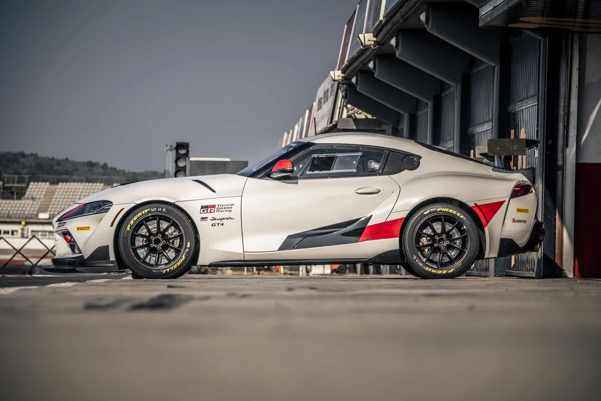

Why as low as possible? I'm wondering where is the sweet spot compared to stock to not mess up susp geometry, as i heared lowering too much is not adviced.
Atm I run stock-ish height (-12mm front, stock height rear) but looking for some upgrade there. Also wondering how much rake fr vs rear is optimal. Wondering if i should go lower (esp in front) or not.
GT4 does not seem too low, lowered but no idea how much and i cant find the info at all.

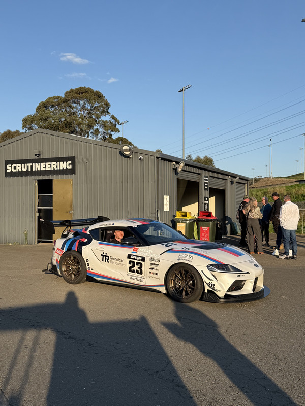

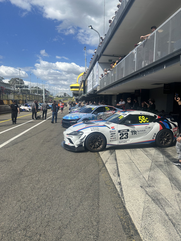

An1 knows front and rear height + rake GT4 Supra runs? I will be re-doing suspension this month after last race (fighting to win whole street class against GT Porsches) and thinking about some adjustments.
Or what do U guys run in terms of track height?
I run so the lowest part of my car is 80mm off the ground because that's what my class rules say.
Looks like below.
You want a bit of rake and also want to look at the suspension arms, don't want them going past parrallel.
