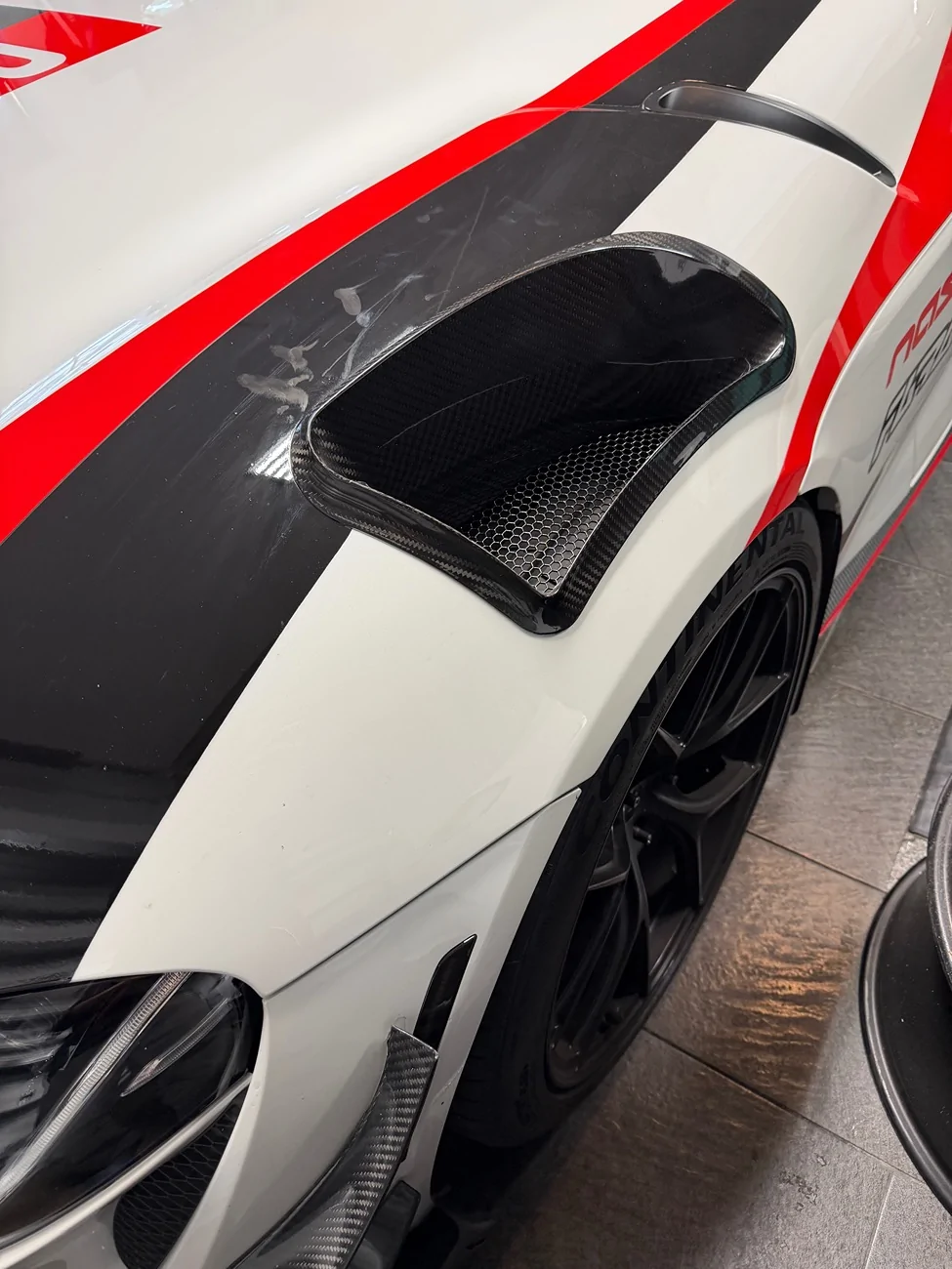

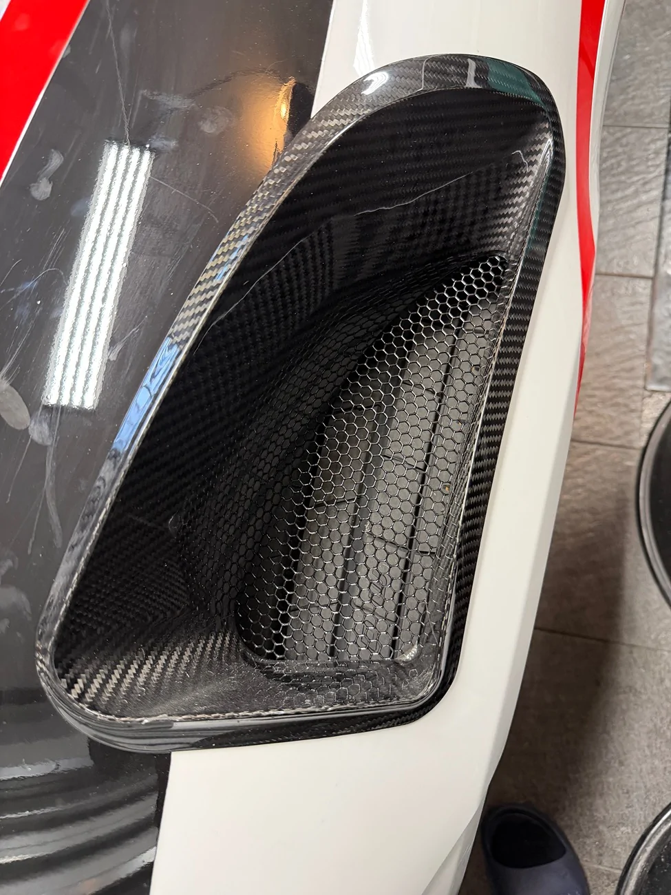

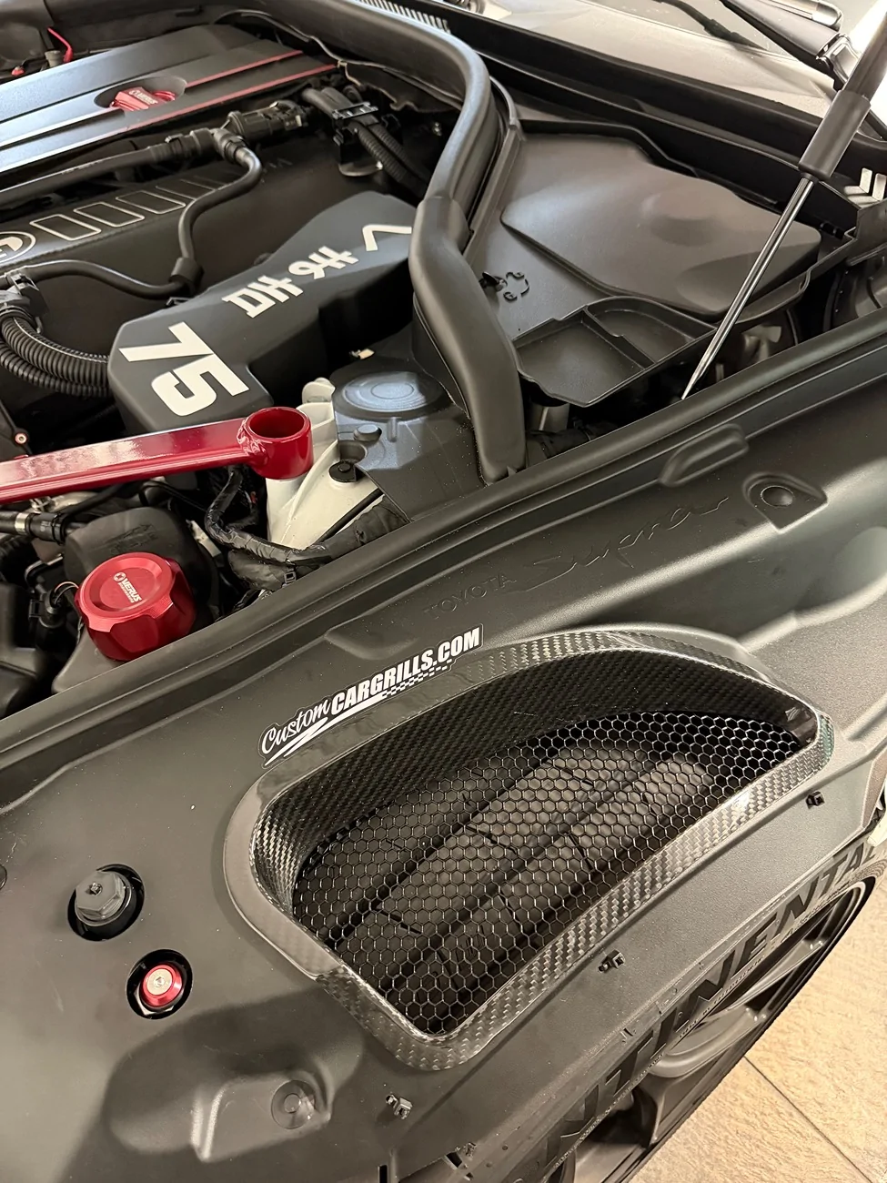

Verus has CFD data showing benefit in downforce. There is real drainage of hot air through them.
Was part of the pilot release of the product way before they were commercially available. When I asked the why not put fins etc, they told me that the benefit was negated by doing so.
I have had them for about a year. Verus benefit is that They are not a simple hole in the fender that allows dirt in. they are 2 piece vents that completely isolate the flow from the engine bay.
I did add a grill because there is debris that goes up specially during rain but that was my own mod.

Verus ones look cool as shit, and are the most functional because they extract air from DEEP within the wheel well and size does matter for vents.

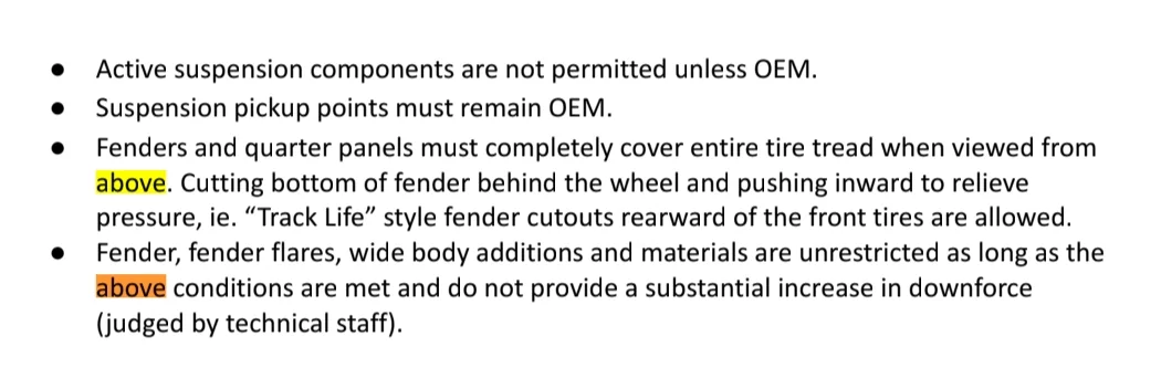

Just be careful of your ruleset. Theyll bump you up to track mod in gridlife since open unlouvered vents not allowed in street gt or street mod. But if grid life is not your primary org, I guess you could just tape over it for the event.

Verus ones look cool as shit, just be careful of your ruleset. Theyll bump you up to track mod in gridlife since open unlouvered vents not allowed in street or street mod.
I had no idea about this. This will probably never affect me as I don’t think I will ever get there (I just exchange cash for the benefit to circle aimlessly around the track LOL ) but definitely something to keep in mind for the folks that are competing

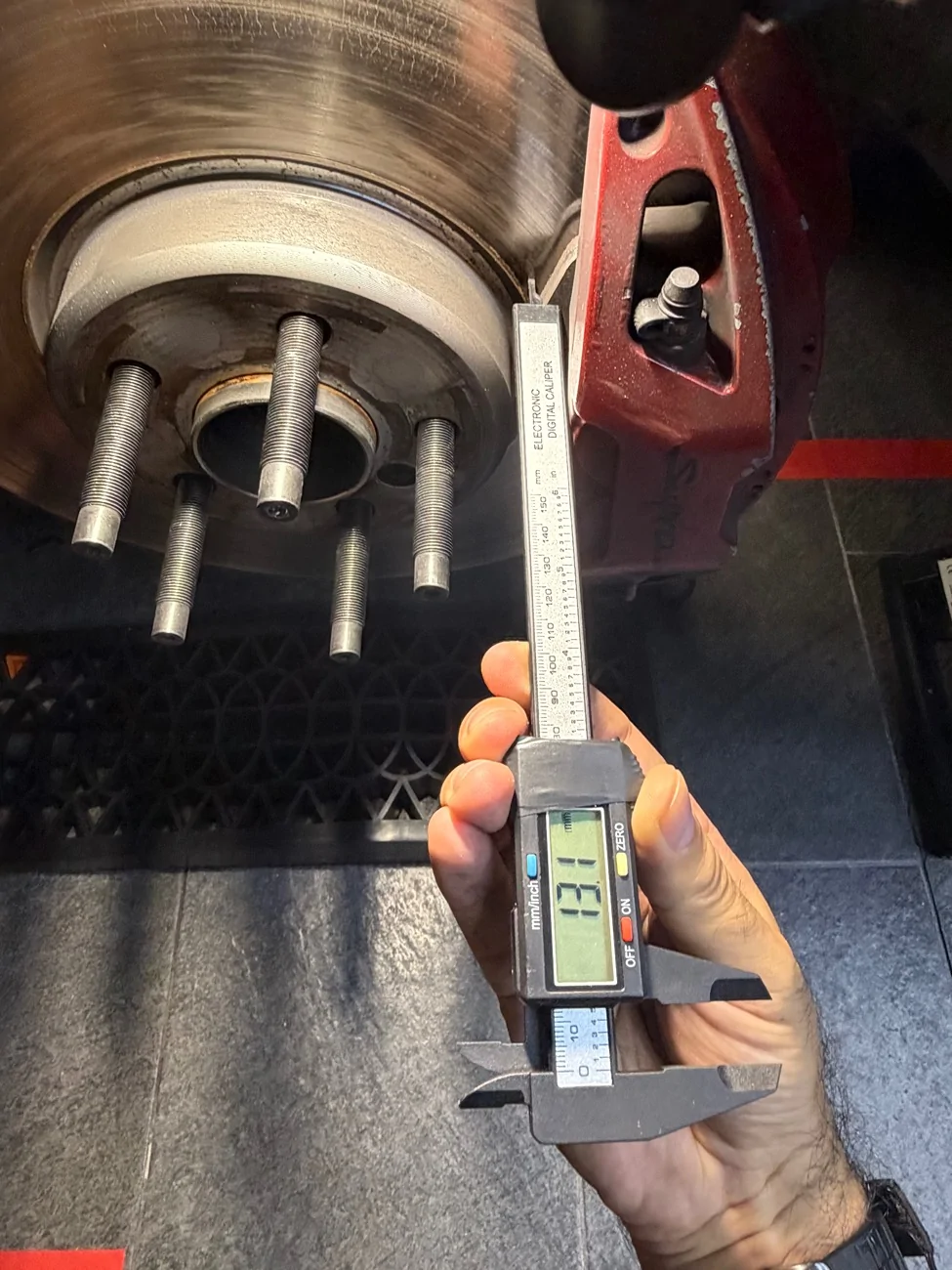

Getting ready for my next track weekend at homestead
unfortunately the coilovers and camber plates did not make it on time, to get them installed, settled, height adjusted a aligned.
So I will go out again on my street tires and springs.
I’m a slow driver and will go out with 54-56% of my pads left, (measured taking into account ONLY the compound-obviously) I know the wear is exponential as they get thinner. I have a new set, just in case.
but I think I’m ok for this weekend.

That's plenty of pad. The exponential wear seems to happen somewhere around .25" or so. When you're out at roughly .5" that's definitely "good to go" range. Would be interesting to see how much gets used up during the weekend.
I need to check the pads again after VIR the other week. The car had some odd braking behavior into 1. Plus it's finally time to put the stock pads back in for a few months while it's "winter" in the SE.

I use something like this. At lunchtime can run a quick check by poking your hand between the spokes and reach the outer pad. Just assume the inside is 2 steps thinner out of caution.
