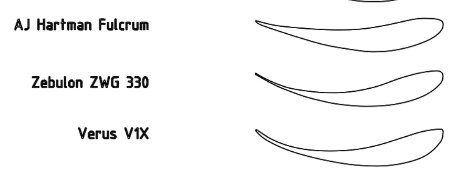

Based on just visual checks, the zeb wing has more curvature, which means it likely has the similar DF at max AoA as the AJH, despite the smaller chord.
I have never worked with zeb but the vibe i get is that they are very responsive, but you will pay for that response time. Thats their main strength though, quickly iterating on bespoke/custom stuff.
AJ is very helpful but he's just one dude juggling everything.

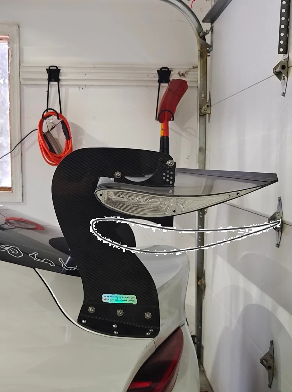

Is that image legit? Where's it from? the Fulcrum 14 looks a lot flatter than that in pics. I could be off though obv since they're just pics

I've got my Fulcrum 14 laying against my wall with the endplates off. I can send a side profile pic of the airfoil tonight when I get home to confirm if nobody else does first.

Seems about right to me. Screenshot was from the occams aero discord
At the end of the day, it's about the chord length, span (the bigger, the better), and position of the wing.
Yep, given a known profile, the 3 tuning knobs you have are span, chord, and AoA.
Increasing span always improves overall efficiency. Always max this first.
AoA has significant drag penalties. Always adjust this last.
This leaves chord as your middle knob.
