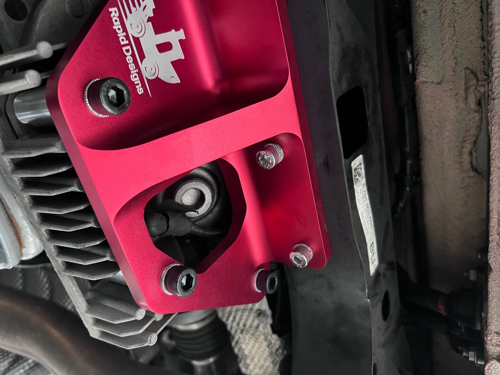

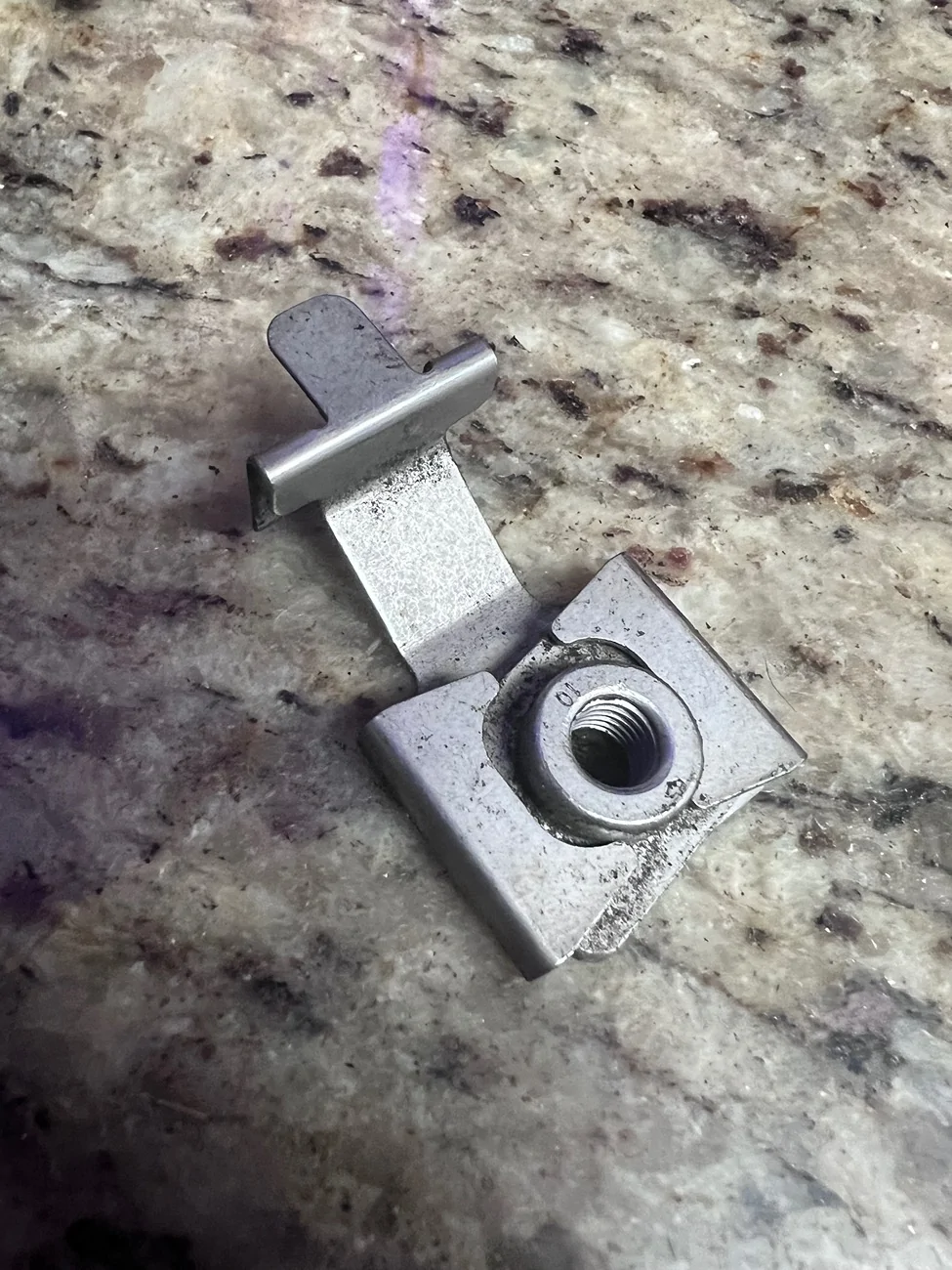

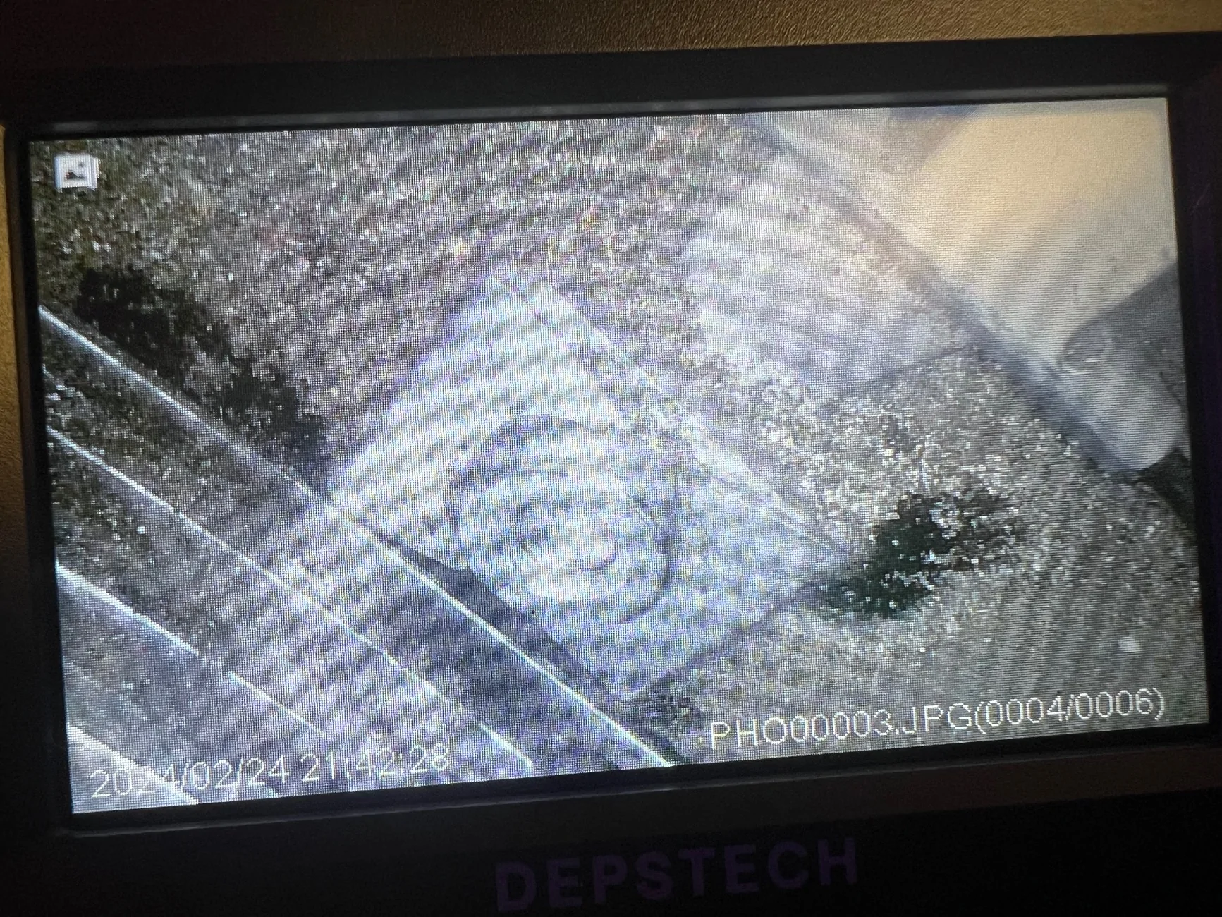

mystery solved, thanks for the advice everyone!i put a camera in the sub frame to see what was up and i think @i3igpete was right that it was the retaining clip for the mass dampener. the road dirt over the years made it cemented in there but a good hammer whack on the clip got it loose.
with the camera in there, I saw what it was and saw that the clip had a lip that extended just outside the access hole. from the outside you wouldn’t think it was connected but it was after pulling it out.
after popping the clip, the new insert went in flat and i was able to finish the install!
@rwense great product! i might recommend adding to the instructions that little bit about the retaining clip being in the sub frame. Some, like myself, might not know about it being there and that it needs to be removed. Instructions just detail about the dampener being removed and doesn’t specify the clip.
Quick thanks and bump for this post, saved me a lot of time, hopefully helps someone else… also I used a flat head, put it into the bolt hole and pried it out.
