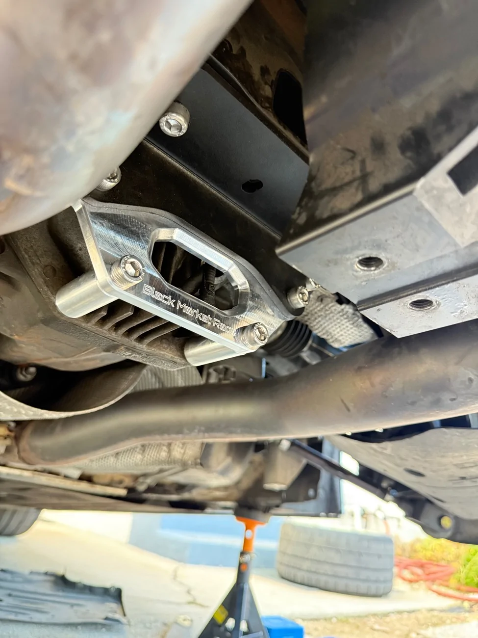

Doesn't it require drilling the subframe? That's what BMR says.
No changes to NVH? I'm been wanting to get some kind of diff brace that doesn't make me have to get rid of the Verus cooling plate
I didn't notice a lot more NVH but I did some interior sound deadening so YMMV. It does require drilling a single hole but it is very easy and they supply everything you need to do it.
Already installed the brace a while back. Haven't experienced any incremental NVH

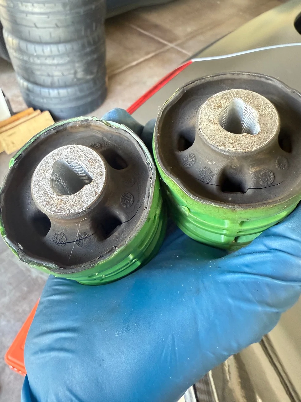

i went with BMR and it surprisingly made a difference. Did this in conjunction with replacing the front diff bushings. I’d imagine these braces would help keep the bushings from cracking, and that alone is worth its weight in gold. What I thought was clunky shifting from my built trans turned out to be slop in the driveline. No additional NVH.
