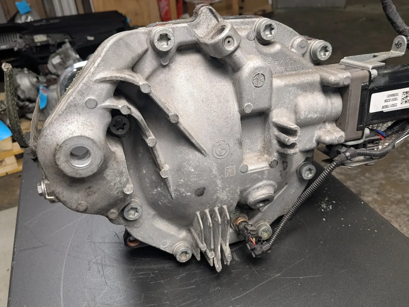

Its www.rapiddesigns.us
Just a note, i have a printed prototype im fitting up currently. Ive already talked with a suspension manufacturer who has interest in producing it but we'll see. I might use JLCCNC to make a prototype or 2/3 and send them out for testing.
Very interested in helping out with this if you have any interest in bringing it to life for the xDrive models as well. I’ve got a ‘24 M240ix.
8,761
17,187
Rear is the same AFAIK on RWD/AWD
8,761
17,187

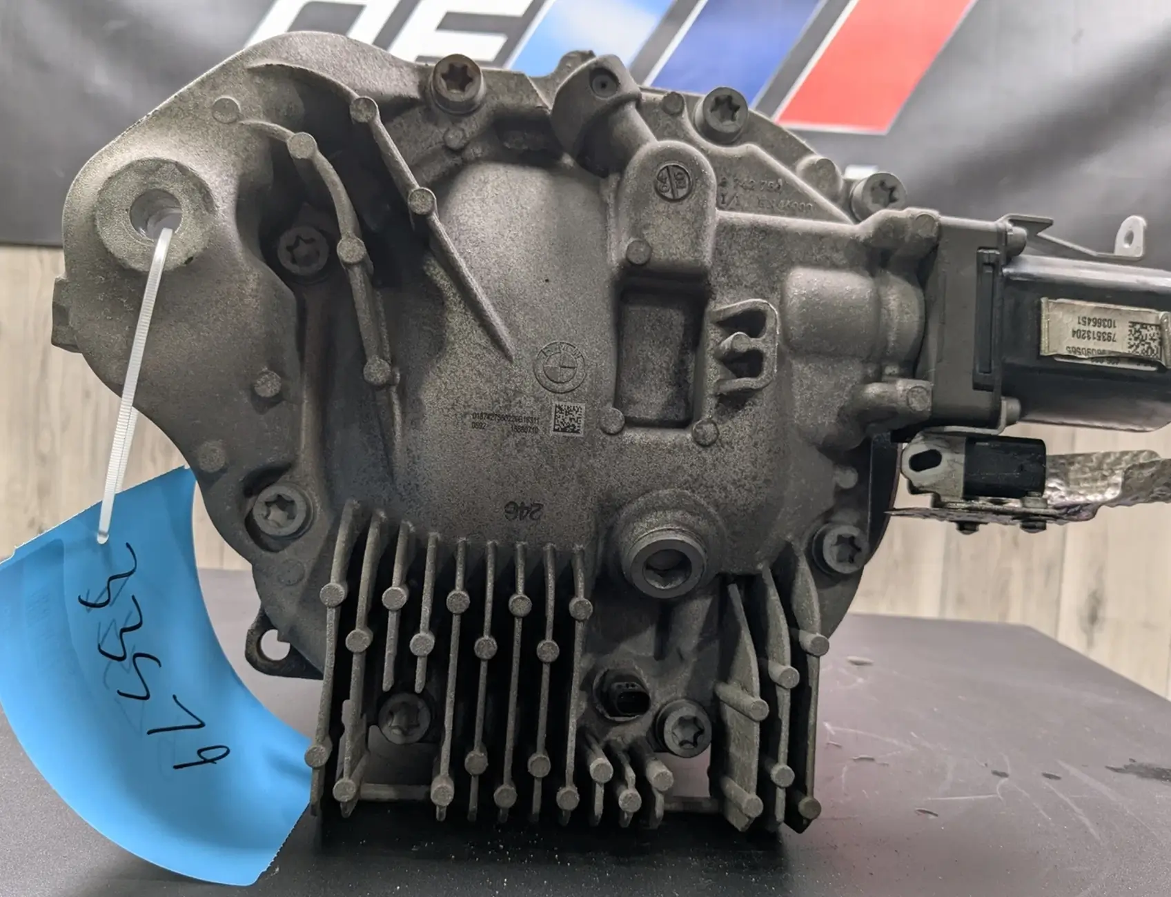

The design and density of the cooling fins is a bit different for some odd reason.
oh, that is just the M-lite thing. The actual bolts are the same. I don't see the brace fitting any different. If it fits the Supra that has more fins, it should for sure fit the M lite cover with less fins.
The Supra Final Edition has the same different cover with less fins so the Z4 bracing will fit.

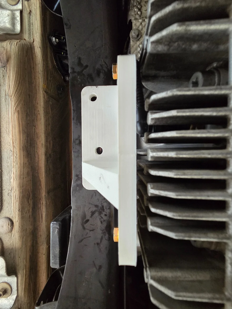

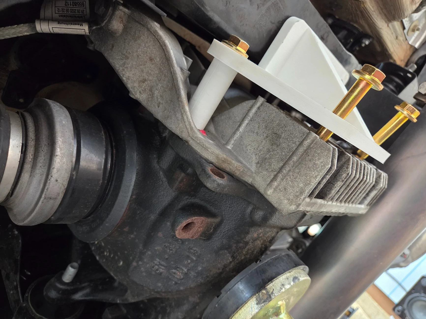

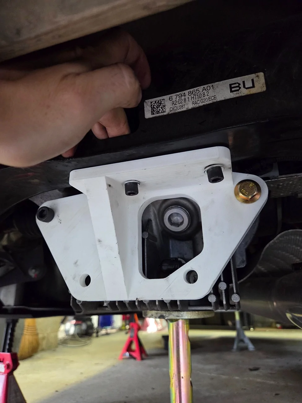

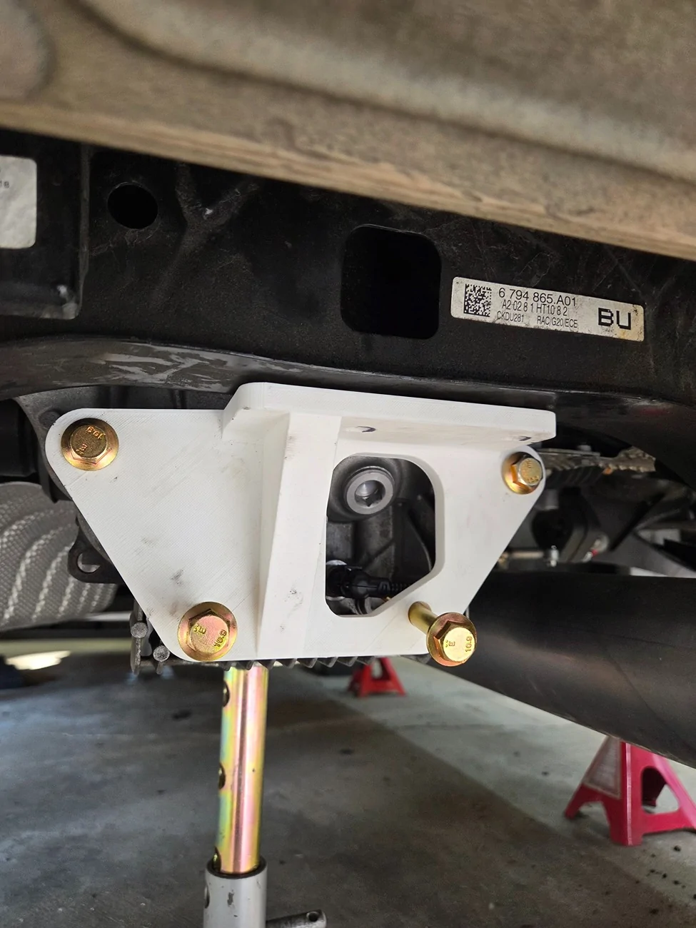

@dustwhyn id be very interested! I bolted up a test part and overall am very pleased with the fitment. Id be more than happy to ship over a printed prototype for you to confirm fitment for me if thats something you're interested in. Id be happy to offer you a discount for the production part.
Ive also been talking to another manufacturer (who also owns an A90) and it sounds like i might be able to get a couple prototypes made relatively fast. In time for me to test before the end of my season!
