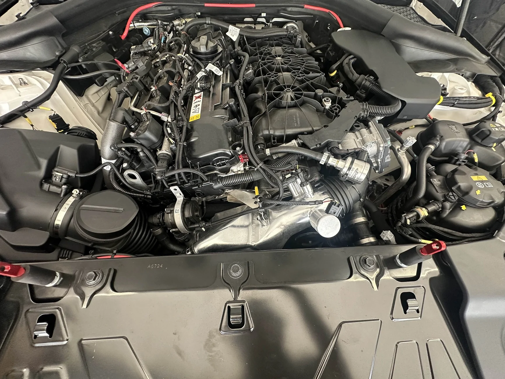

There are some photos floating around. I know for the diff they run an external oil cooler mounted underneath the car near the driver side wheel well with an external pump ofc.
They have had that since the inception of the GT4 Supra.
The additional cooling on the Evo2 is an inline "chillcooler" in the charge pipe:

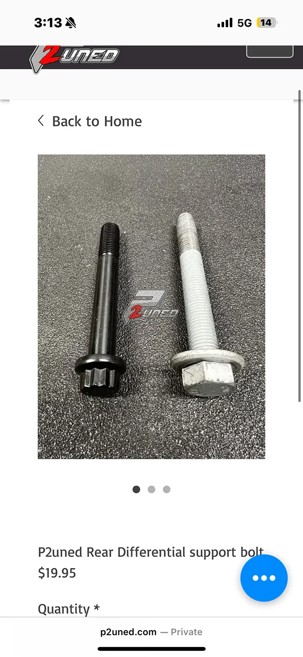

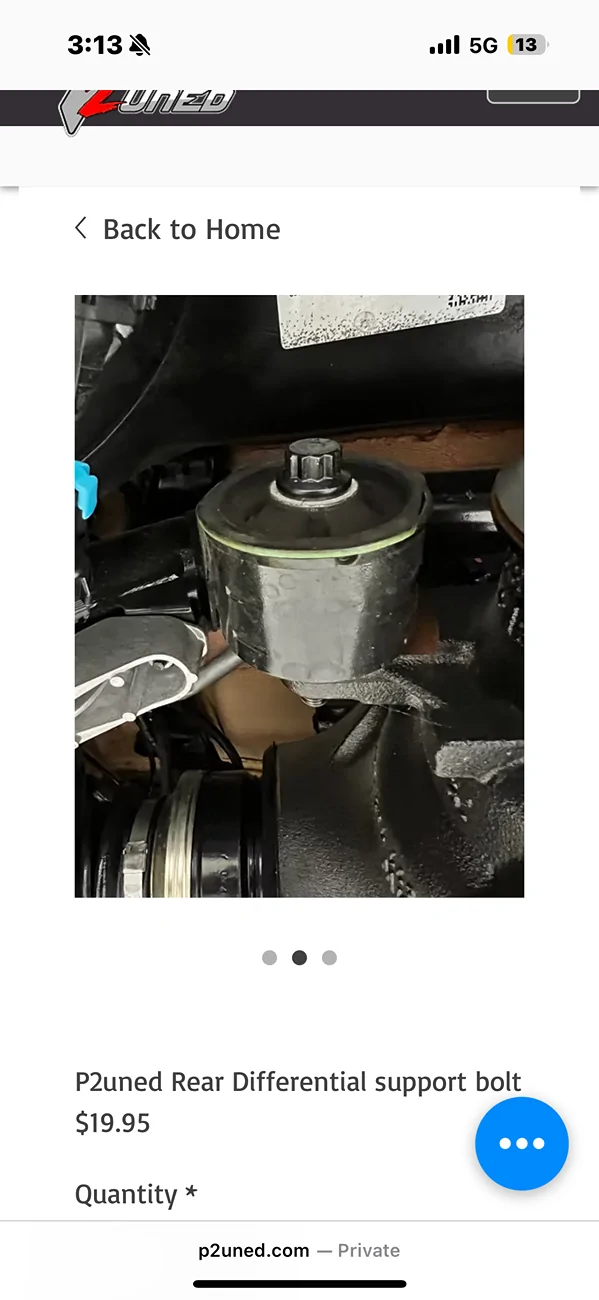

These bolts that hold the diff to the bushing. I saw a guy snapped them, but arp makes these bolts that are a bit stronger. Waiting on these, but im not to worried since i now have the diff brace on
Are these bolts because using the brace adds stress to the bolts or just in general?

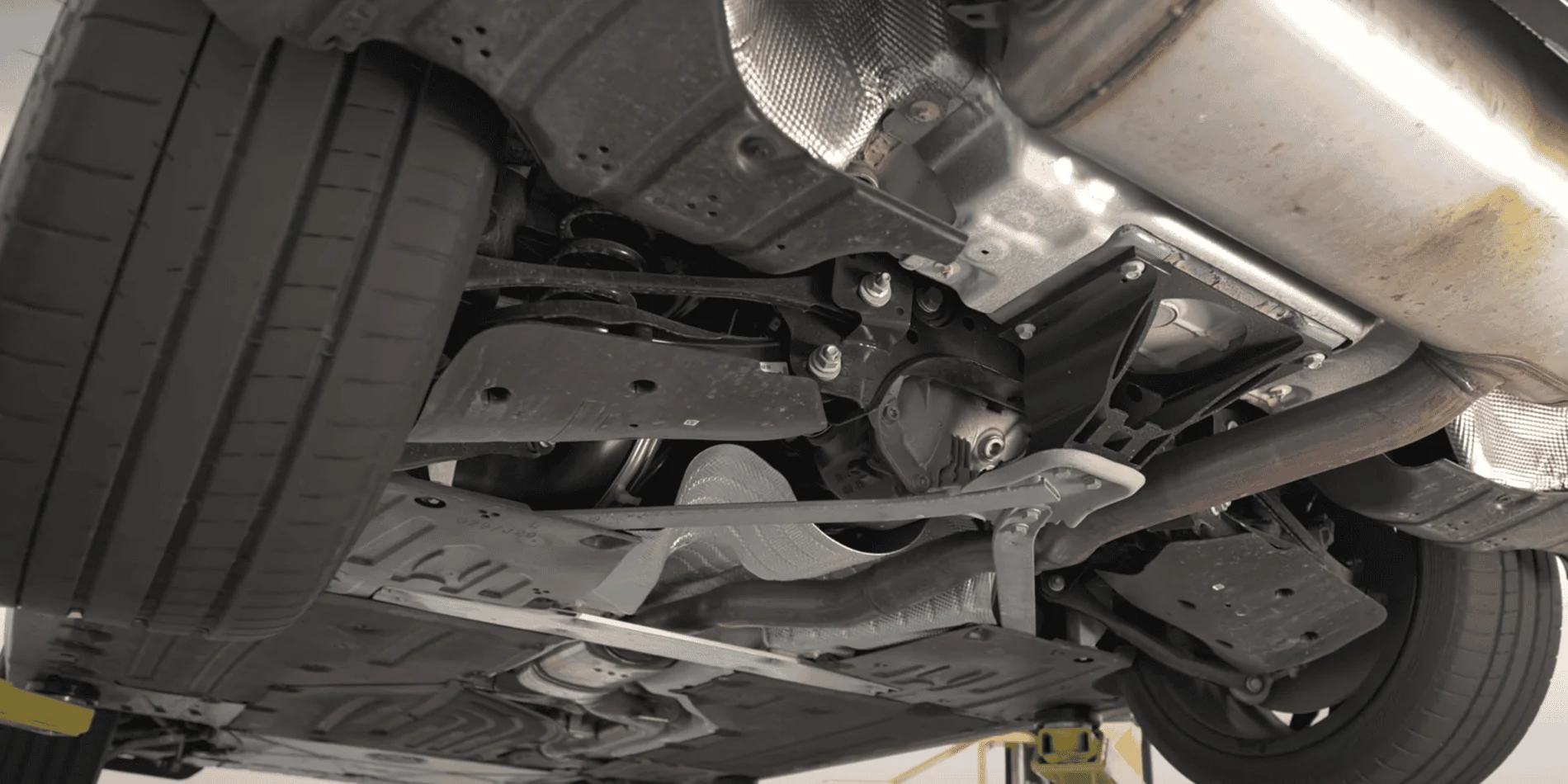

How does bracing the diff to the subframe compare to the chassis brace to the diff like the z4? (If I understand the new supra brace change.) What potential downsides and considerations for bracing the diff to the subframe?

One's a chassis brace for body flex considerations and doesn't involve the diff and the ones being discussed here are for bracing the diff itself.
Not sure why you'd want to install a diff brace on a road car. It won't make any difference to the way the car handles or traction or wheel hop. It will probably improve the life of the tail shaft Guibo at the expense of NVH I guess.

Z4 bracing does zero to brace the diff. It's the battery box to another part of the chassis.

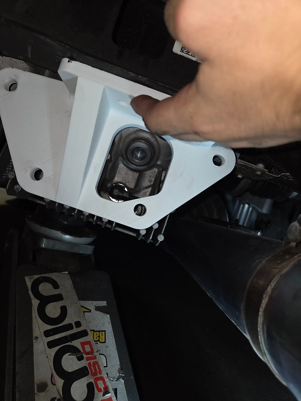

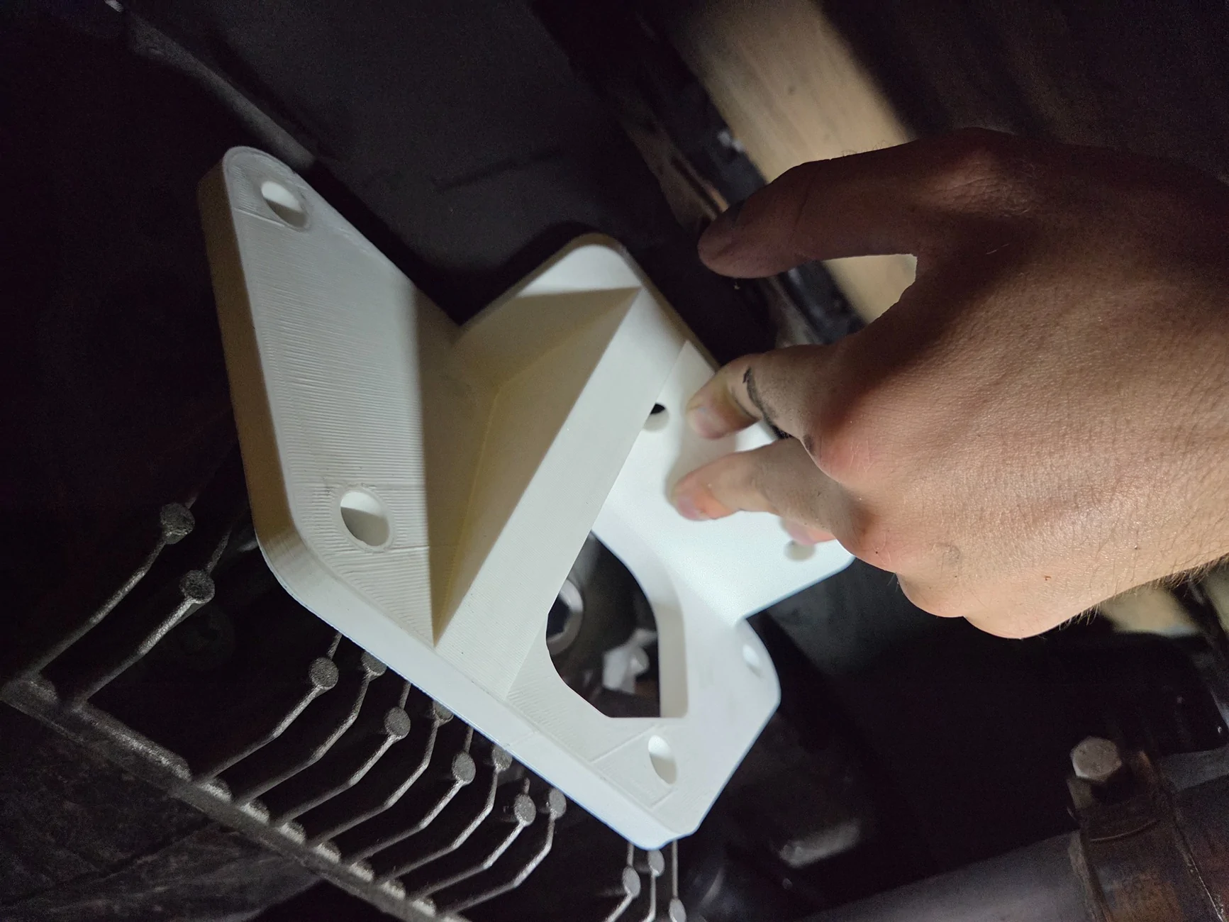

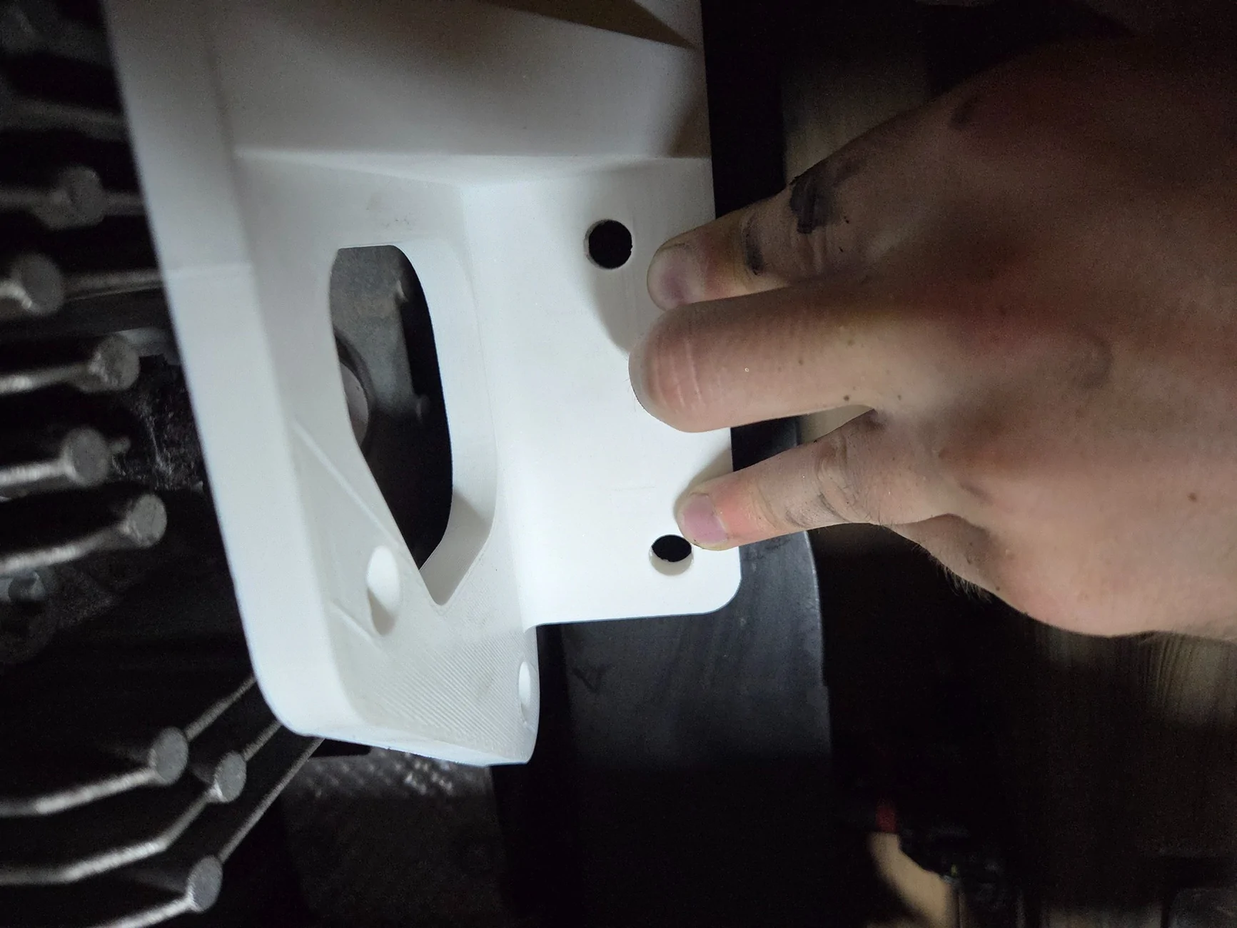

Just a note, i have a printed prototype im fitting up currently. Ive already talked with a suspension manufacturer who has interest in producing it but we'll see. I might use JLCCNC to make a prototype or 2/3 and send them out for testing.

Uhhh, idk. I might be able to get a prototype made and tested by the end of the year, probably Oct or so. Production? Who knows really, sorry

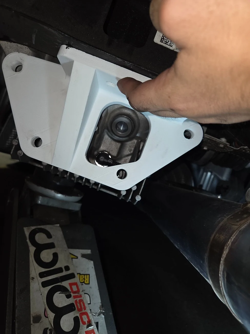

Nice! Looking forward to it. I’d be down to test (will pay if needed) if you need volunteers. ‘23 MT.

No these bolts are the ones holding the diff. This is why i went with a brace and arp bolts because this guy broke his diff bolts with 20k miles stock
