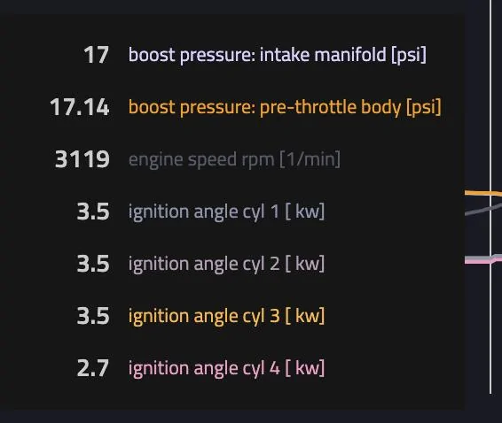

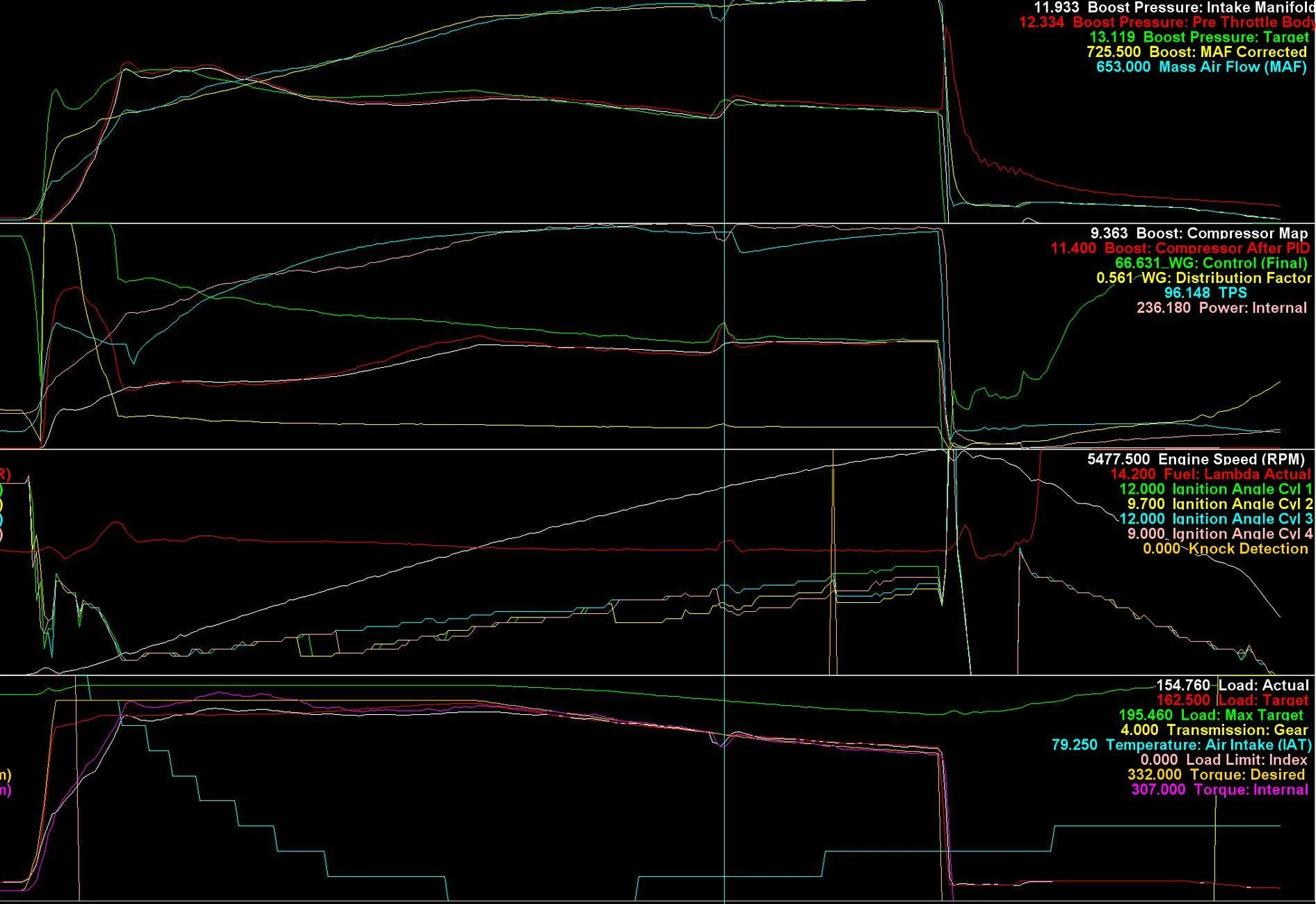

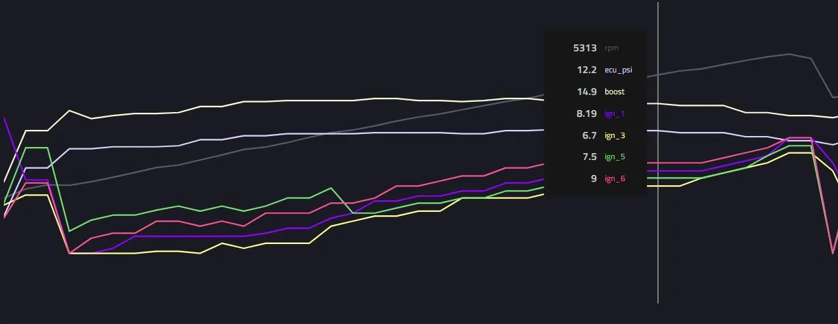

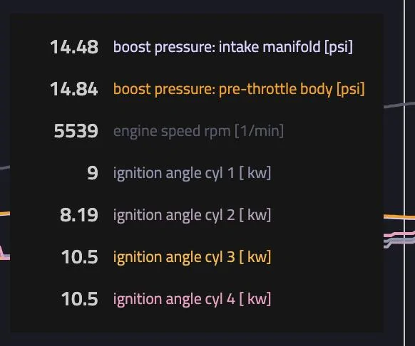

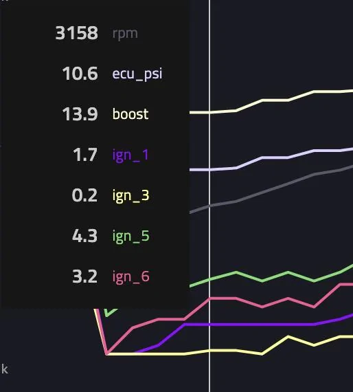

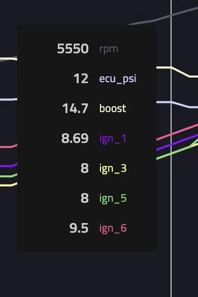

I'm good man. That log is running significantly less boost and worse timing than my b48 runs stock, so not really showing anything better. I appreciate your enthusiasm for piggybacks, but I just do not agree.
VS your log:
VS your log:
No prob. shitty costco gas or something on this, but if you ever change your mind, lemme know! Definitely worth E blending since it runs lambda 1.
as you know, DA directly affect dme boost targets and timing, so it'll never be exactly the same as yours. worse timing than stock because it is 25% more boost lol. Having <2 deg separation btwn cylinders is not considered poor timing. And your piggyback had actual knock lol.
