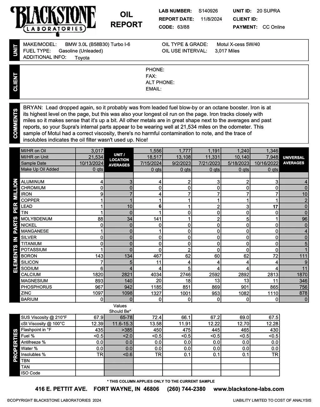

Newest oil report. This last sample (10/13/24) has six track events on it (I usually do 3-4) and double the miles.
Car now has about 63 track days on it.
2,238 laps
51 hours of track time.
Still using 5w40 oil that SoME PEoPle oN HERe tHink wiLL DEStroy LiFe As We kNoW It.

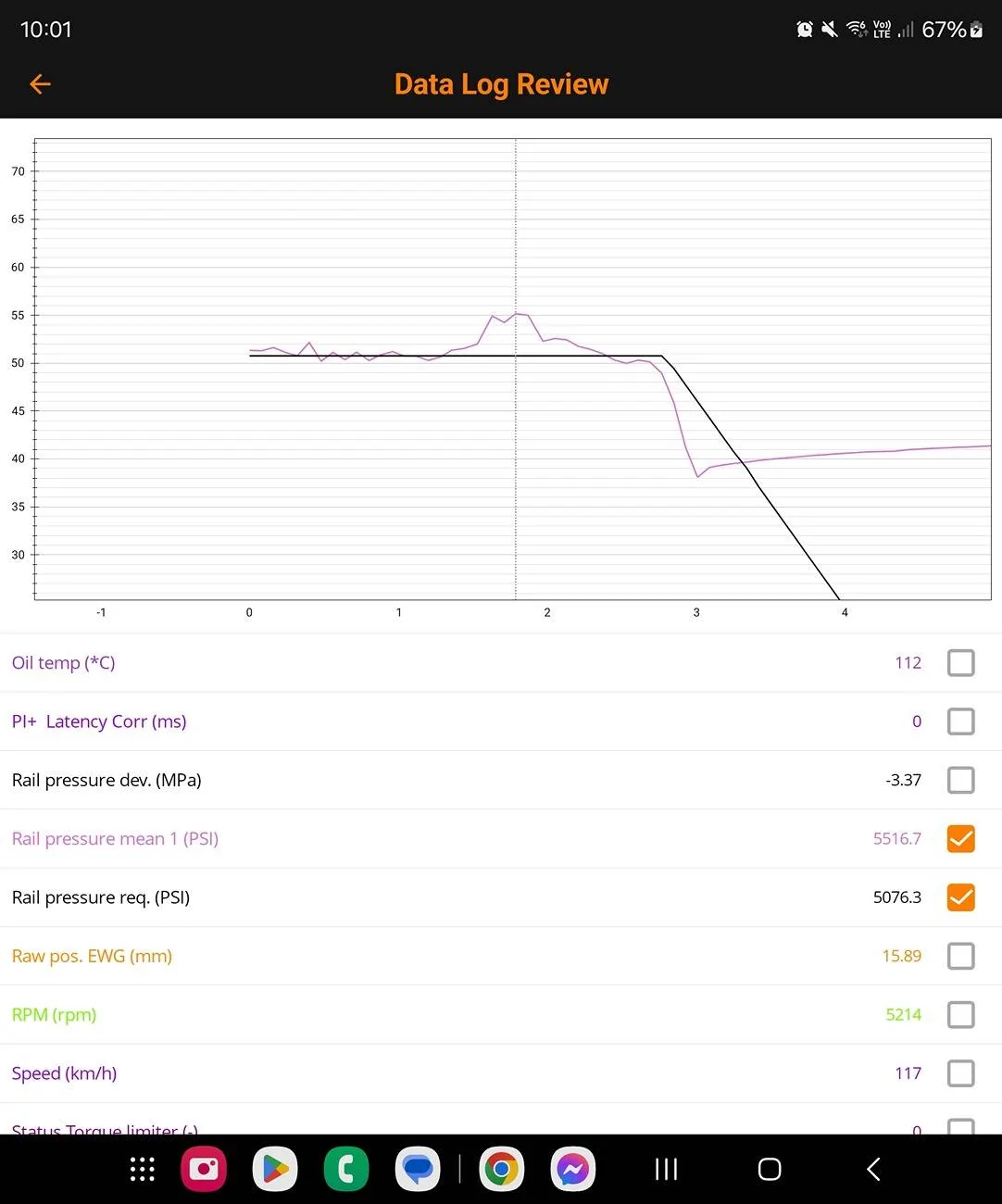

Hey razorlab, i've just installed my dorch ds25 as well and it's really shinny ?... i love it. Btw, have you noticed how much louder the ticking is? I can hear it a little bit in the cabin.
I've also been looking at the logs and they seem ok but i do notice on this FF MHD tune it tends to overshoot fuel rail pressure but it recovers...with the tu hpfp i never really noticed this...did you notice anything similiar?

Wow! Solid oil after track use ?
5k next oil change test? ?
Photo for reference
Yea it's for sure louder. Sounds like rod knock, right? haha.
Can you post the full log?
