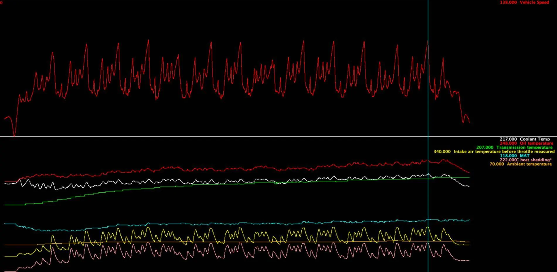

I haven't really noticed any difference compared to OEM to be honest. In a good way.
The most impressive thing is that after 12 laps at Lime Rock, the wagner manifold is shedding 222F of heat out of the intake charge. This is with running about 27psi on E40.
I find it funny that some "I live my life a quarter mile at a time" people said the Wagner manifold was trash a while back. Yea, no.

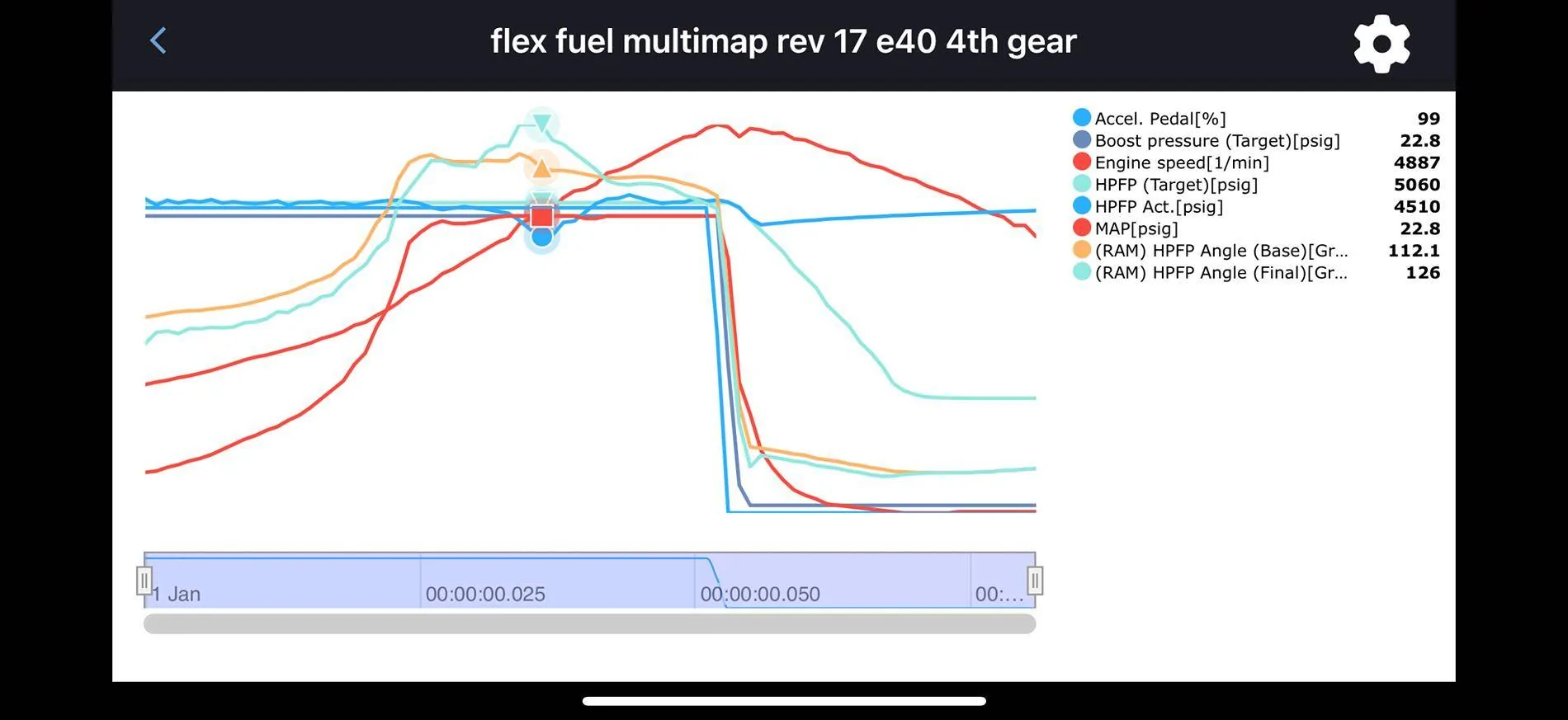

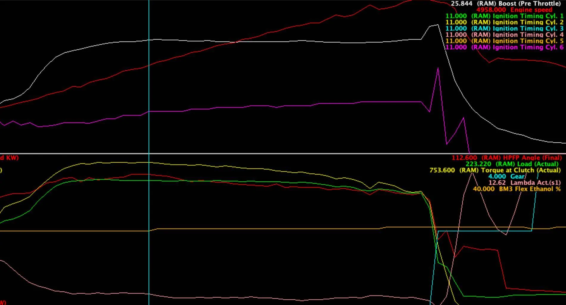

Since I have a HPFP upgrade now I figured I would raise the boost in the low and midrange. Since I can now without maxing out the HPFP like I would with the OEM HPFP.
25-26 flat across made it a torque beast. Any undulations in the surface and the tires spin slightly, as you can see in the RPM plot.
The car was like this as I slightly puckered:
We'll see if I can manage this on track.

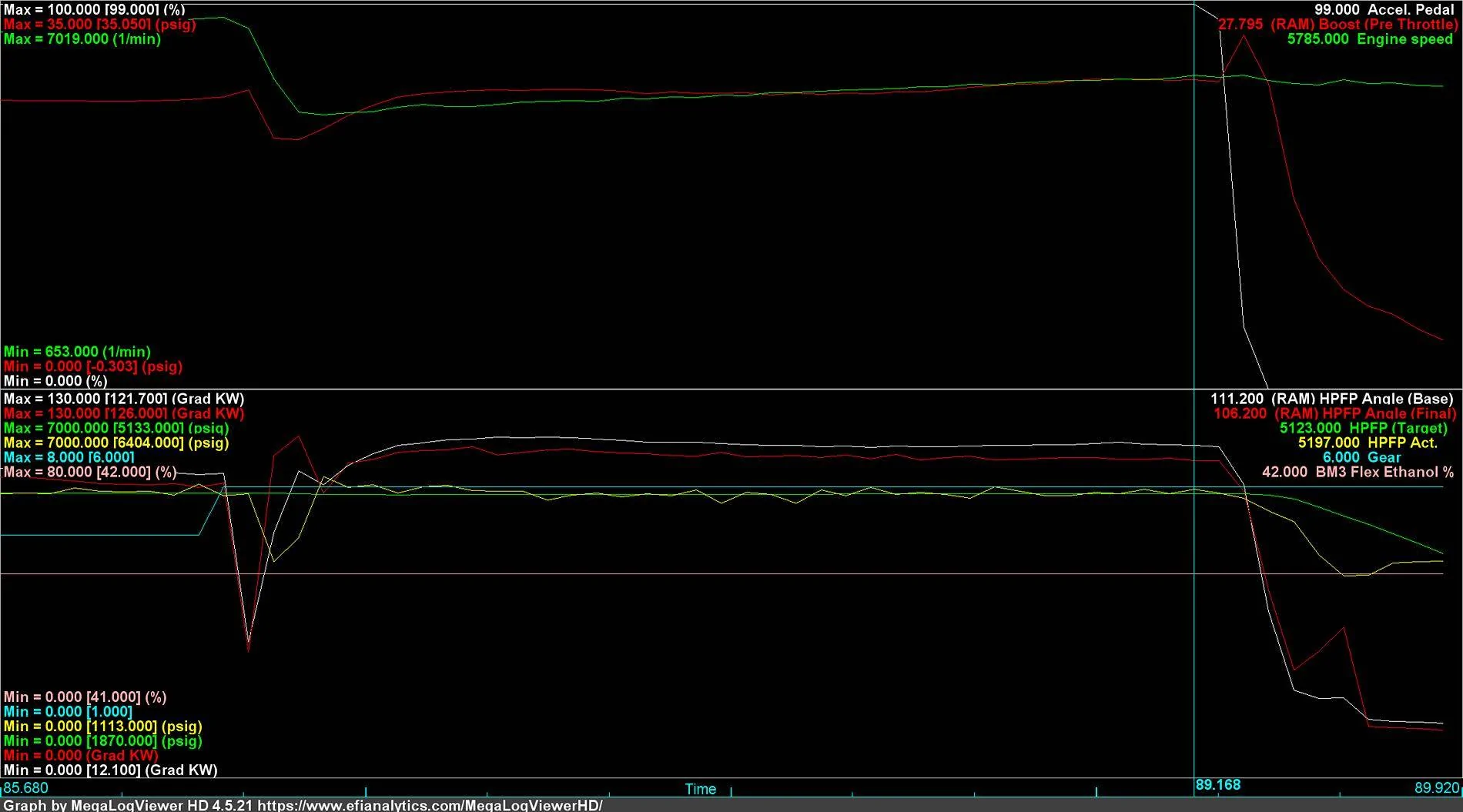

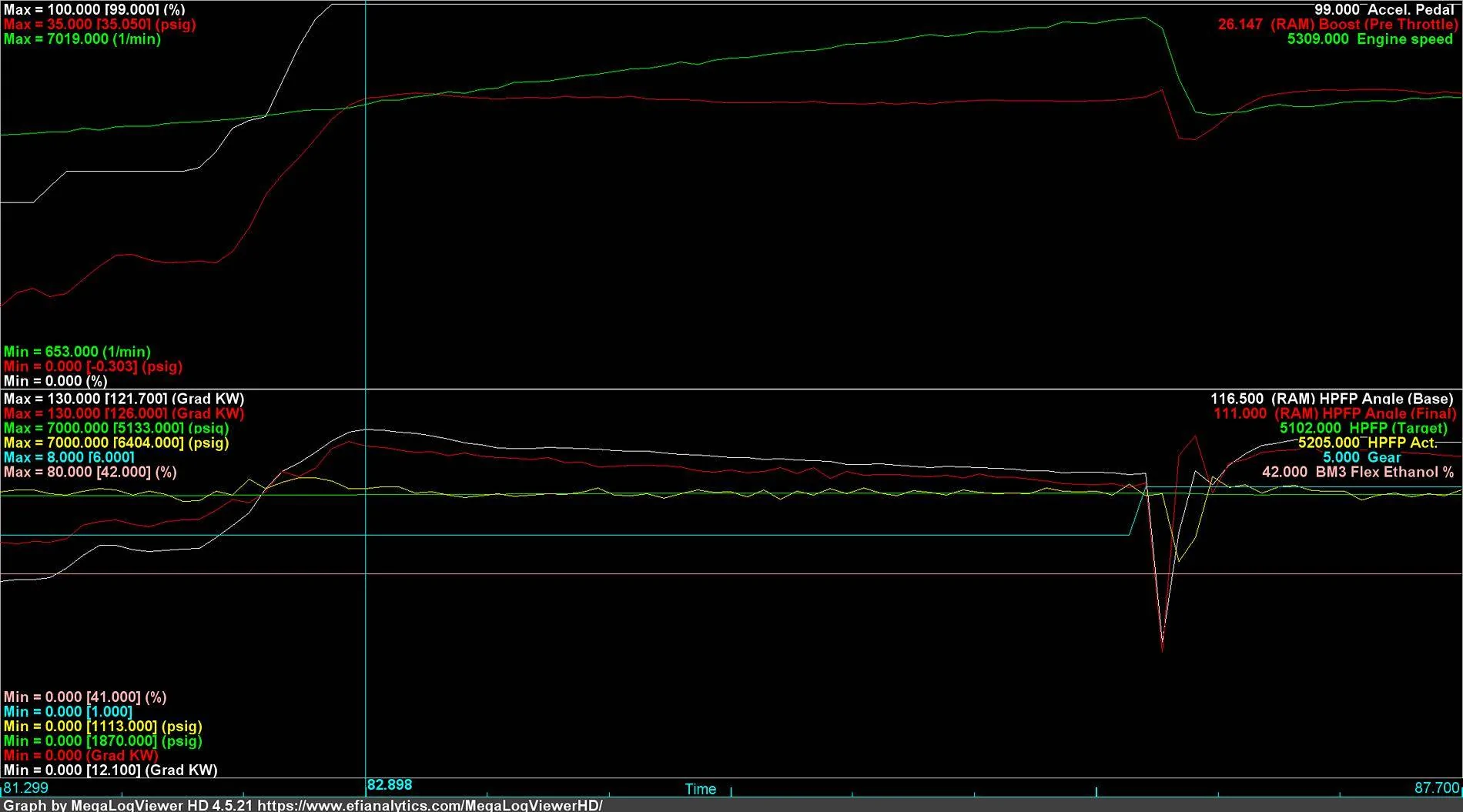

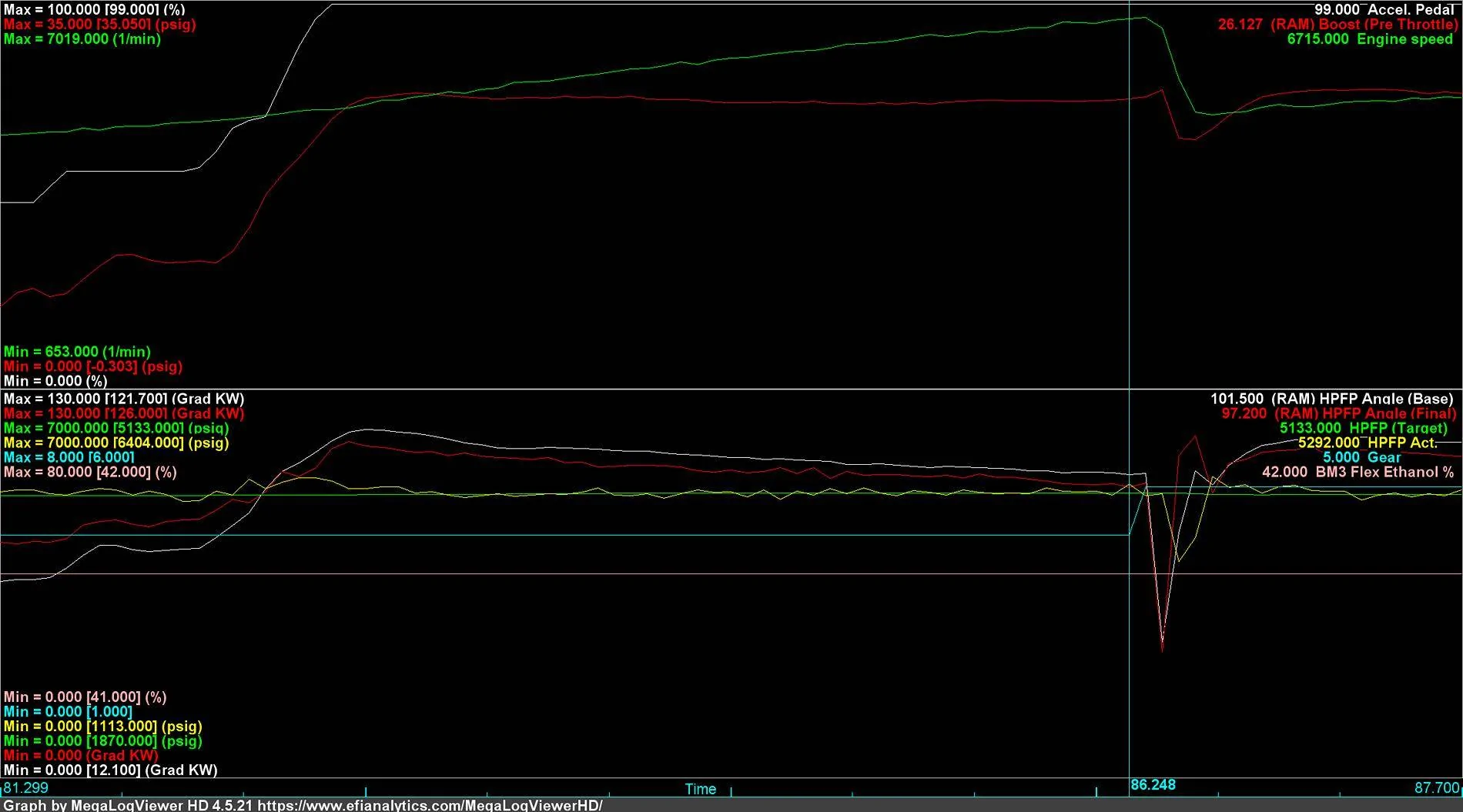

The main reason I am running higher ethanol level (E40 instead of E30) is for higher knock resistance to keep the car more consistent on track if I decide to stay out all session or go to a track day in summer with a higher ambient temp. To note is that I always try to run more timing than less to keep EGT's in check under track use. Obviously I keep the timing within reason to help keep things consistent and safe. I run about 14-14.5* ignition timing out the top of the rev range. Keep in mind I have a higher compression 2020 2-port engine.
I could have went down to E20-E30 with the OEM HPFP but I decided not to because of the above.
So when I wanted to explore some more midrange power I decided to upgrade the HPFP so I could keep the same level of Ethanol.
For reference, here is my current boost level I used at the track even this last Monday. I also played around with gear based boost this event so there is more boost in 6th gear. You can see that the upgraded HPFP supports a good amount more boost at E40, with a good amount of HPFP angle head room.
A keen eye will also notice that I am testing out a slight rail pressure bump.
