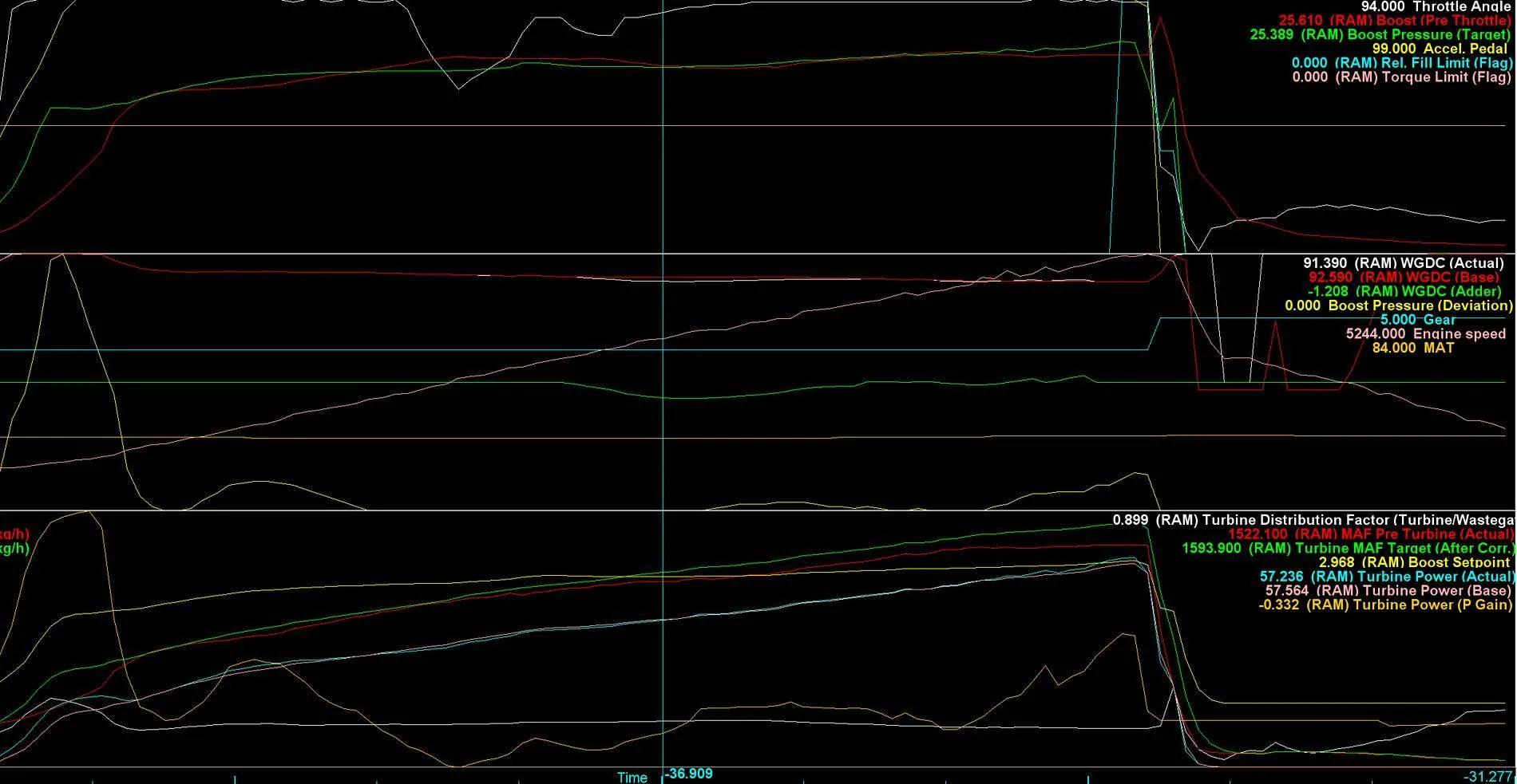

Things are getting spicy end of the season but I think it's time for a larger turbo because I am running the Pure700 pretty hard at +90 WGDC. I have to say though, it has been a trooper, two track seasons being run hard, 50+ track days and taking it all.
The peeps that are curious (love you!) will see that the Compressor turbine power is so close in this log. Will update the self tuning thread soon!

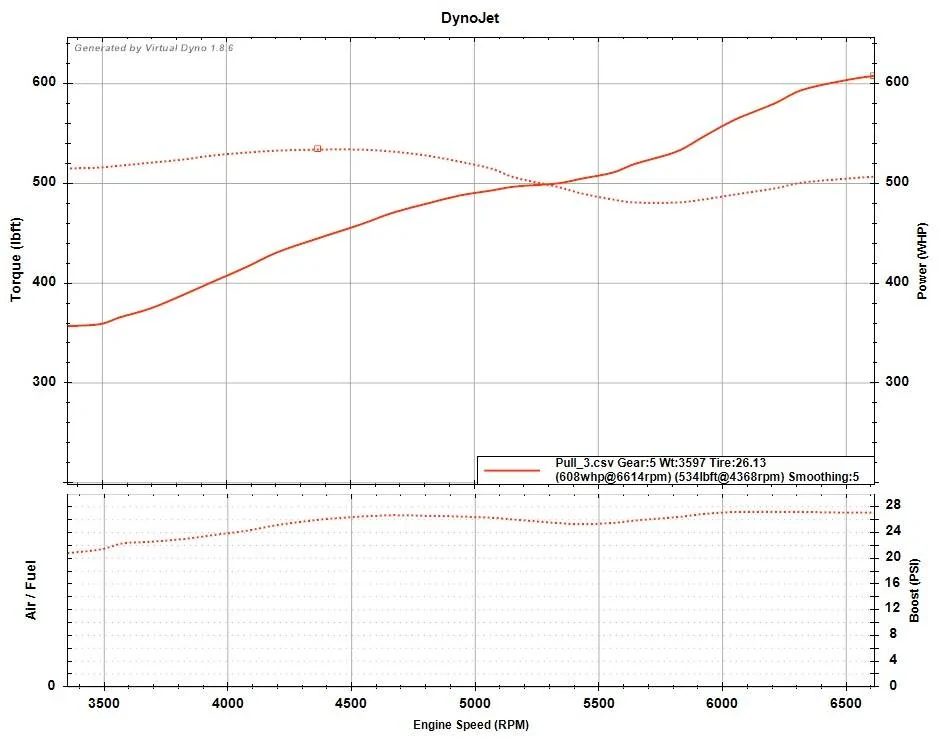

If anyone is curious, I pretty much maxed out my stock injectors with:
Pure700
Dorch HPFP
E40-E43
Out of injector window at around 27-28psi 6500rpm+

I just realized that you have the Dorch HPFP. Would love to hear if you go S58 injectors and which turbo you move on to and the results. I'm getting the injectors and HPFP soon but have been doing circles on which damn turbo to get with all the seperate issues.

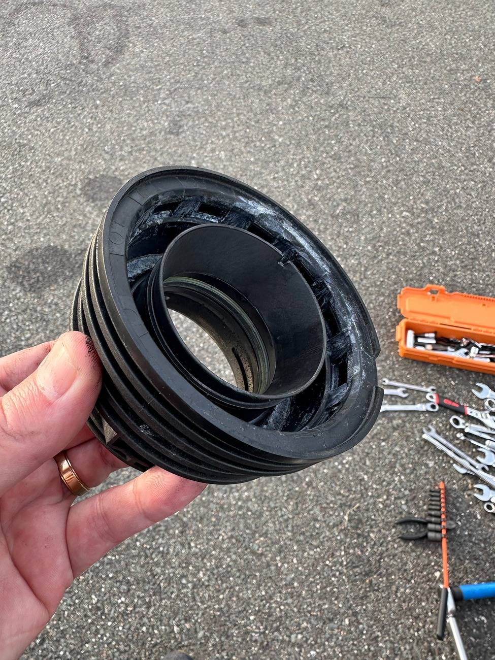

OEM charge pipe decided to leave the chat at the track today. Good thing it was the last session of my last event of the year. Luckily I was able to limp the car home.
You should talk to the installer! JK, that’s amazing you’re able to get so much power out of her and keep it running on track. Can’t wait to see how she does next year ??

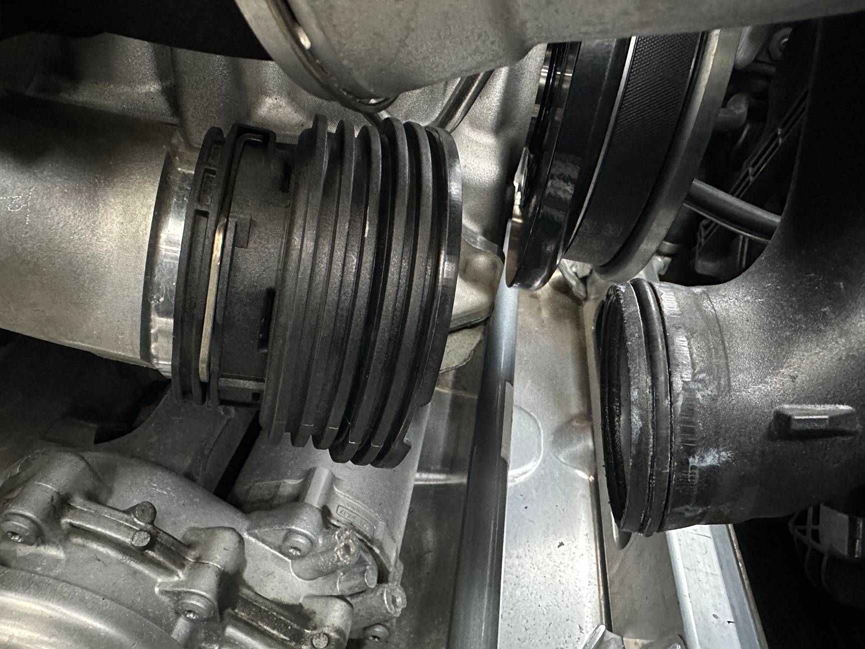

Installed a do88 charge pipe to replace my blown apart OEM one.
I give the do88 charge pipe a 9/10 on fitment, 9/10 on finish and 8/10 on QC. There were some metal shavings and some bits of metal hanging off the tapped threads inside that I had to do a quick file pass on so there would be no possibility of ingestion.
Looks great!
What are your feelings on the VTT silicone charge pipe?
