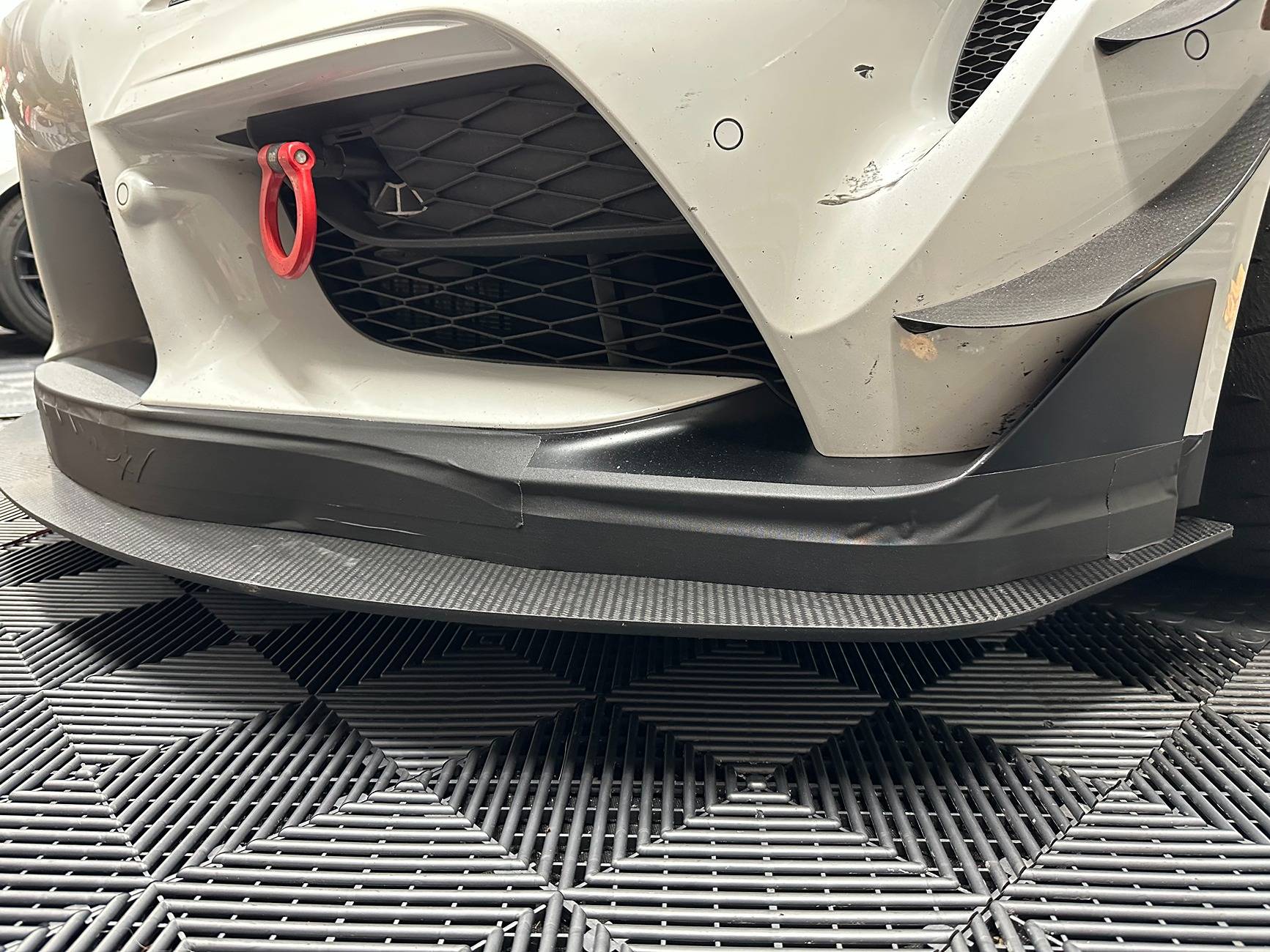

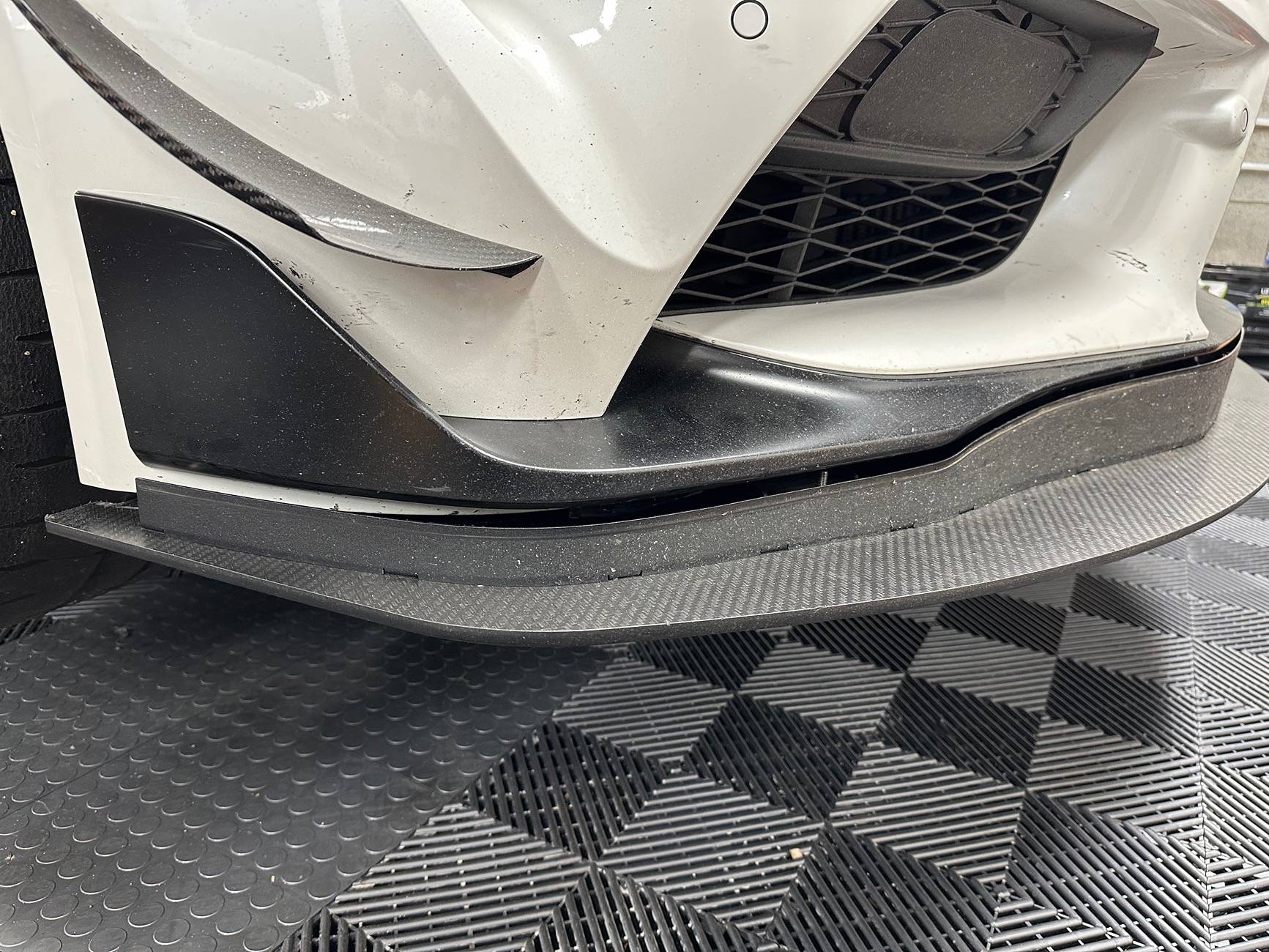

Trying to get this splitter to actually work by lowering it a bit. We’ll see…
I let go fixing verus splitter (i thought about adding tunnels, lowering etc), i will just move straight to AJH tunneled one instead.
Wonder if there will be a difference felt, if U need to add wing angle etc

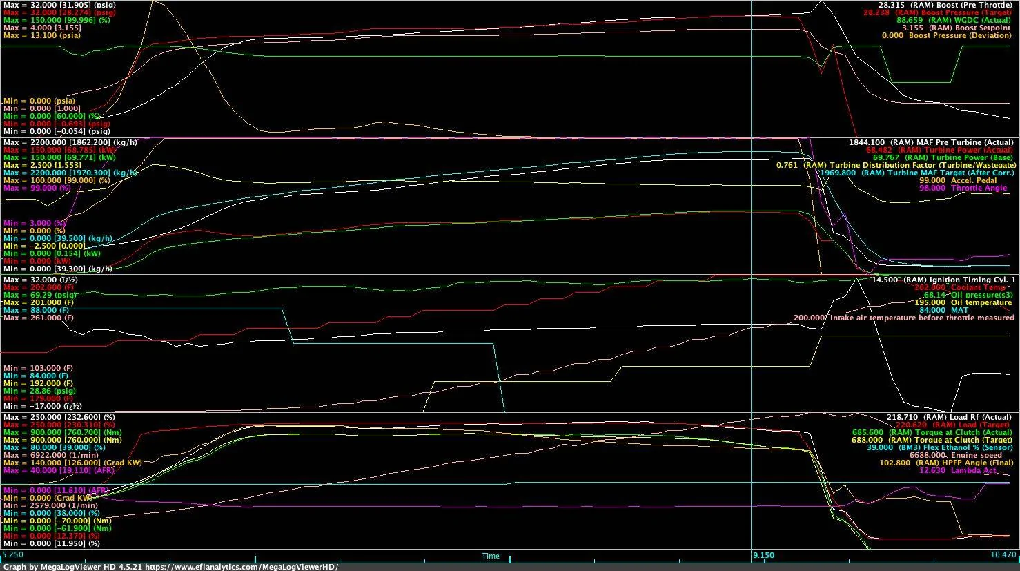

Finished the S58 injectors install, bled the hi-temp coolant system from the Pure800 install and started it for the first time since the Pure 700 blew up.
I also added race tape to my lowered splitter to finish off the gap. The tape should be good for at least 2 seconds a lap.
Was raining today so I'll take it out tomorrow.

Was going to ask you about the gap when i saw the earlier pic. I've never used race tape, and didn't even know that it could be used to cover those kinds of gaps.
8,772
17,214
It's actually gaffers tape.

Getting the Pure800 and S58 injectors dialed in...
vDyno shows over 600 hrsprs but I'm not going to post that because we all know how dyno posts go.

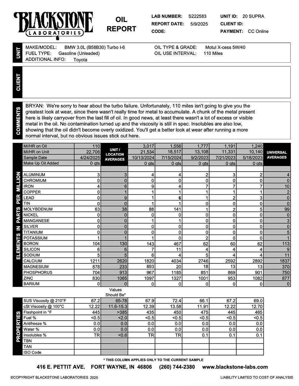

Oil report came back on the oil that was in the car at the time of my turbo failure:
