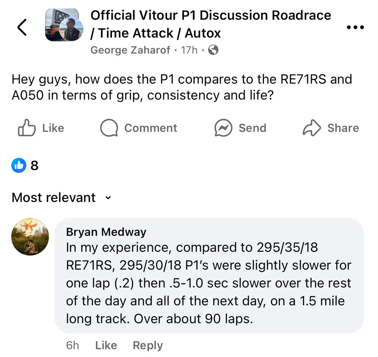

Another reason for me to move back to RE71RS and leave the P1’s behind…
Someone asked this question on the Vitour P1 FB group, I answered with my personal experience and data. Then my comment was deleted and I was blocked from posting on the group. I noticed a bunch of other people’s posts that were the same type were also deleted. Basically, any comment not inflating the tires as faster than other tires is forbidden.

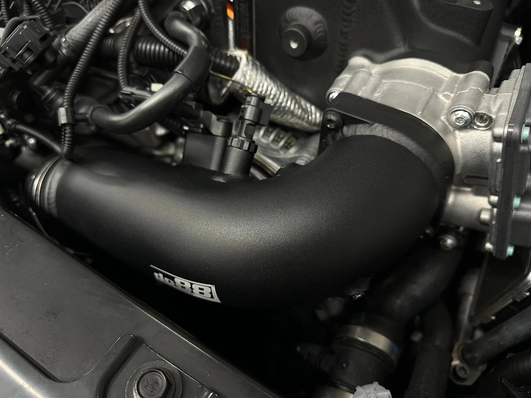

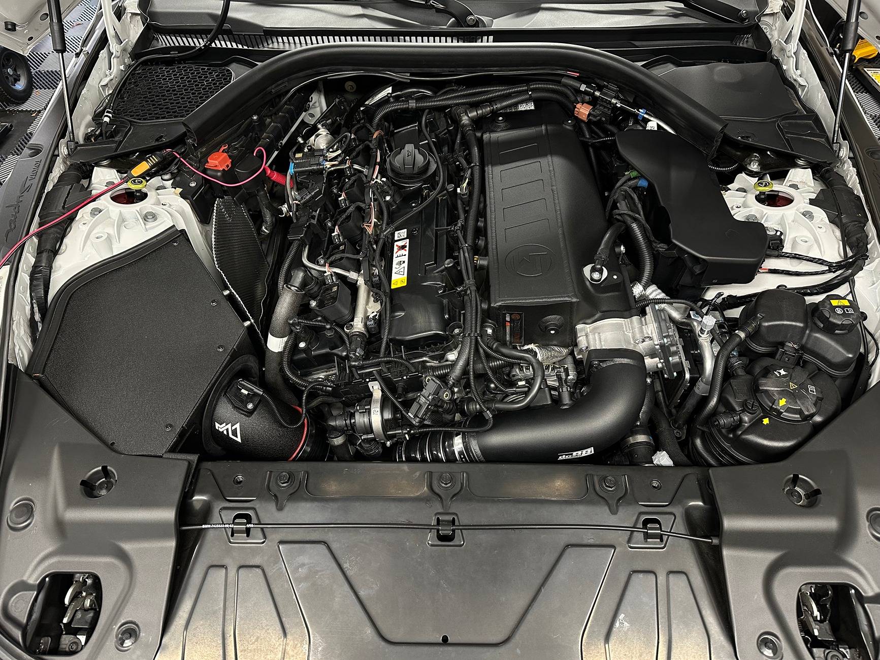

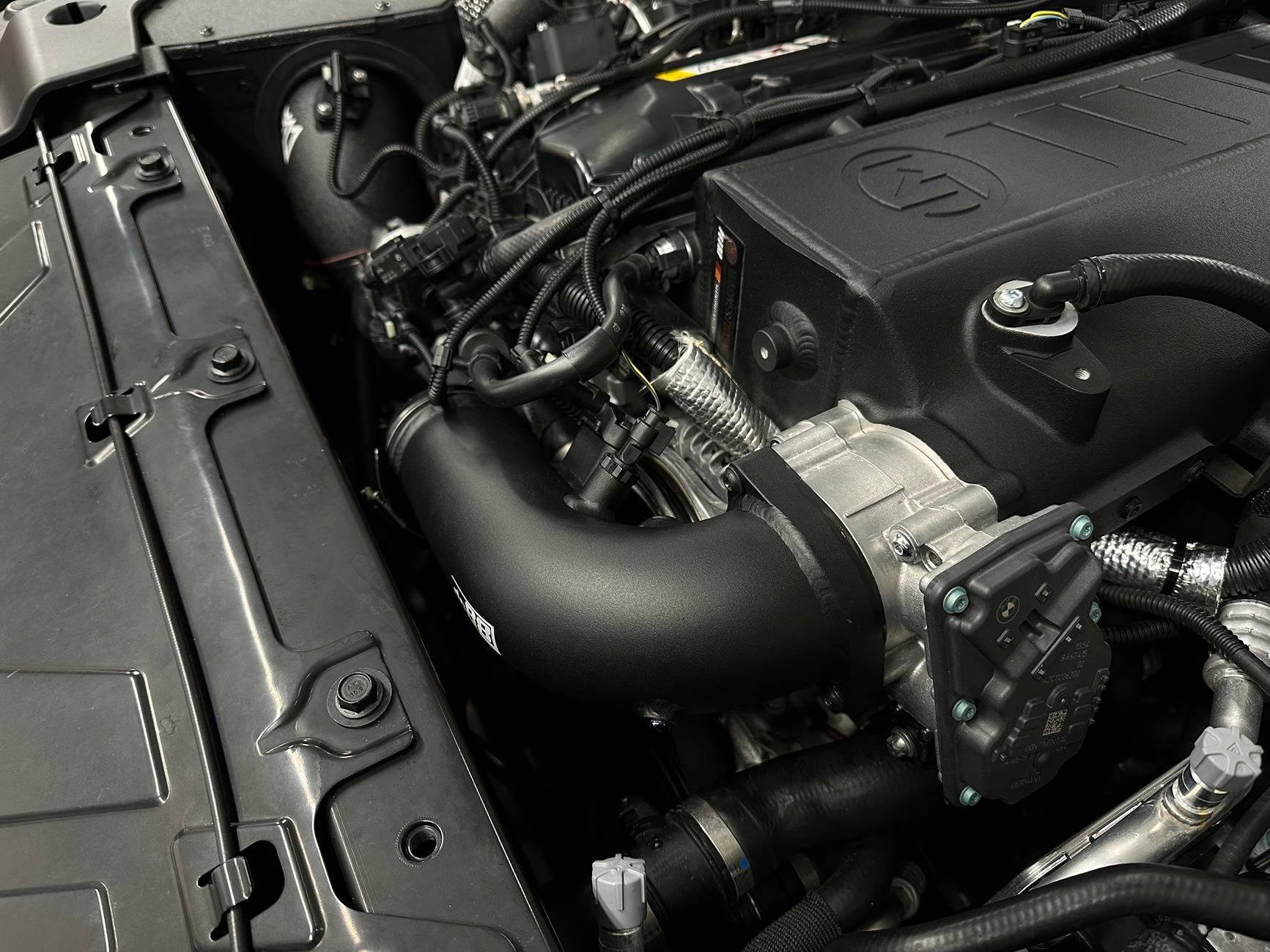

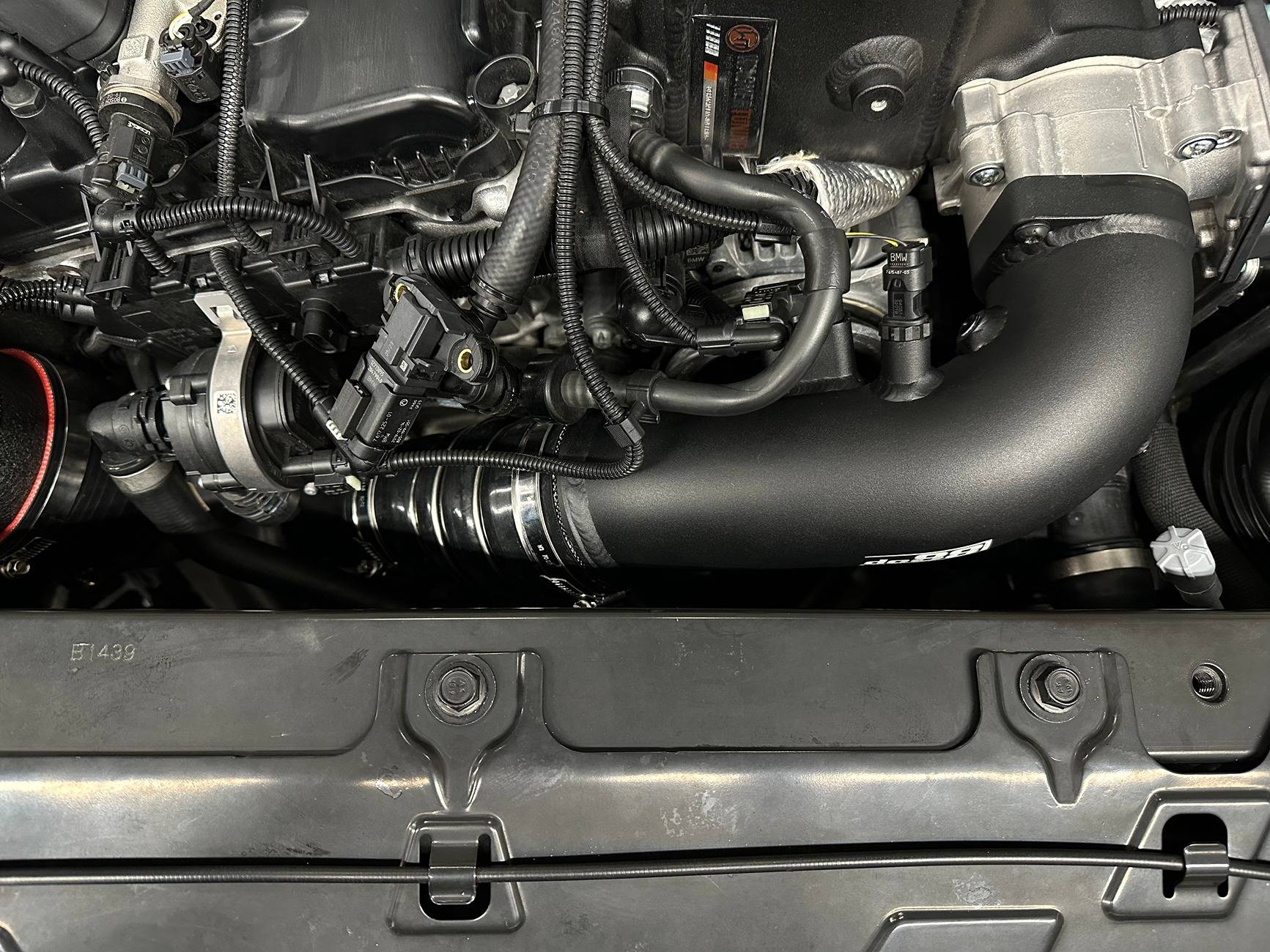

Installed a do88 charge pipe to replace my blown apart OEM one.
I give the do88 charge pipe a 9/10 on fitment, 9/10 on finish and 8/10 on QC. There were some metal shavings and some bits of metal hanging off the tapped threads inside that I had to do a quick file pass on so there would be no possibility of ingestion.
for the do88 charge pipe, do you have a gap between the silicone coupler and the base of the flange (both/either sides)? Mine seems to have issues.
You have to finagle it a bit more. Either way, as long as the actual clamp is behind the lip, you are fine, even if the coupler isn't butted up all the way to the flange.

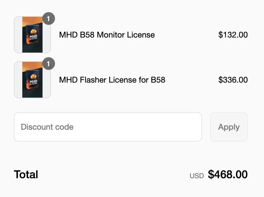

Well over a year waiting for Bootmod3 Rev2, with nothing for the B58 yet. Not to mention a mobile logging app that is a mystery if it will even work every time I open it...
Time to move on and try something else.

Yeah, I'm really wishing I had gone with MHD right now. Unfortunately I would have to send my ECU back to Finland again. Definitely curious on your experience when you have switched.
Will you be self tuning again?

Same. I'm lucky enough that Femto pass by my city every 2 or 3 months, but it's still a hassle (and cost) I'd like to avoid.

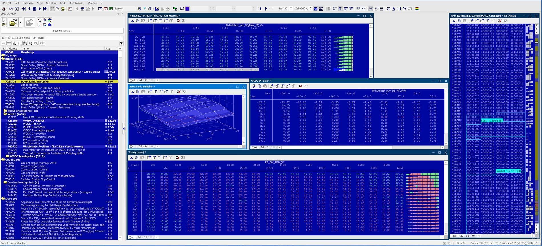

When you think you finally found the full map pack definitions for WinOLS for your ROM ID, pay to download it, then open it and it's just the normal MHD definitions converted to a WinOLS map pack.

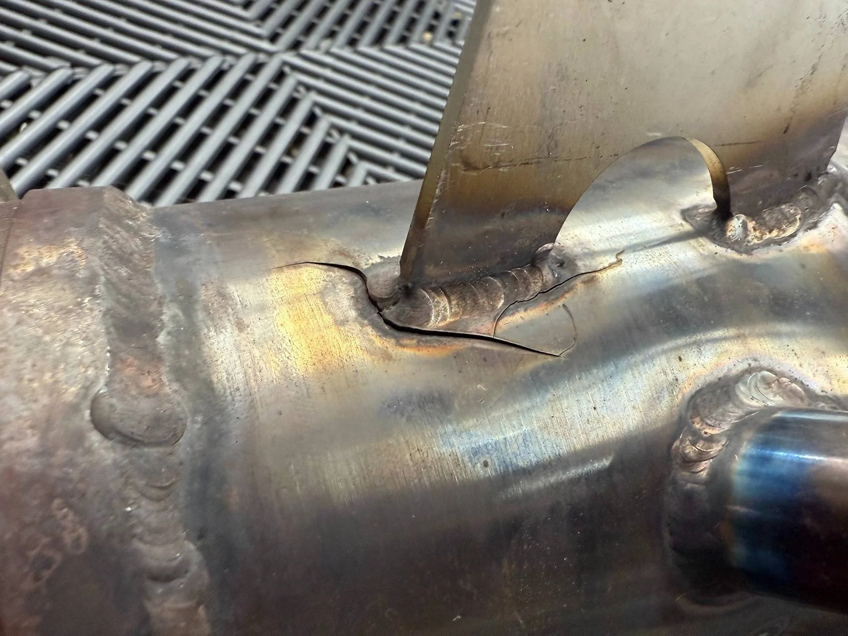

Found out why my Supra started to get a little stinky...
So I swapped a catless DP on and now it's even more stinky and sounds raspy raspy crappy crappy. Time to shop for a new GESI catted DP.
