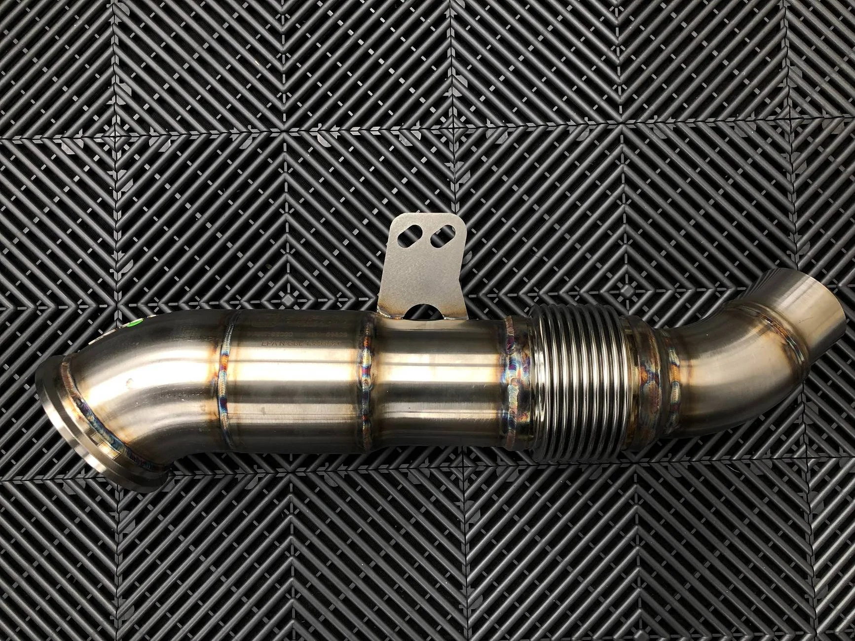

Yes that is basically what I had this whole time, but made by MAP. Same GESI cat though.
I might just bring it to a welder and see if we can fix the cracks.
Back when it was new:
I was actually going to suggest welding it. Small cracks like that are easily fixed, and you could even add some gusseting to the bracket that gives better support to the whole area. I only weld as a hobby, but that type of crack isn't uncommon in thin wall exhaust that gets really hot. Cracking at the end of the weld usually means the initial weld made thin spots at the edge of the puddle then wasn't annealed properly. Over time with a ton of heat cycles and vibration they tend to crack, but are easily fixed by someone with a TIG and 20ish minutes of thought/prep.
The issue with the original pipe cracking is the positioning of the bracket on the pipe. If you butt weld a bracket onto a tube like that it's not a question of if it will fail but when. Poor bracket positioning/design i'm afraid.
