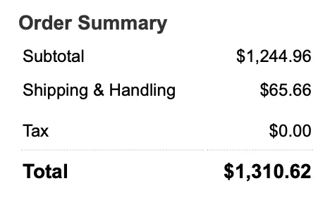

Going to be a busy winter for me. Decided to be proactive and replace the oil pump with the ZTK version. Decided to finally build the trans. Replacing both guibos and whatever else I find that is causing the vibrations. Decided to finally install the rollbar that has been sitting in my basement for 2 years.
First round of oil pump, parts, Guibos, motor mounts. This is with about 30% off everything. Still better than letting some rando that gives zero F's at some dirty dealer touch the car.

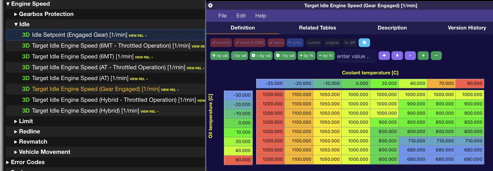

What’re you doing for motor mounts? I did the power flex inserts while the oil pump was done- really happy overall but I should have trimmed the top portion as it does vibrate a little at idle. Tuner raised it, but in gear the rpm’s drop back down.
8,823
17,306
There are in-gear idle tables too. Tell them to tweak those too.
I'll be putting in fresh OEM engine mounts and half the powerflex inserts.

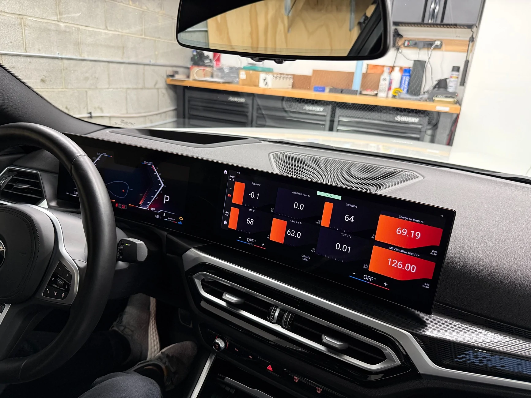

A lot more screen on iDrive8. For better or worse. Might be part of it, or just being the newer version itself.

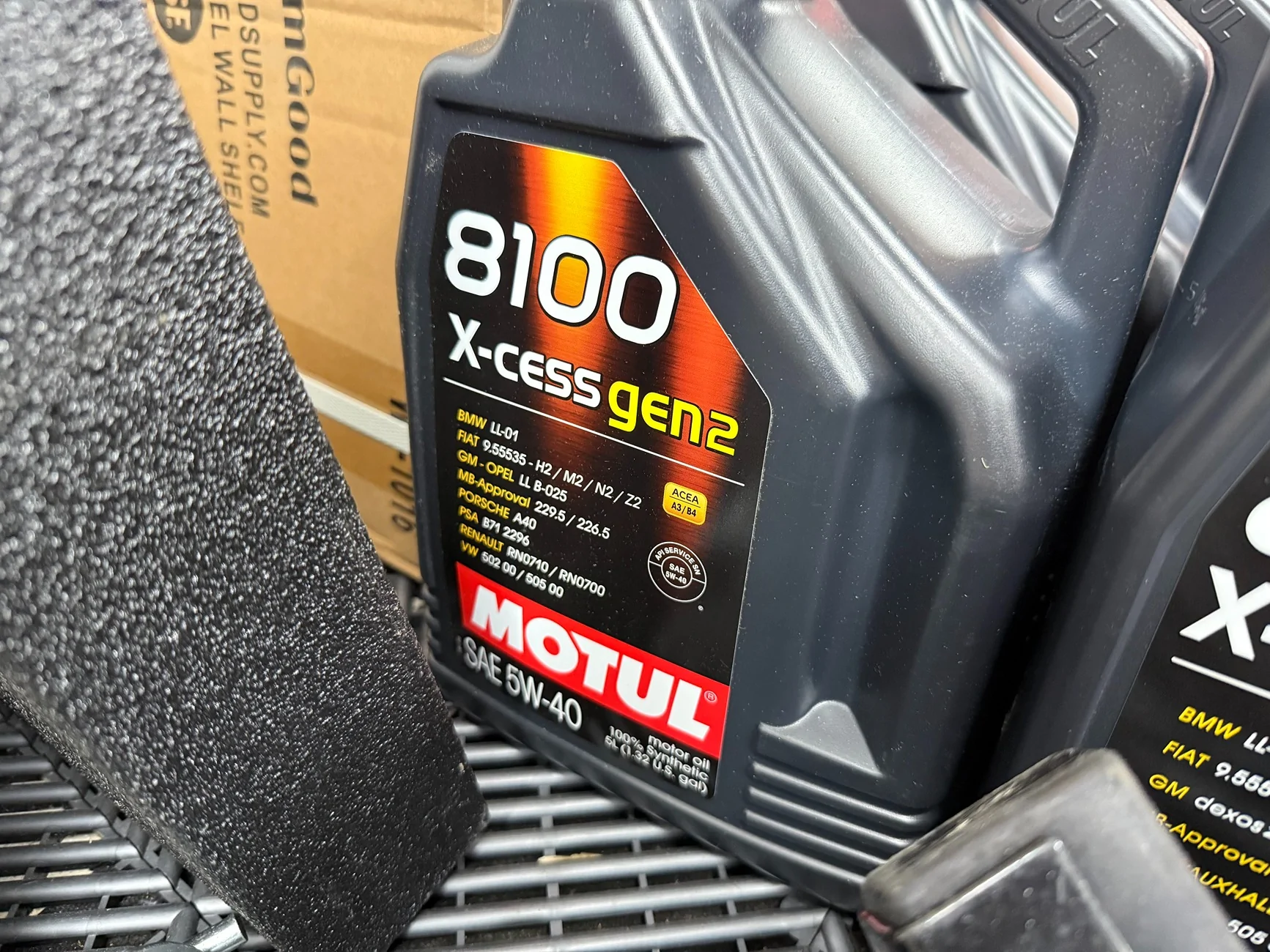

Not a Supra update, but I did get some oil delivered for my M240i...
5w40 that is literally written as approved BMW oil for the B58 but @concept will deny it to the day he leaves this mortal coil because he saw some youtube influencer videos that echo chamber his narrative.
It's going in my street car that still has a warranty @concept! OH THE HORROR!!!

I haven't tracked nearly as much as you have in this car but have been using this same oil since 3K miles. Have done Blackstone analysis twice in the past two years and everything is normal. Just throwing this out there for those coming across more oil talk
