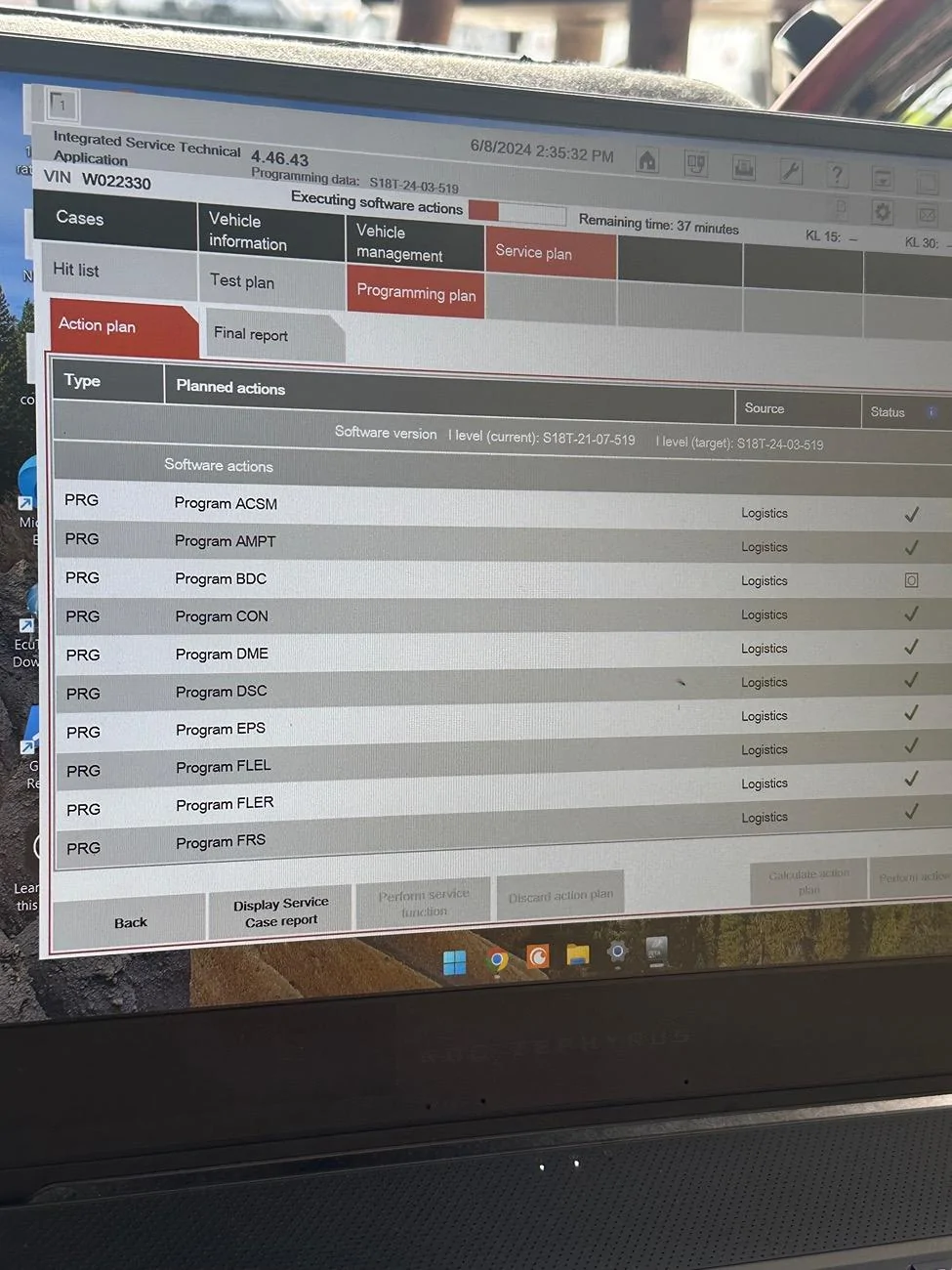

Yes I just had mine done yesterday at dealer and S18T-24-03-519 was installed (just checked my profile export).
So far I have noticed on my 2020 Premium 3.0 Auto:
Trans shifting seems smoother. Also the rev hang when shifting manually near redline is mostly gone. If you click a paddle while in Auto gate it will now upshift on its own at redline which is good and bad I guess. Manual gate will still hold gears.
Suspension in Normal seems more supple to me but have to drive more.
Stereo sounds better to me.
Next I will attempt to make all the Bimmercode changes and hopefully I'll still be able to turn start stop off. Will report back.
i’ve already shared all the -519 changes in the iStep thread. Start/Stop memory function doesn’t work
furthermore, i can report my head unit isn’t bricked. not sure what the toyota techs are doing wrong. perhaps not allowing the post-update process to finish. this itself took ~10 mins. to anyone worried about the service bulletin, you can do it yourself!

New version!
Toyota ISTA:
VersionBMW iDriveReleased approximately
4.48.35S18T-24-07-530 (Jul 2024)08/21/2024 (Aug 2024)
Good chance the recent release contains the DCM update as the timeline matches:
ISTA 4.48.35 (S18T-24-07-530)
