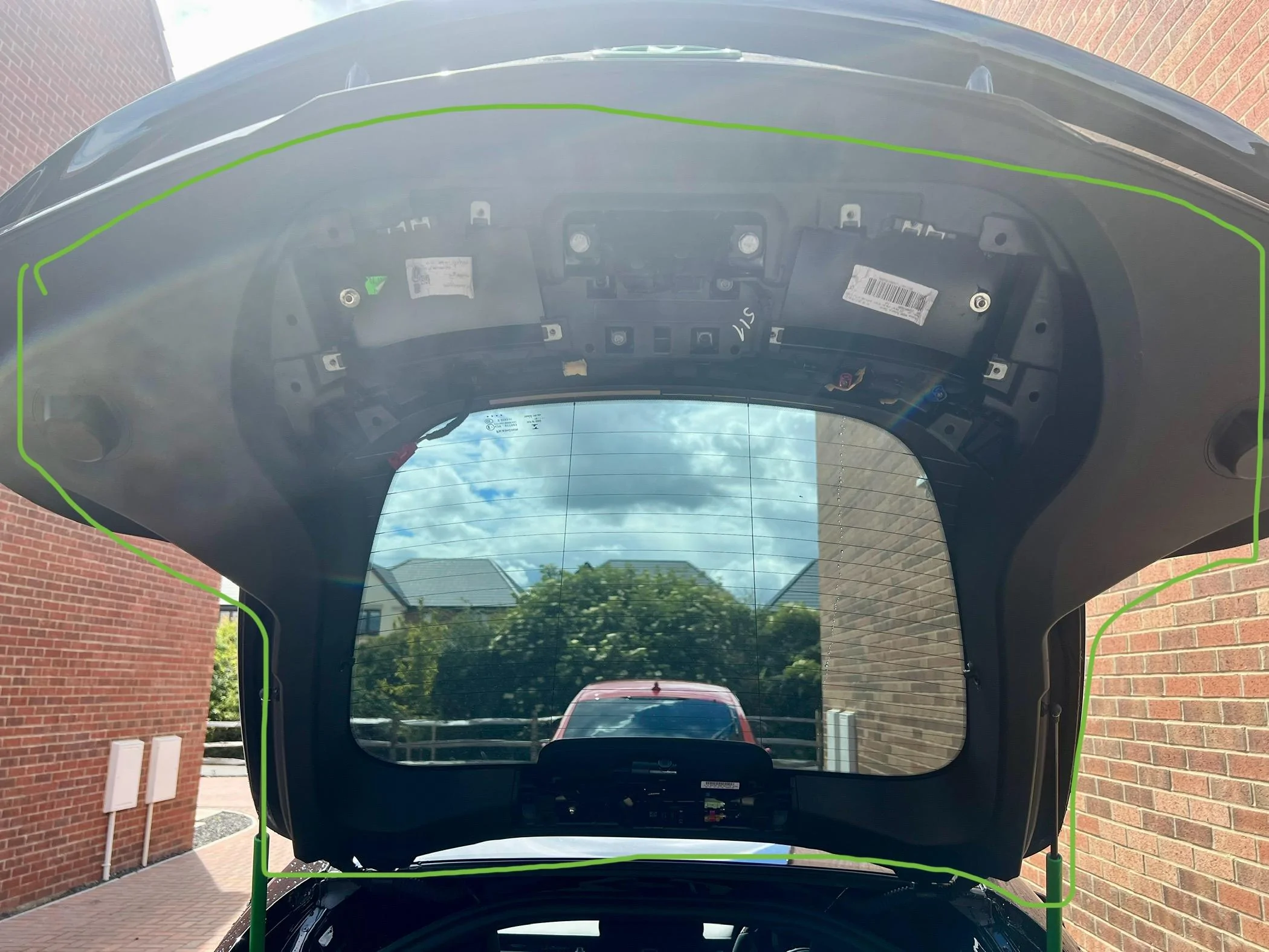

Does anyone know how to get the large piece of trim off the trunk/boot hatch?
I’m pretty sure there’s something rattling around in there, specifically down the left side, but can’t figure out how to get it off.

Did you ever get this figured out? I have a loose screw in there that's rattling and I need to fish out

Wanted to ask about this, how did you take that inside trunk trim off? Was it just held on by clips and you can just remove it with a plastic trim removal tool?

Like in the trunk? Yes, clips and screws.

There’s 2 small grooved plates on either side by the grab handles. They pop out with a trim tool, then there’s a couple of screws to remove and the rest of the trim is held in with clips. Reasonable force is required but as long as you’re consistent with it and don’t just yank at it you should be fine.
