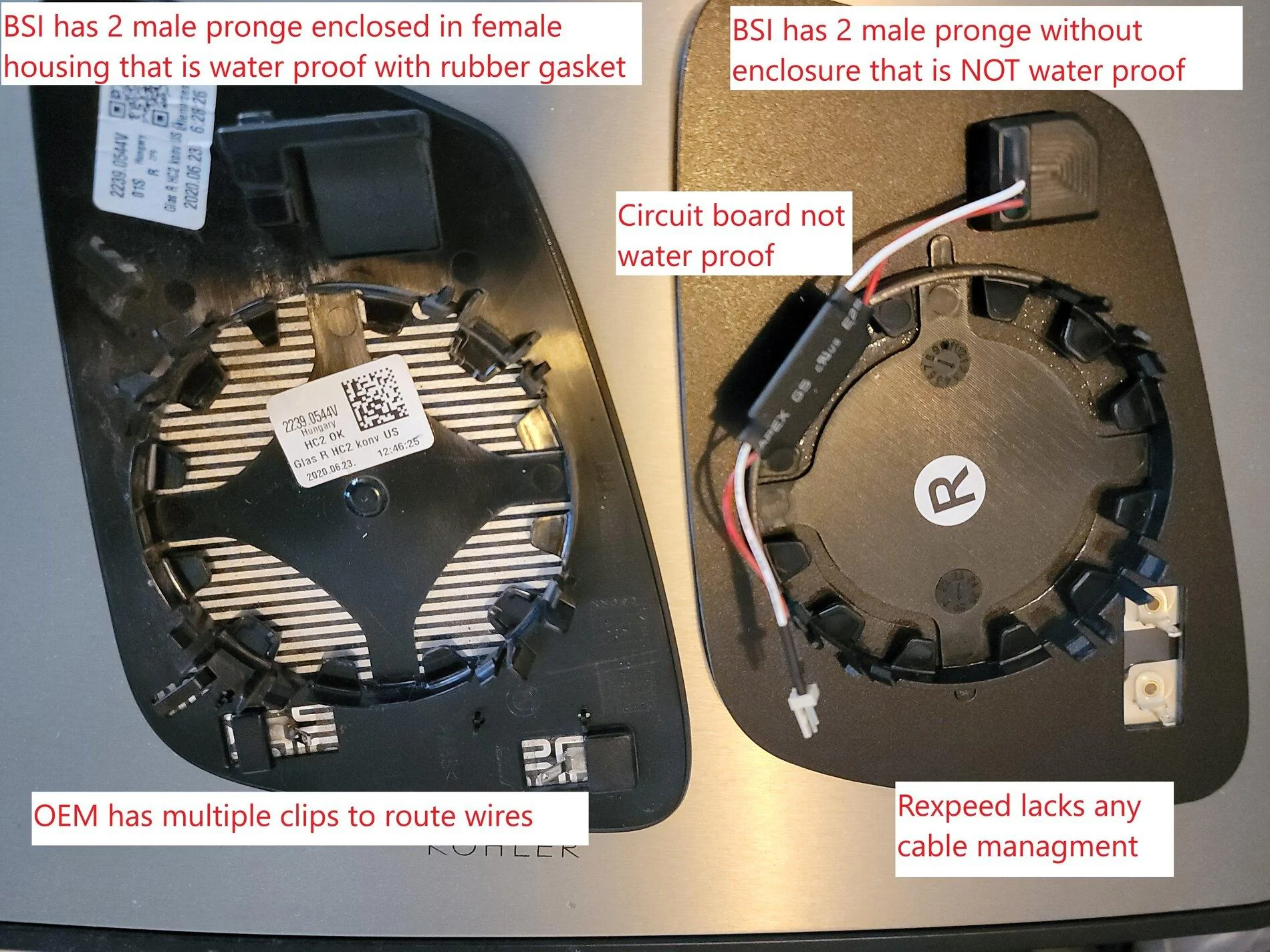

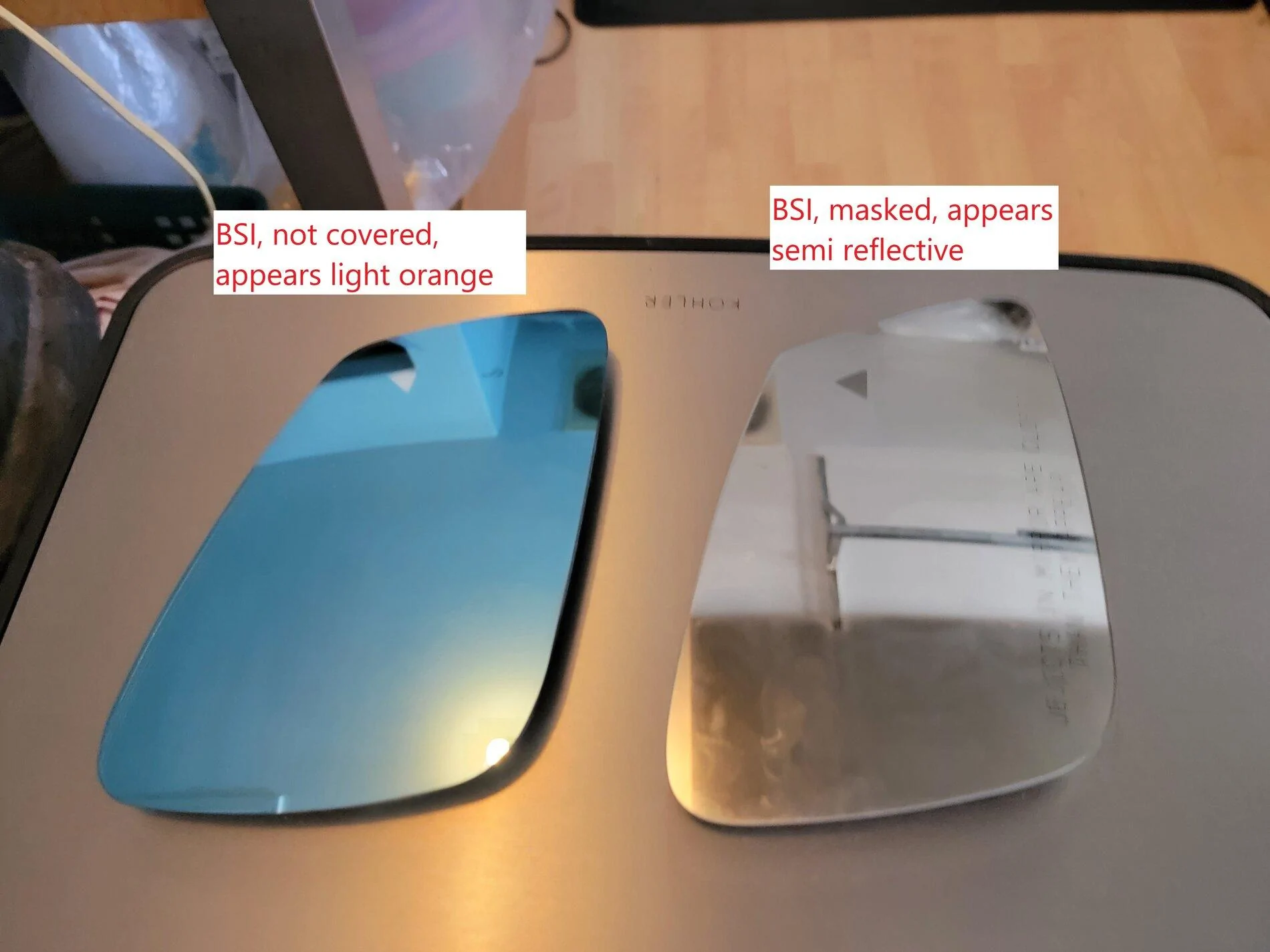

Thoughts: The Rexpeed are not 1:1 oem replacements. The connector are a bit diffenent. Backplate doesn't have cable management standoffs. The front orange triangle BSI is not masked off like OEM (which creates another issue, explain later on)

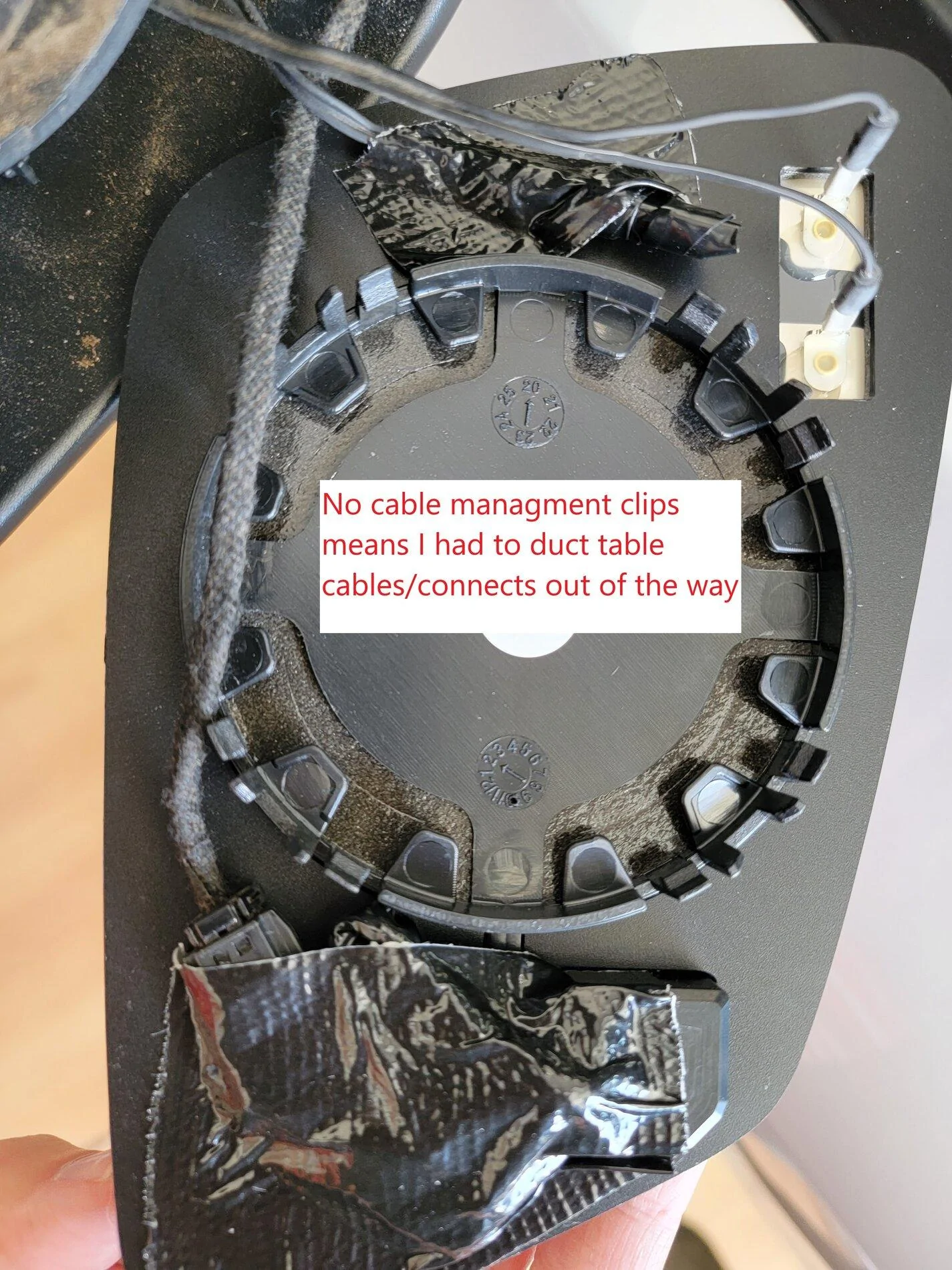

Installation: I would suggest electrical tape all areas in which you don't want water to get into, especially the heatshrinked circuit and the connectors. Will also need to secure the cable/connects so they don't flop behind the mirror. I used duct tape (for now, until I can find a better solution)

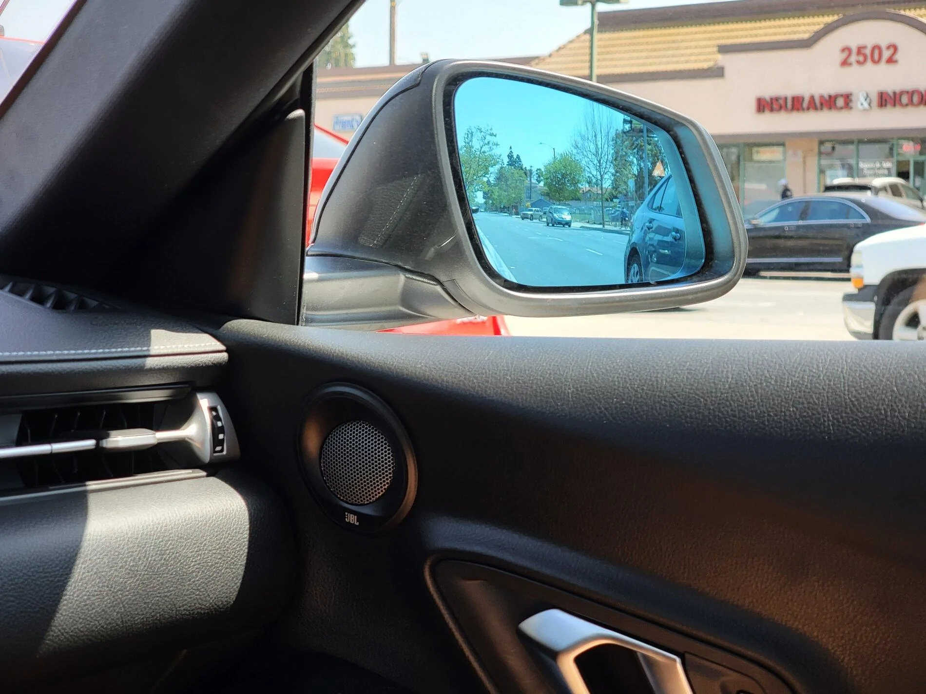

The mirrors are convexed, there is more FOV without too much distortion.

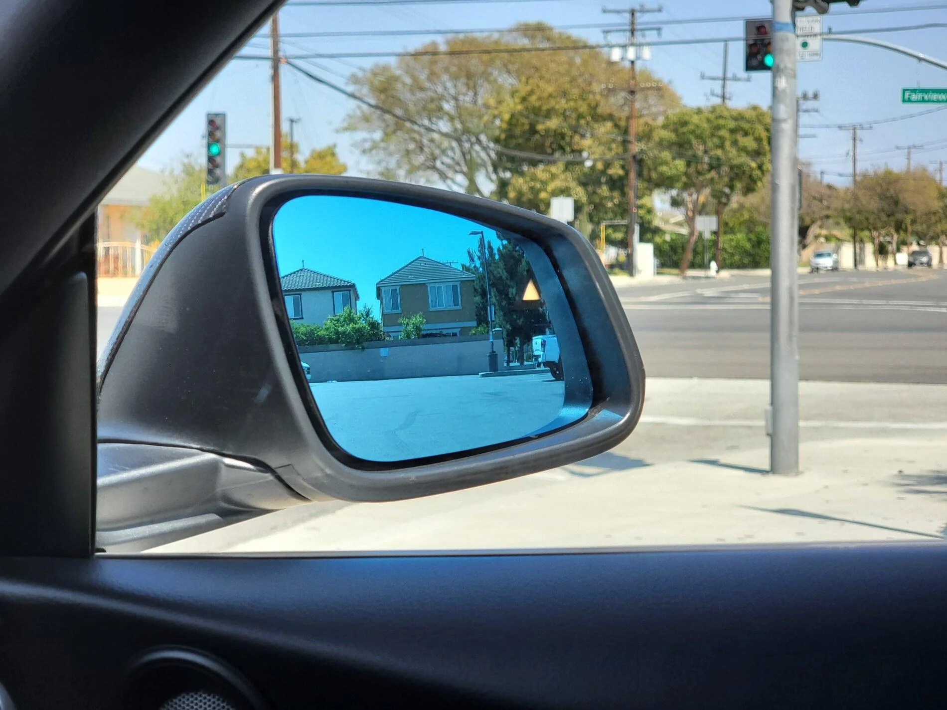

[NO BSI visible]
[BSI if OFF]
Compared to the FRS housing, the mirrors could be adjusted to a wider range of motion. For the driver side, the FRS could adjust further left and further down. On the Supra, the mirror housing is smaller...limiting how far left it can be adjusted. This is not a big deal if you have nothing to compare it to.

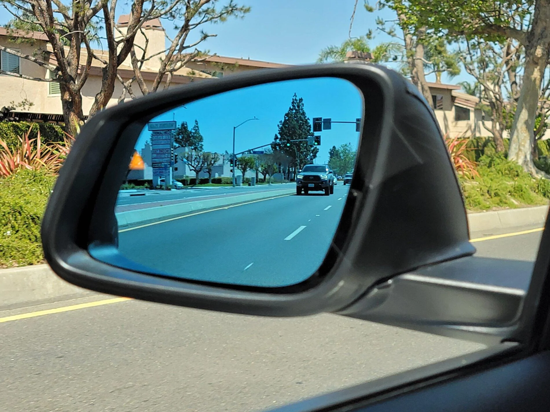

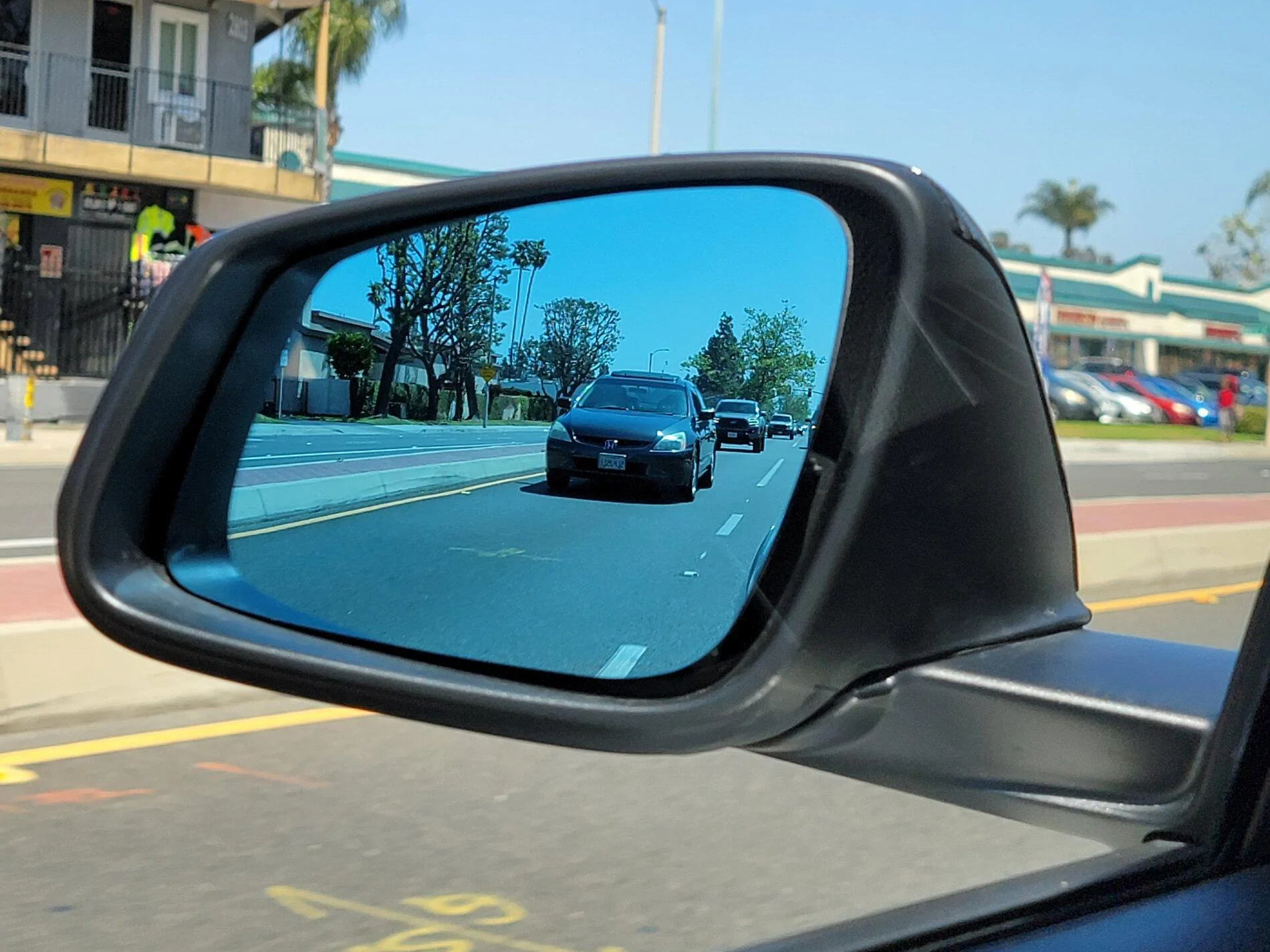

MAIN ISSUE- That I have is the UNMASKED orange triangle BSI. When driving with the sun behind you. IT IS VERY DIFFICUT to be sure if the BSI is actually ON, or if the ambient light is shining on it , making it appear ON even when it is NOT.
[This is OFF] - (on OEM, this would be ON)
[This is ON]
[This is ON]
[This if OFF]
Suggestion - Mask off the triangle like OEM does. Or have white/clear triangle material that will glow Orange when activated.

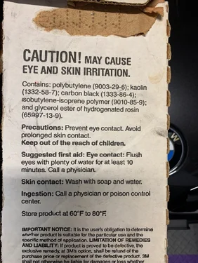

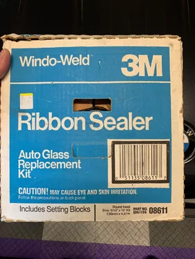

Here's the stuff I use - 3M Windo-Weld. Keep in mind it is literally 30 years old so not sure if the formula changed but it still works great. I use it to keep the emblems on my Nissan center caps which I swap from a chrome to silver cap to align with my wheel swaps.
I've used it for tons of other stuff and it keeps it stick throughout all the elements and water. Not the stuff you want to have to remove though!
Note, don't get any under your fingernails unless you are ok with it there for a week with scrubbing :)

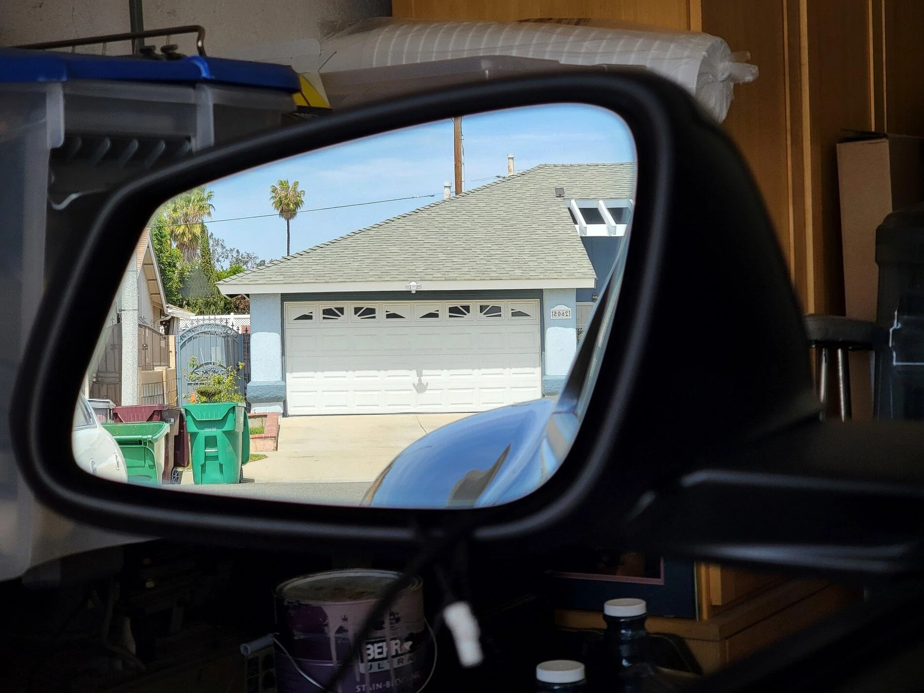

Question: What are the dotted lines on the mirror?
H2O_Doc
Paul
Dec 19, 2020
625
1,053
Virginia
M240i, Wrangler, MB GLA 250
Thanks for the info. I cannot see sh!t out of this car. Will have to see if the g/f agrees as it's hers.
I think they just mark where the transition is to the most convex portion of the mirror is.
