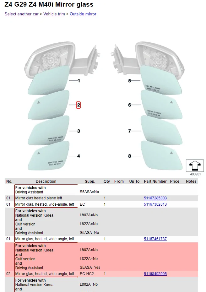

Tracked down some part numbers (I think) for the G29 Z4 spec wide-angle, heated, blind spot monitoring mirrors:
Left Side: 51-16-8-492-905
Right Side: 51-16-9-479-192
Here's part numbers for the auto-dimming versions (not sure if these versions have blind-spot monitoring, but they are wide-angle and heated):
Left Side: 51-16-7-461-792
Right Side: 51-16-7-461-788
Try also searching these model numbers without dashes.

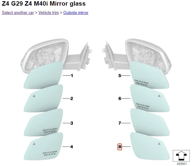

Here's where I got the part numbers if people want to track down different versions (non-BSM, non-heated, etc):
https://www.schmiedmann.com/en/bmw-z4g29/side-view-mirror-glass-pg644-catn-ol

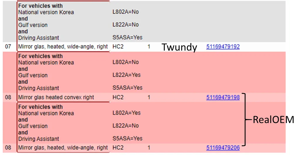

Reviving this thread. Some more info as it seems the Z4 Euro spec mirrors are the way to go for better blind spot viewing.
realoem.com
Now the part numbers differ from Twundy's post and googling them isn't much help either as some site's post images of mirror without the BSM triangle. The left/driver side (51168492913) doesn't show as convex as the passenger side does, (51167461792). Would like to see if someone can confirm.
Correlates with Twundy's post.
51168492905 - Driver's Side
51169479192 - Passenger Side

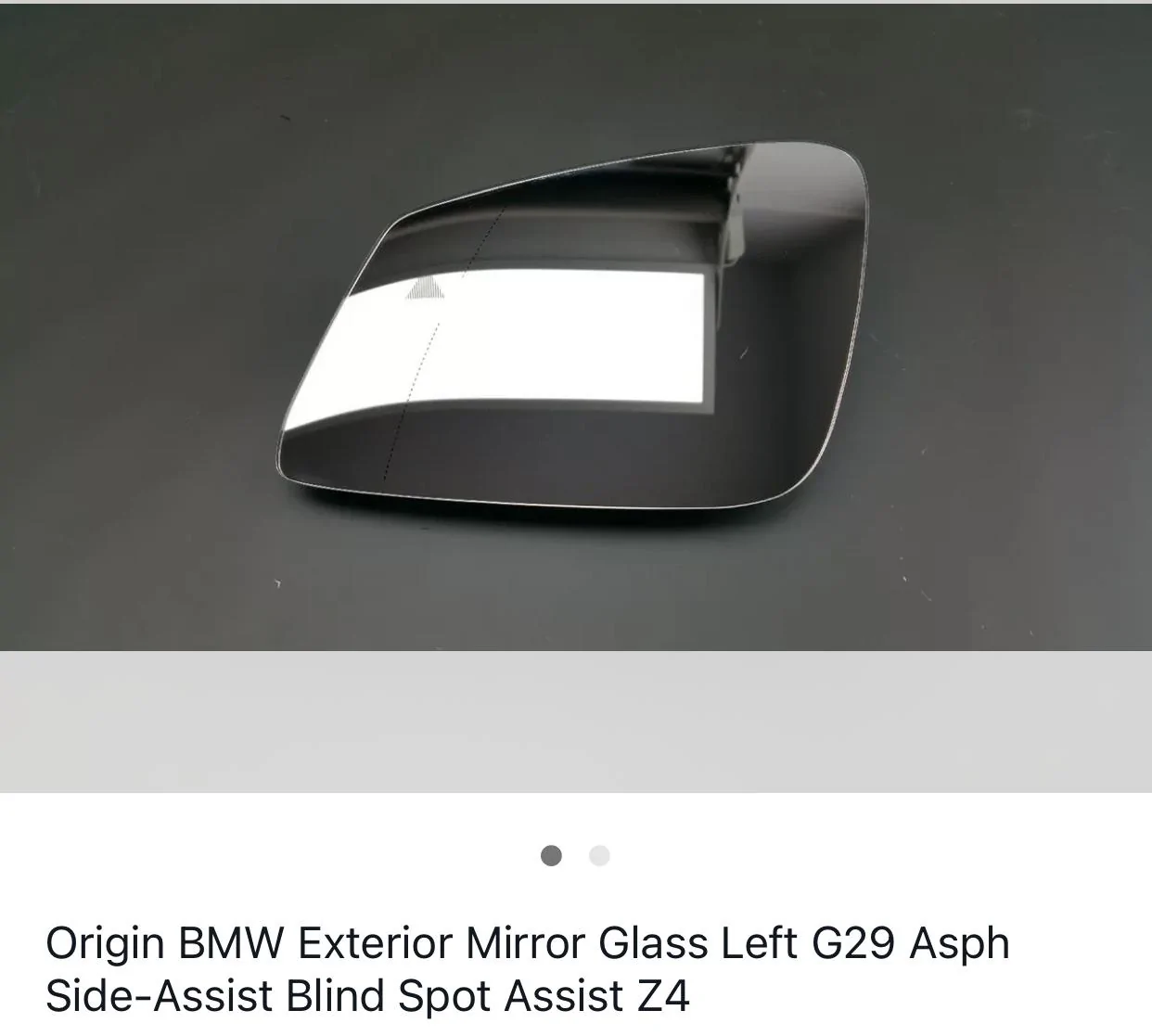

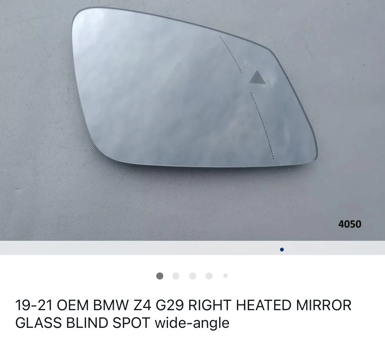

I found the driver's side on eBay, ships from the UK.
I haven't found the passenger side... other than eBay but ships from Latvia...
